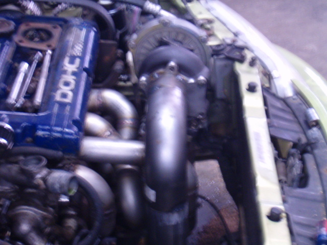

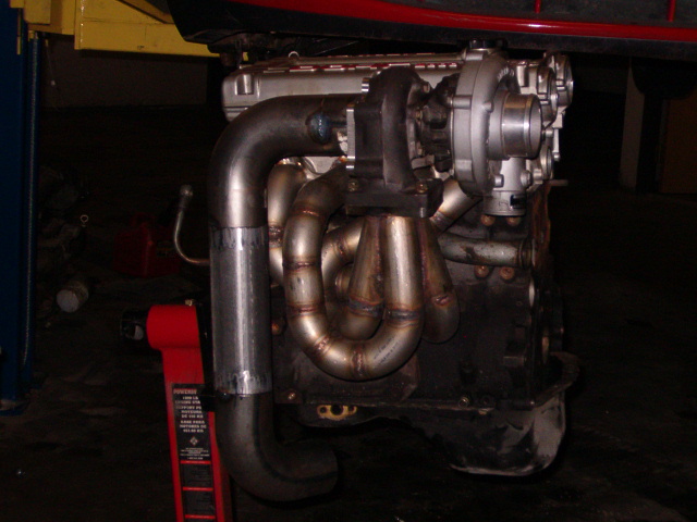

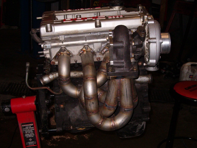

Worked on this one earlier this week, about 95% done, full SS construction. We will more than likely be using it on one of our of own projects as its not exactly ideal for your average DSM daily driver.

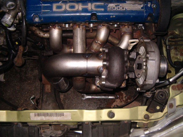

In car:

wow! haha that thing is crazy, but i really like it as far as ease to access the turbo. keep us posted on it

As it sits this will not clear the hood of a DSM, but the setup we are using it on the motor will be mounted transverse so clearnace isn't an issue there. If i dropped the collector length down to 3" it shouldn't have any problems fitting under the hood of a normal DSM.

How is the oil drain going to work since the turbo is upside down?
97 Viper GTS
Old 02-02-2005   #8
Re: T3/T4 Top Mount Header
Can't the housings be loosened and rotated to get the center section pointing the right way?
Correcto.
'04 Honda Ricer: stock
Old 02-02-2005   #10
Actually, they plan on flipping the whole header upside down. So the turbo is already in the right position.
