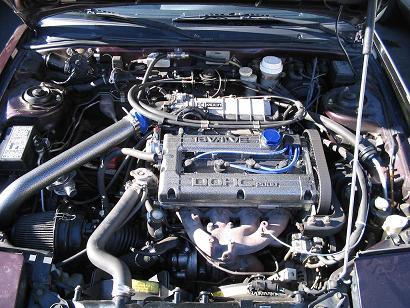

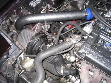

Here's a couple pic of my engine bay with the battery lowered. Kinda hard to see but maybe gives you a little better idea or something. I had to remove the Evap crap though. Sit's down in there nice and snug for now. I do need to clamp it down still somehow though. For now it's just placed down in there, and it stays put no problem, and it's worked fine like that for a year. But at the track, that may be another story. So before going to a track I gotta figure a way to clamp it down.

Thanks for the pics. Can someone tell me which Honda battery is the one to fit? Civic, Accord, etc??
Old 04-27-2005   #14
Re: Need help with Magnus install
Well I fit my stocker down there. But once I start figuring a way to mount it better, I'll just be going to pepboys or something and dig through the shelf of batteries to find a smaller one. But I'd too like to know which ones other people are running
