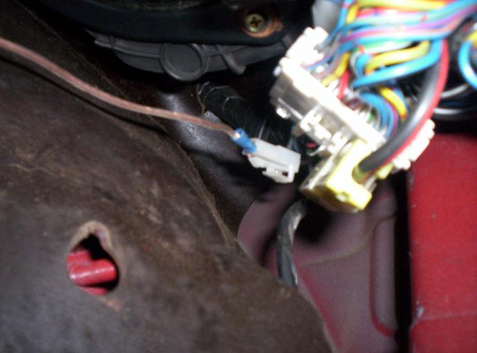

There should be a wire behind the passenger side kick panel you can splice into. i can get a pic of mine if you need it.

heres a pic you can see where I taped into the plug with a spade terminal

So, it's that single wire, furtherst to the left?
