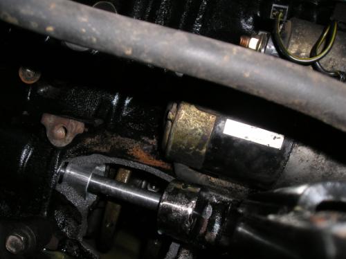

Re: What to do.......
here are the pics

I'd say fix it, once a DSMer Always! I can help you out in a few weeks when I graduate. It looks like the rotating assembly is fine from what you can see in the picture. The only place that the crank could have hit looks to be clean on the balance shaft.

Well, I know from talking to them before that the block did have new BS bearings in, the machine work was done by Napa. I just got off the phone with Alex, it was assembled without threadlock and at the wrong torque spec which is what I had suspected. The turned down ones are somewhat difficult to get correct torque to anyway, there is no surface to clamp the shaft to that isn't round so a few tricks get employed to get it tight without flexing it etc. Sounds like they were close, took most of the right precautions, soft jaws etc. The lack of locktight is likely the major issue. This is one of those things that you hate to see, could have been avoided, but ends up being another one of those expensive learning experiences. Which brings up my old thought of having a engine building basics area or thread that goes through step by step on a normal rebuild. A good place to get answers for people with the ambition to do it themselves without finding out by accident all the places that have bad info, like the many places in the manuals.

The balance shaft has the smaller oil pump gear on it's end bolted down while the other gear has the timing belt driven sprocket on it. They both require locktight and have different torque specs for each.
The balance shaft can come out with the timing belt gear still attatched and proper tension still being maintained. That is a good thing to hear anyway, at least there is no top end issues to worry about.
