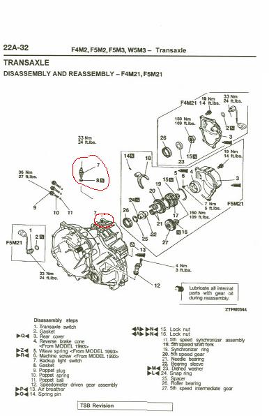

this might help you out...

Hey thanks a bunch! That really helped out....I didn't know there was a bolt next to it--guess I shoulda looked while it was out of the car...
