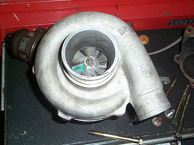

anyone know how to tell from just looking at it? here's some pics. I know it was from diamondstarmotorsport.com, and they do both turbonetics and pte stuff.
Anyone have a mitsi-flanged turbine housing that would work on this thing?

Looks like one of those 57-trim/60-trim T3/T4 turbos that were sold by places like TurboCalculators for $450.

really...so, junk then? Or still worth buying? Damn!
Old 12-01-2005   #8
Re: T3/T4 5-bolt setup: looking for opinions
It all depends on price. If it isn't blown and the price is right, then it would be worth buying. It will make power.
