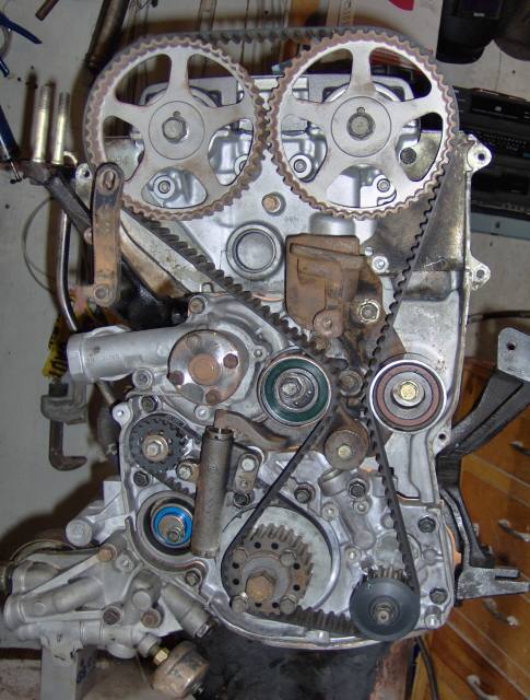

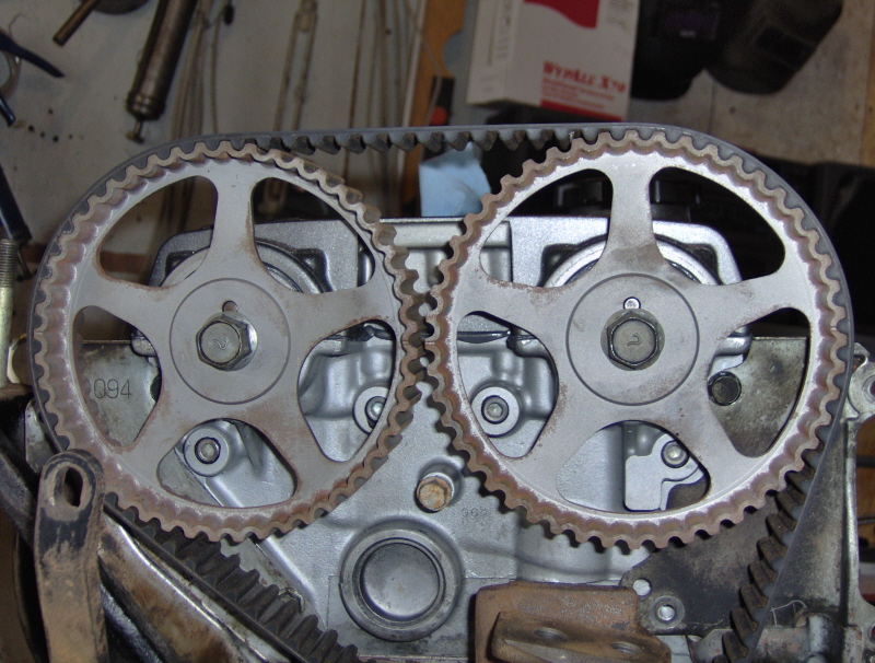

Well I finally got some time to put my timing belt on and this is what it looks like. I can't seem to get the cam gears to line up perfectly thought, when I put a straight edge acrossed them the middle lines are about 1/8" lower than the outside marks. Here are some pics so let me know if anyone sees anything wrong with what is done. Thanks

The cam gears look like the marks are lined up correctly. I can't tell about the crank or oil pump drive from the pics though.

Alrighty thanks a lot. I'm positive I've got all of the other timing marks lined up correctly; Those were the only marks in question.
