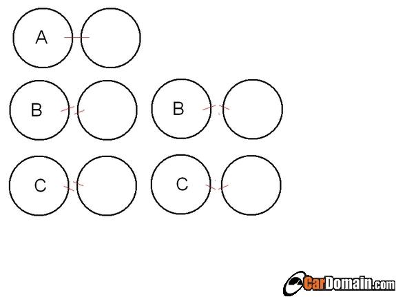

So I did a quick paint drawing. "A" is stock, and from what Im reading here it can be either "B" or "C", Is that correct?

The problem is that they can also line up like this. See the problem? It could line up 1/2 tooth in either direction. Your cam timing is still off. Trust me, 4-5 deg of cam timing can make a big difference in spool up, low and upper end power. Depending on the cams and engine, you could run the risk of valve to piston contact.

Pardon my iggnorance. But in that second drawing you posted vicious, when the cams are spinning that line will meet in the middle and be directly accross from another in rotation. So how does it make a difference if you line them up perfectly accross when they aren't in motion?

Because when they do line up correctly, they will each be 4.5-5 deg out of time with the crankshaft. What you are missing is the reason why it's different. The timing belt for the 2.4L has one (1) extra tooth on it to make up for the higher deck the 2.4L has. Not two (2) extra teeth. Two extra teeth would make it easy and they would line up correctly. But you are having to split the difference of one tooth. So depending on which side of that one tooth you line it up on will make the difference. Now do you get it?
