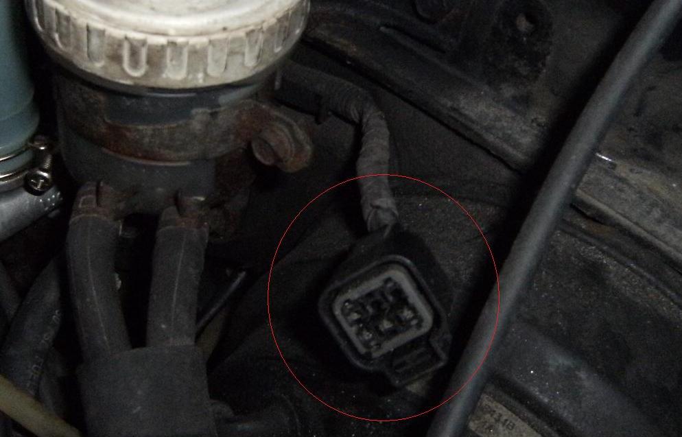

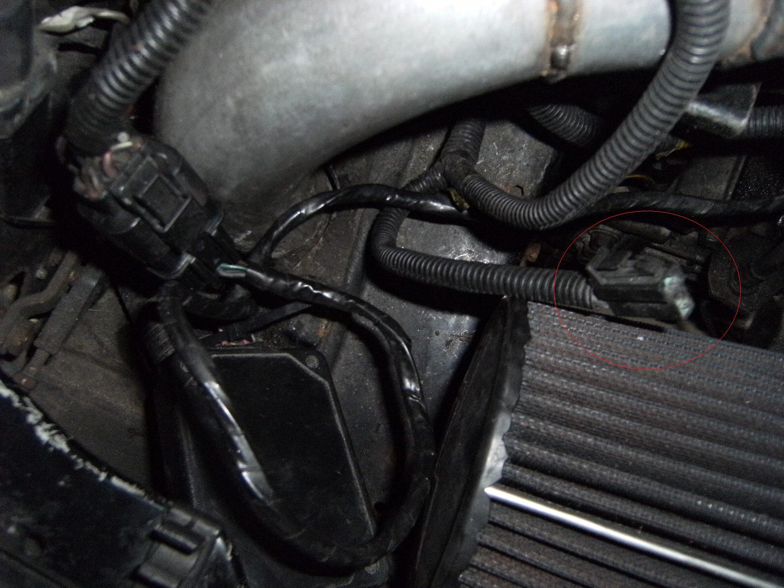

Pics
ID:	7307   Click image for larger version
ID:	7308   Click image for larger version

Does your car have its emissions?
These are the only plugs I can think of right now that are 2 wired in the engine bay:
Backup Light Sensor
Coolant Temp Sensor
Injectors
All Emission Soleniods
Knock Sensor
I believe that is it

Post up the color wires. That would help for people who have wiring diagrams.

The smaller one is for the stock BCS. The big plug by the brake booster is for your emissions stuff which looks removed. Do you have the ISC removed cause thats what the other plug looks like?
