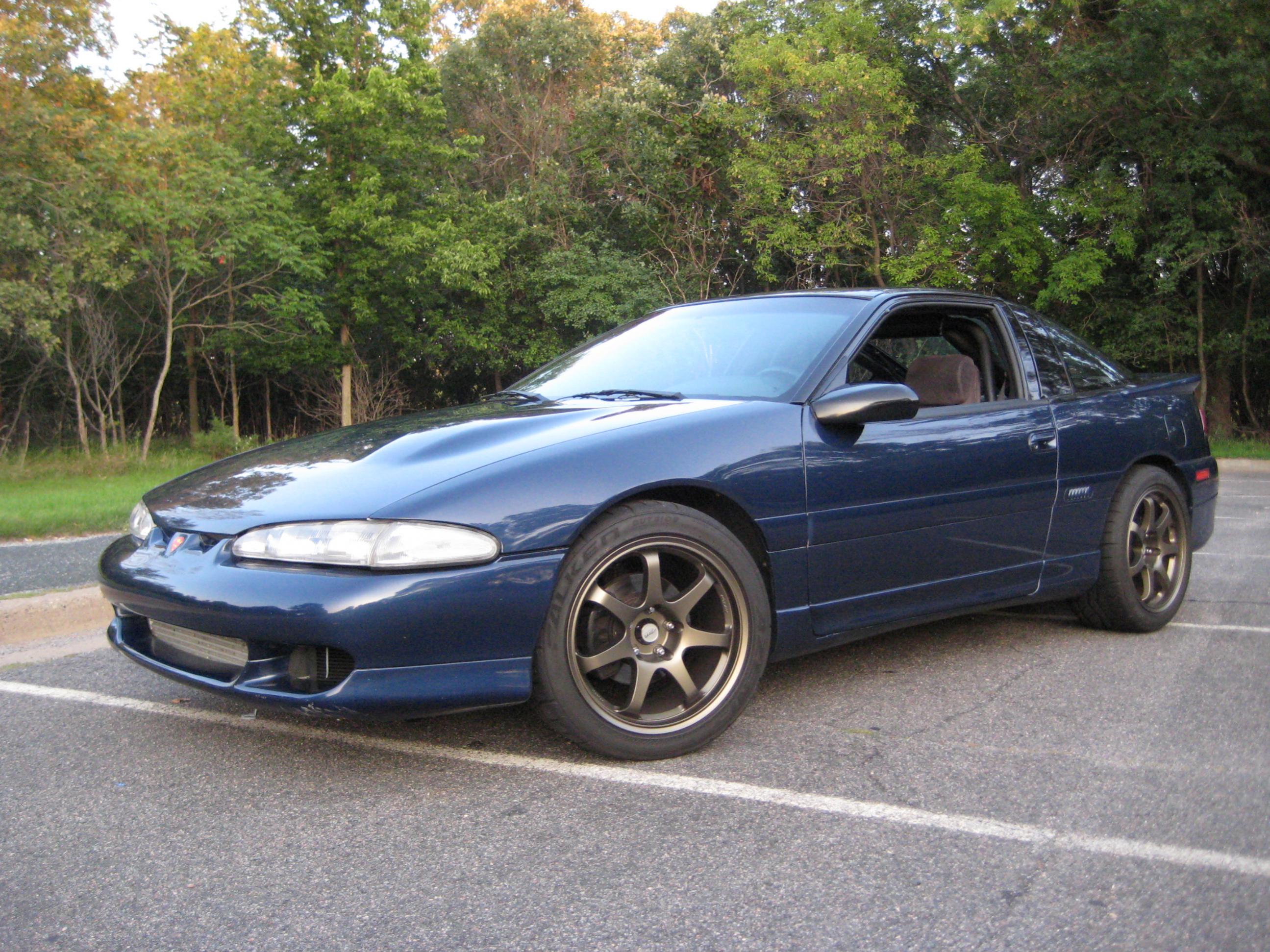

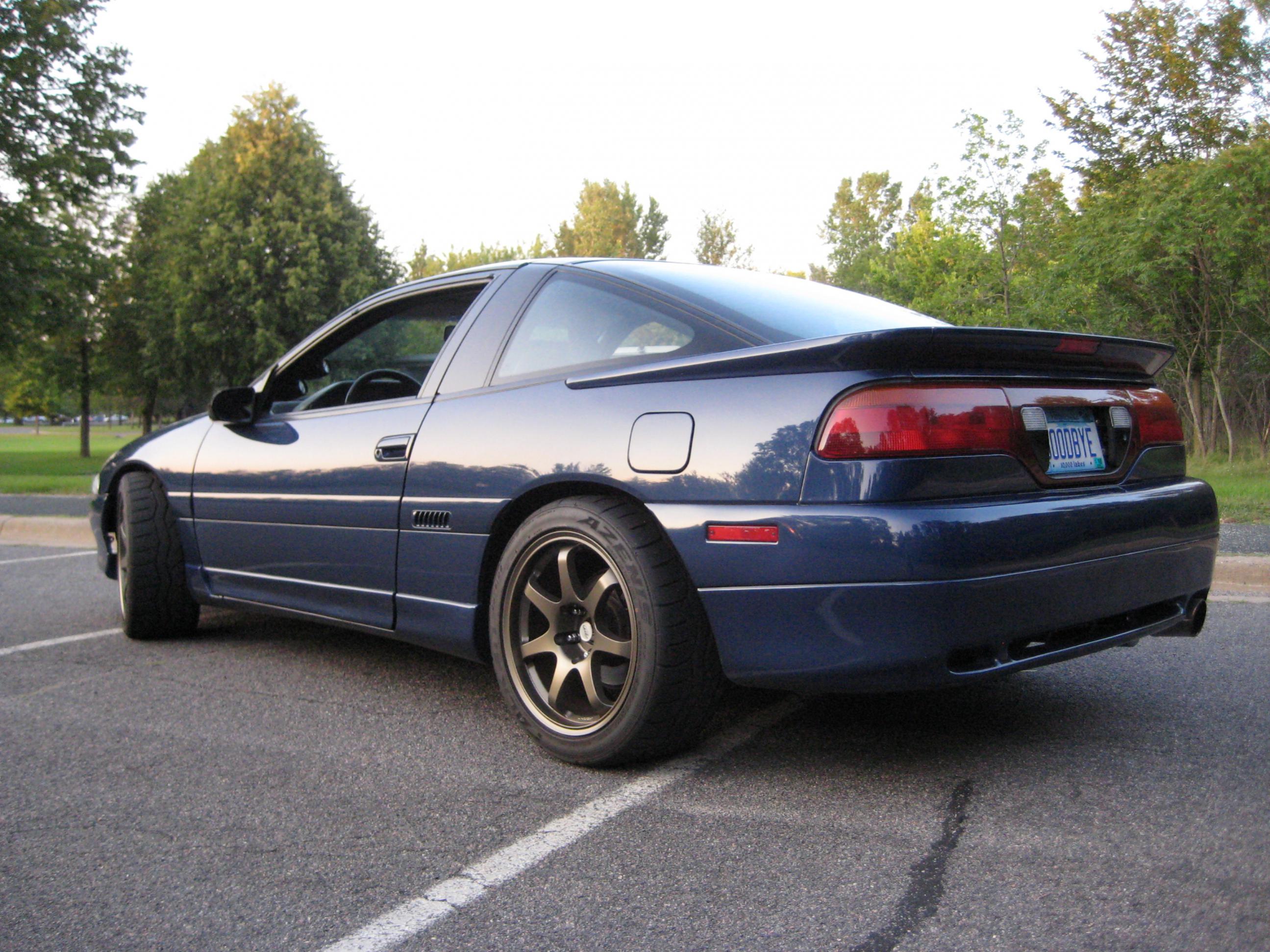

Re: What offset?
Stock offset is like 42, for 17x9's, something around a 37-38 is best. Here's the rims pictured above on my car, 17x9, 28mm offset, which stick out way too much in front, hence my going staggered with these this spring.
