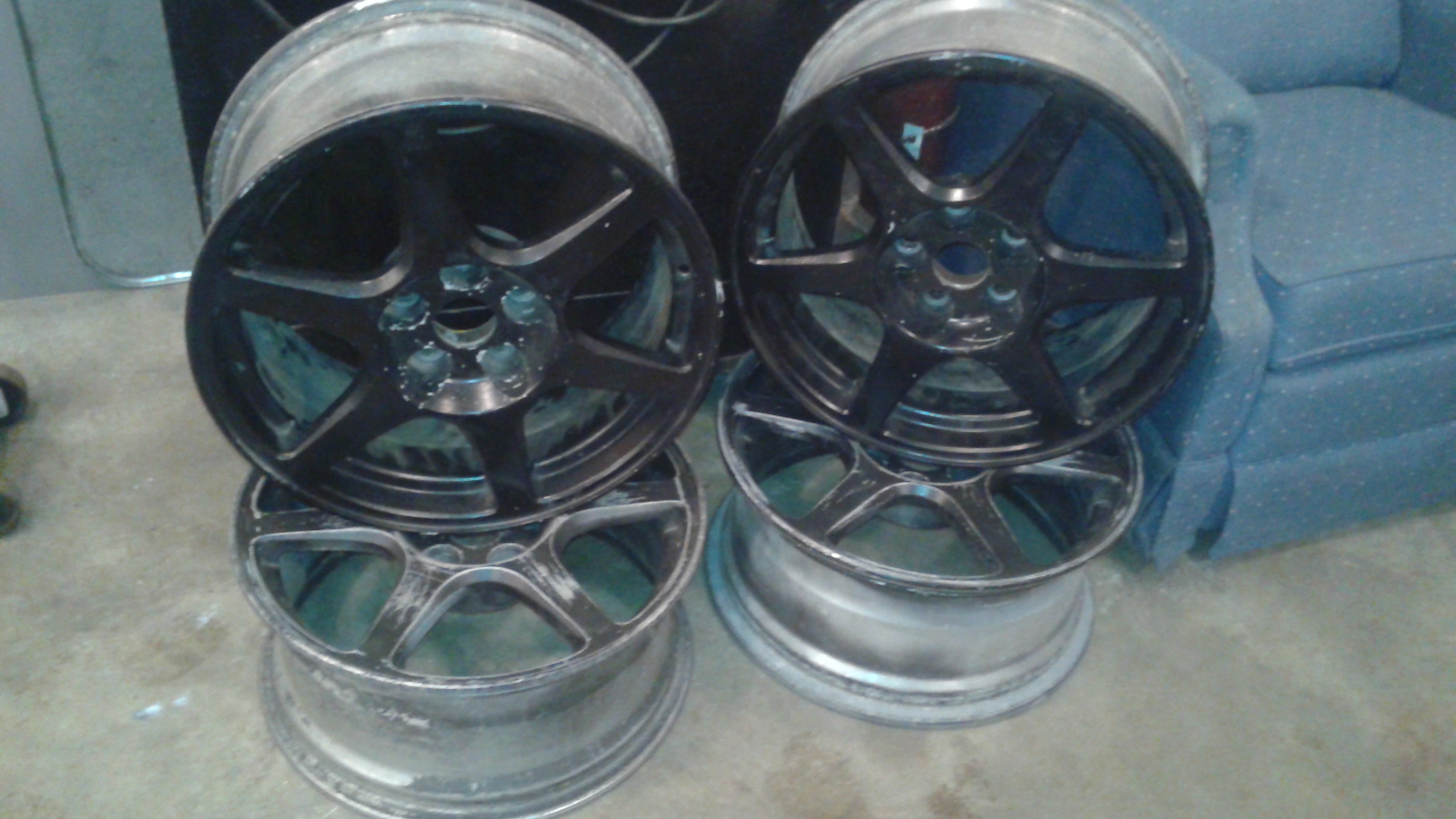

Craigslist find. Got me some Evo8 Wheels for $150. One ended up being non-repairable so I ordered another single wheel on Ebay for.....$150, dammit. Had all Wheels inspected at Alloy Wheel Repair Specialists in Mounds View. All are good so now I feel OK refinishing them.

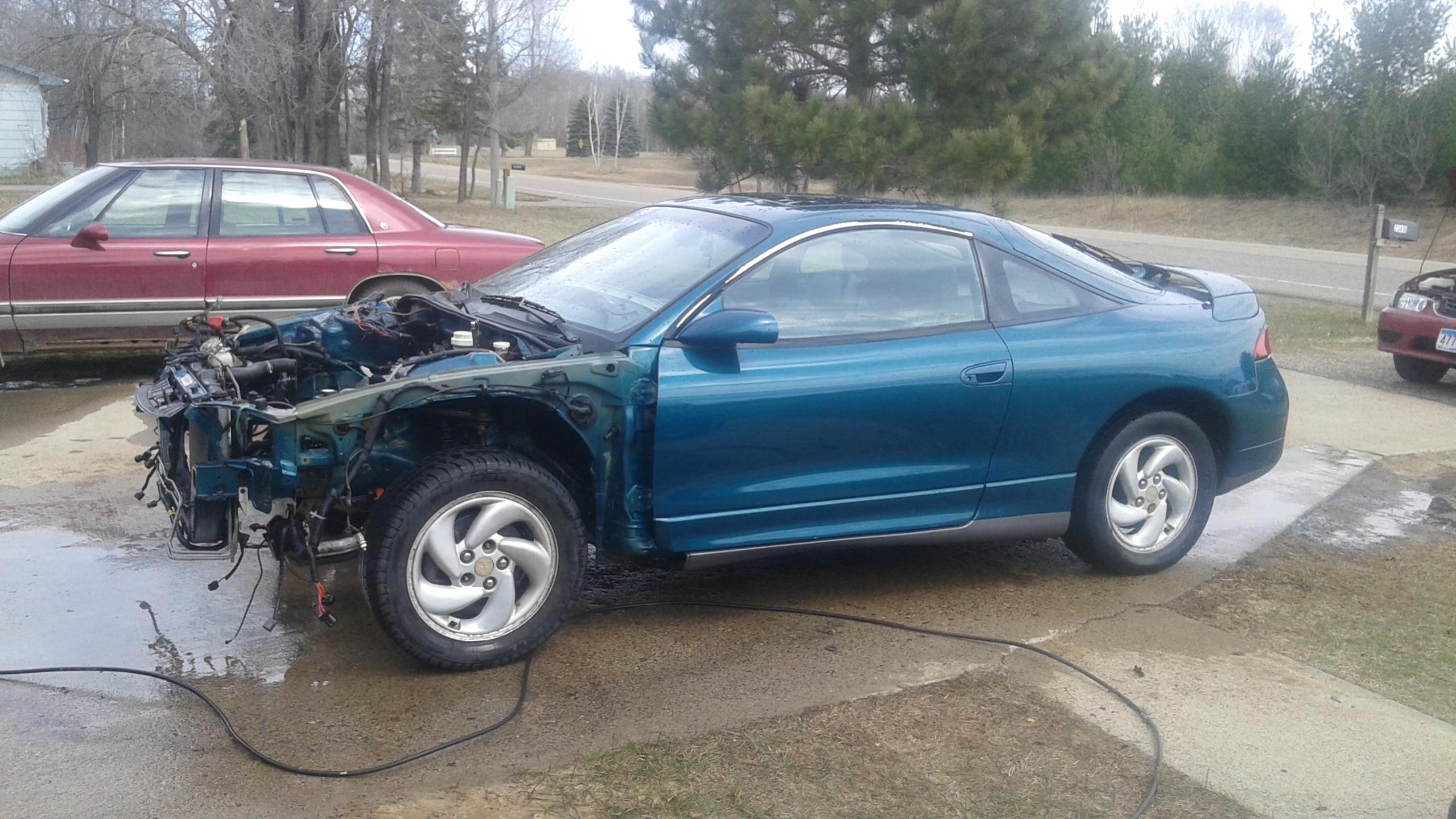

This Sunday was so nice I decided to push the car out and blast the bay and wheel wells. (and knock off a winters worth of welding,grinding and general garage dust from the paint) Getting ready for some more engine bay cleanup and POR15
I also tried out the sandblaster on one of the evo wheels.
