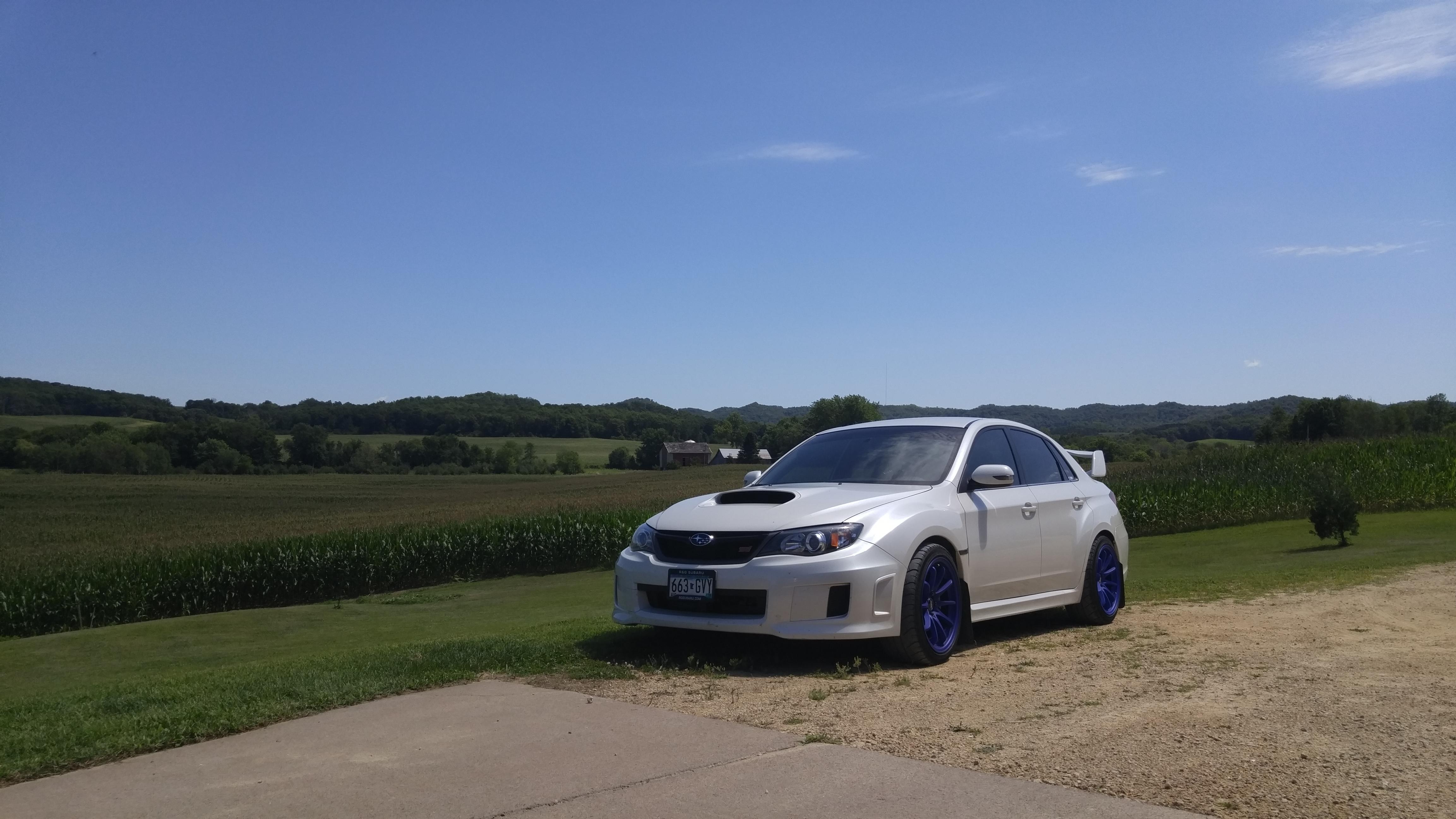

So i guess ill create a build thread for my 2011 Sti. Little backround on the car i bought the car back in August drove it till about october i pushed it a little to hard and spun a rod bearing. Then there my build started. So heres a list.

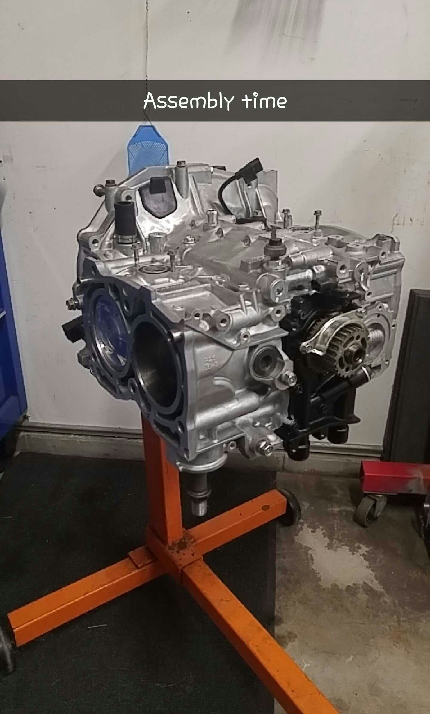

Little update on the Sti. Started to assemble the shortblock a little got my acl oil pump on and it looks great. Will be throwing on my killer b oil pickup tomarrow and thats mostly all i can do for now. Heads i ill be getting back at the begining of march as we are waiting on gsc to get cams sent out so we can check valve clearences.

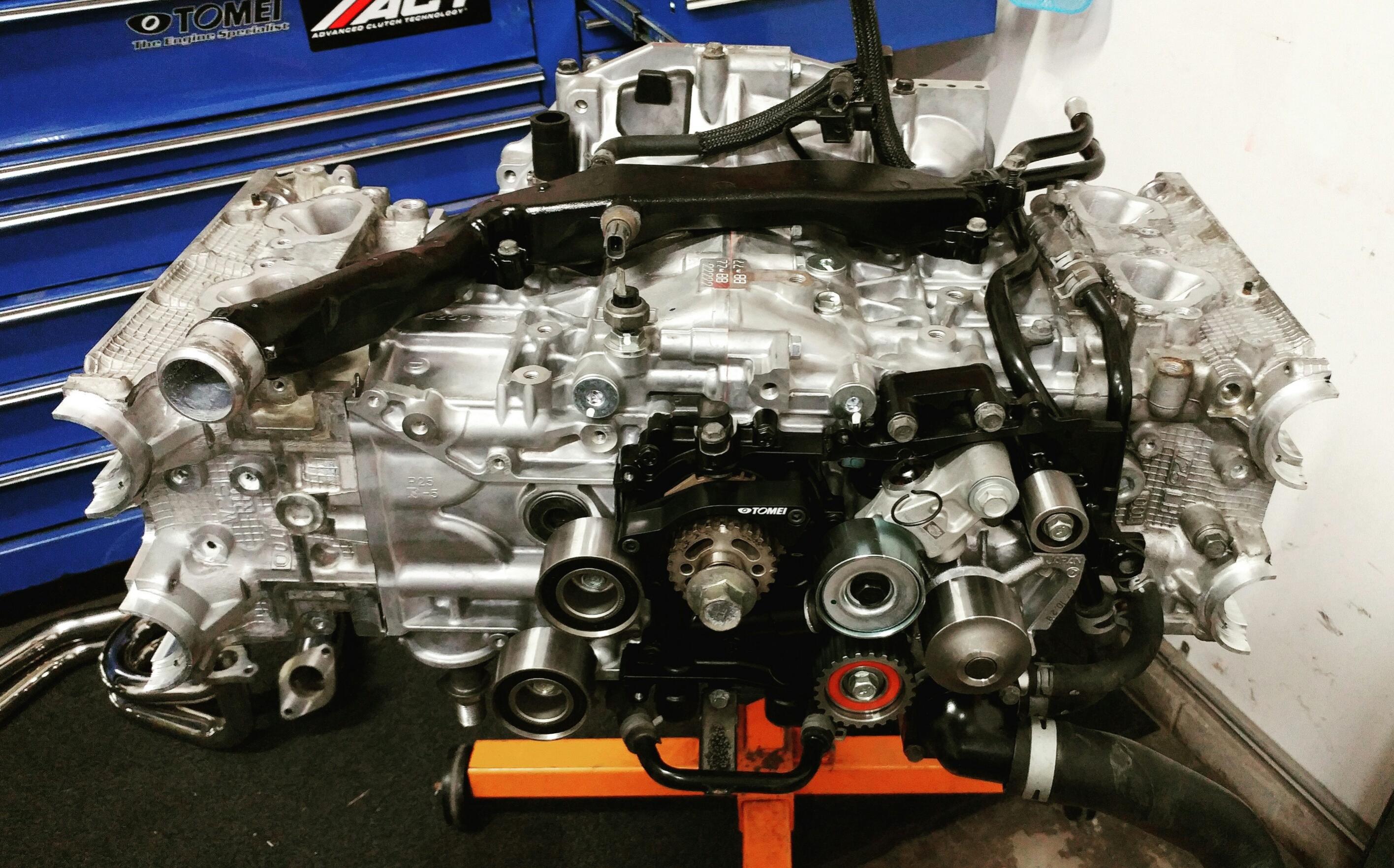

Saw your pic of the block of FB.. Looking good! Keep it up
