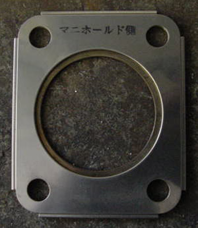

I just thought I would post up a quick pic for anyone looking to see what the visual differance is in the 2 turbo Gaskets.
The bottom gasket is the stock gasket. The top is the 7cm gasket.
Mitsu part # - MD171220 and MSRP = $22.73 + tax

Which means if you have any port work done, as in taking out the ring on the turbo, or exhaust manifold, it is a waste of your time to put the 6cm gasket back in.

Looks to be about 1 cm difference to me

And to think I thought it was an inch. LOL Yeah, I figued we have one, wh not post a pick so people can actually see a differance. And right now through Mitsu they are 3-4 weeks out for getting them.

I would imagine your turbine gasket is already at least 7cm, and more than likely a different shape(since you have the twin scroll setup).

The EVO's have a slightly more retarded gasket than the DSM's do...but a nice 7cm gasket will give you a nice gain. Your stock gasket is basically a restrictor plate with 2 holes in it to allow the exhaust flow. I believe all EVO-certified Mitsu tech's were briefed on this so maybe 1quick4 will know more about it. I have heard if you remove it the warranty will get voided...but then again going to the grocery store will have the same end result.

IIRC the Evo8 has the equivalent of a 9.8cm gasket, and switching to a non-twin scroll gasket will kill the spoolup(add a shitload of lag).The idea of a twin scroll setup is to keep cylinders 1 and 4, and 2 and 3 exhaust pulses separated all the way to the turbine wheel, preventing them from meeting in the manifold out of phase.This allows the Evo to have a larger turbine housing and better spool than normal setups.

From what I had read the EVO8 gasket was sized the same at the 7cm, I appologize for this information. Anyone here looked at the collector on the EVO8 manifold? I would like to see how it looks.
