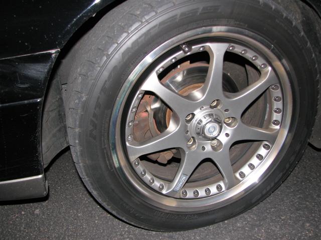

I went for a walk around the car after my nap last night and found that the brake caliper was halfway off my rotor! I took a pic. The top bolt must have fallen out, so the top half was leaning off the rotor, and the scratching was the caliper scraping the inside of my rim... The bottom bolt was still in.
I'm going to talk to them tomorrow. I want to handle it professionally, not going in and blowing up like some other stupid customer. Any ideas on what I should expect from them? I never bring my car to shop, so I don't know really how to handle one of there services that went wrong.

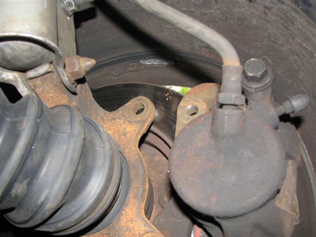

No just about 10mi back to Eau Claire. I looked at it when I took the wheel off. The bolt fell off the knuckle. I got a pic of that too. Only damage is the scraping inside my rim.

So why not just put the bolt back in and tighten it to spec and call it good?
Unless you want to go after the person who "didnt" tighten it enough and want somekind of money back for the damage to your wheel. I dont know if they would do anything about it or not.
