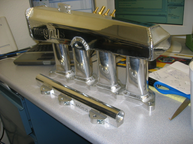

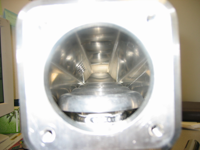

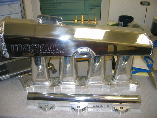

Well after all of that BS with Revived racing, and placing my order for ANOTHER magnus intake mani through Extremepsi.com, i finally got it, along with the fuel rail. WOOT
Tonight install party.

It looks like they had a small design change though. In the pictures on all of the sites it didnt have the extra support between the runners, now it just has a bracket on both sides.

now this fuel rail is freakin huge, so i dont think ill be able to put it on until i redo all of the fuel lines, and maybe get a 255lph pump. so thats gonna wait.

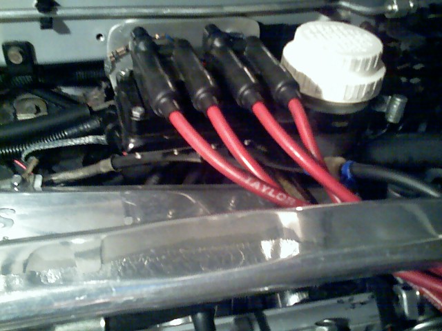

And also, i dont know where im supposed to mount the Coilpack (and the other plug.) now that the mount is gone.

Make one, or I think some people sell kits to mount everything. Looks pretty sweet though.

Mount the pack over by the driverside strut tower. Thats the most commen spot I see it at. Or custom a mount on the firewall.

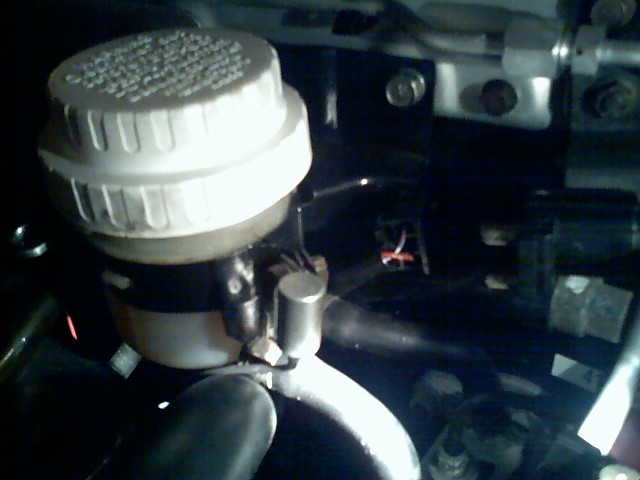

First off: The manifold doesnt have a flange for the sensor on top of the manifold. and doesnt have a spot for this little capacitor looking thingy.

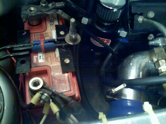

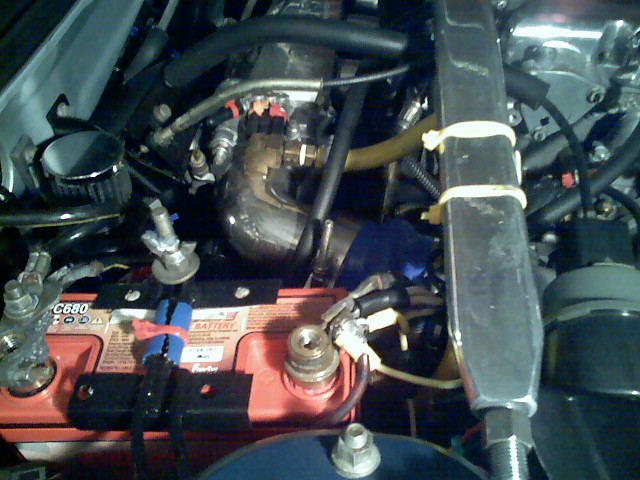

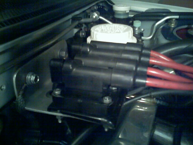

Here are some answers to some of your questions (please view attached pictures). I custom fabbed my own coil pack holder. I've had numerous comments on it. I've built a couple for other people too from the dsmlink forum. Also is a picture of where i put that little capacitor looking thingy. I've attached a couple pictures of what i did with the battery situation. I purchased an odyssey battery off ebay. The hold down bracket was modified by cutting it in 1/2 and shortening it. Nice and compact but don't leave your big amp/stereo run too long without your car running. You'll need a jump start. I believe some of the Honda batteries will work also. I modified my UICP a little bit also.

The honda battery that is commonly used is a Group 51 or 51R(reversed terminals) It is a very narrow battery. Maybe 4" by 10" when looking down on it.
