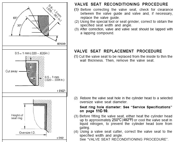

all I'm needing now is the angle's needed!! I have an idea so far thanks to ecoli but I am just wondering if anyone has done one before. and if anyone knows exactly what angles and where to do them...also a pic would help thanks a lot in advance!!
Old 02-03-2004   #2
1ViciousGSX's Avatar
Posts: 5,382
1st cut is 15 deg (chamber side cut)
2nd cut is 30 deg (valve seat face)
3rd cut is 60 deg (port/pocket side cut)

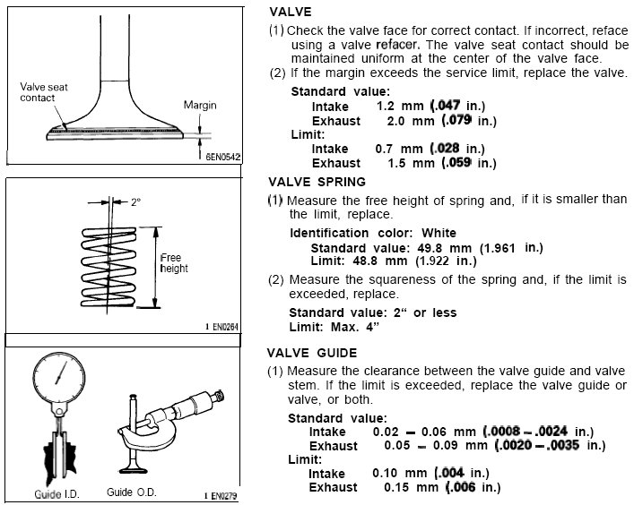

Here's the valve info.

wow thats awsome thanks alot!! where did you get that from?
Old 02-04-2004   #5
Posts: 5,382
DSM manuals on cd.
