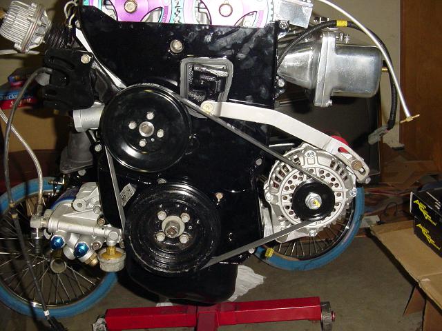

I can't even see how it would work. At least with the Jay Racing, you can see it mounted. I'll probably do something like that. Now that Shane mentions it, the shroud over the steering rack might be an issue, which means I'll probably have to mount it higher. Here's a pic of the Jay Racing setup:
