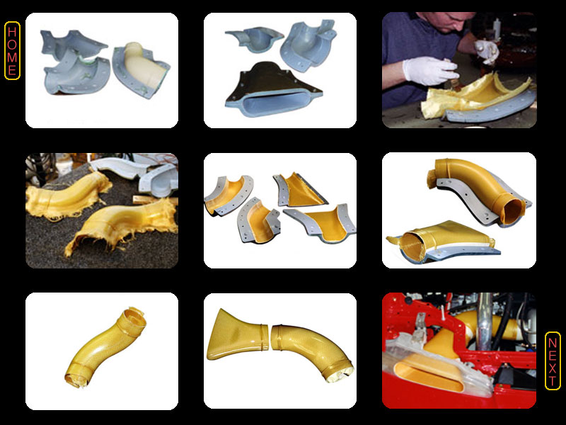

Old 05-06-2007   #5
Re: Who fiberglasses?
Is this kind of what you're looking at doing?
http://www.aerocompracing.com/induction%201.html

Old 05-06-2007   #8
I think most everything on that aerocomp car was one-off and expensive. I would just run with Jet's explanation and that picture, that should get you there.
