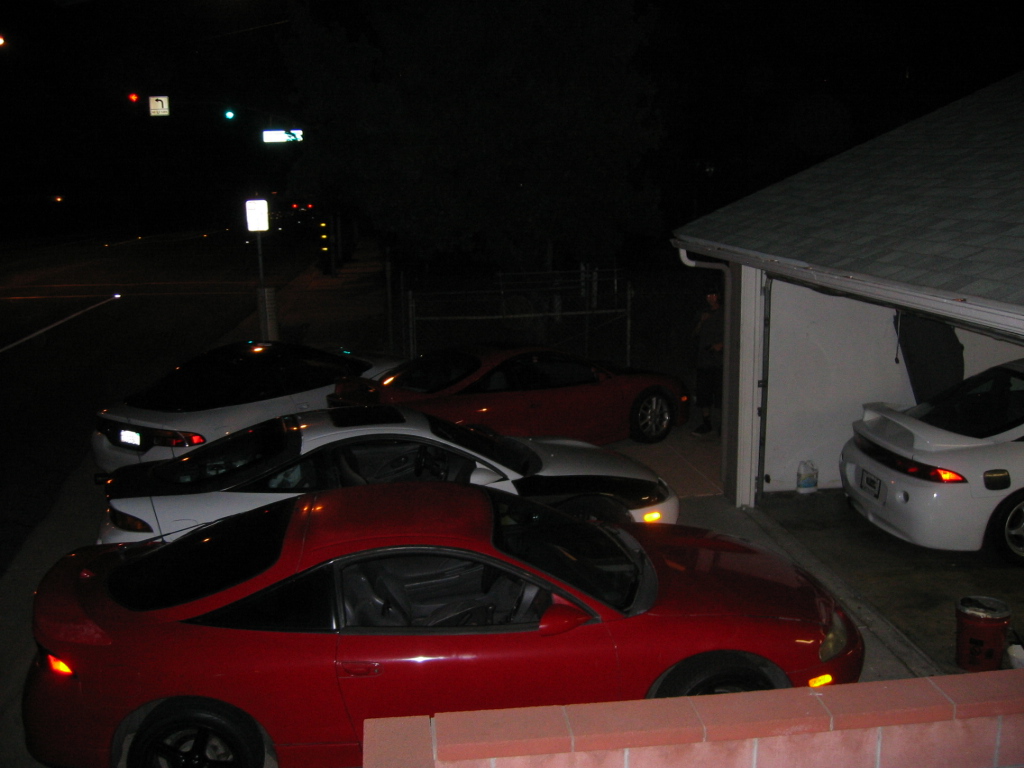

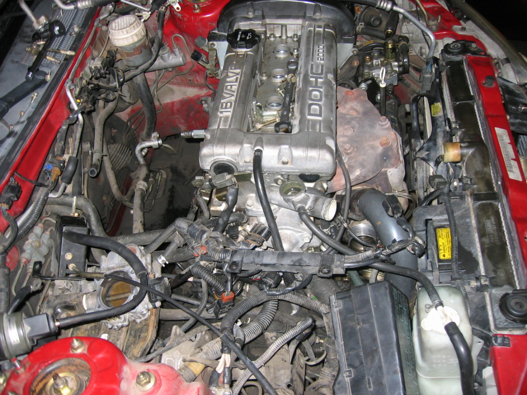

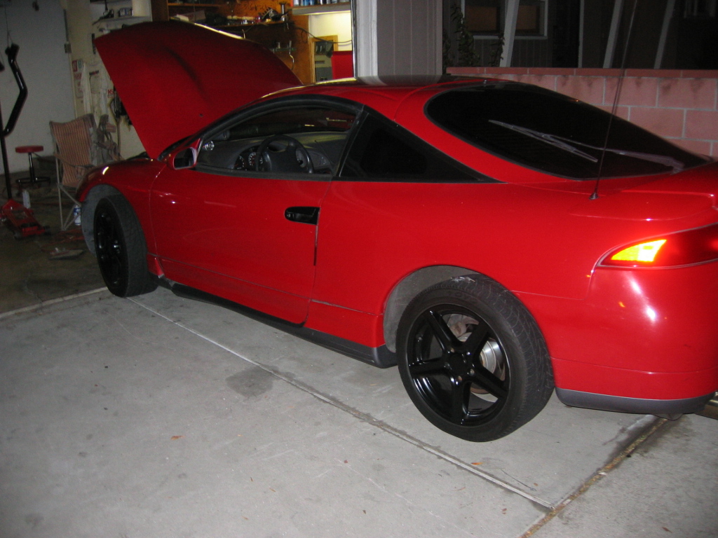

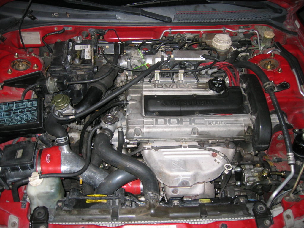

Here are some pics to start.
Picked up the car looking like this http://www.dsmstyle.com/forums/showthread.php?t=16956
Here is a couple pics before i really started the build. I changed the rims, added a side skirt from my White GST and painted it red, painted the mirrors red as well. The middle picture is me and a couple friends Count the dsms... Also not shown is my white gst which is hiding on the side of my house. Third pic is of the engine bay before the build

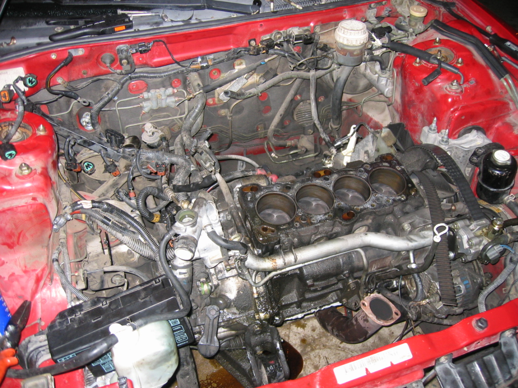

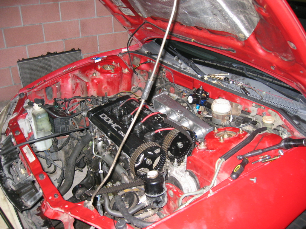

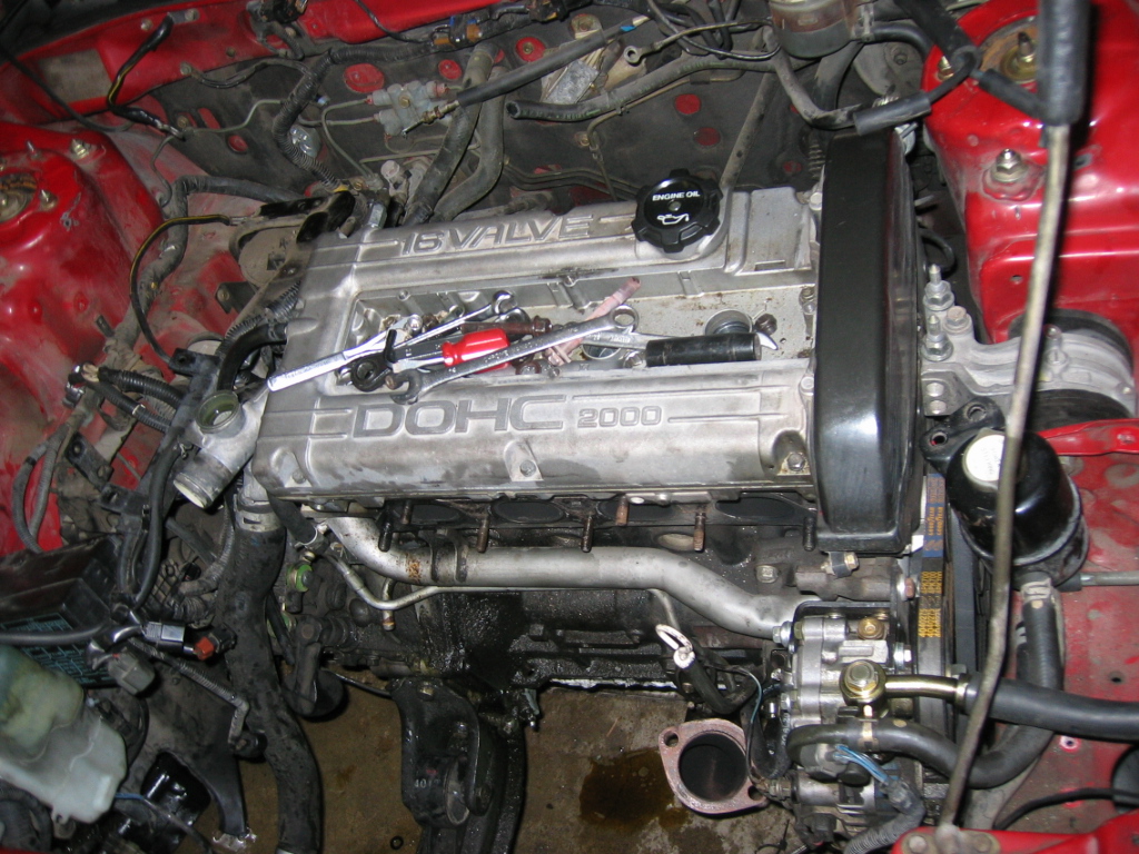

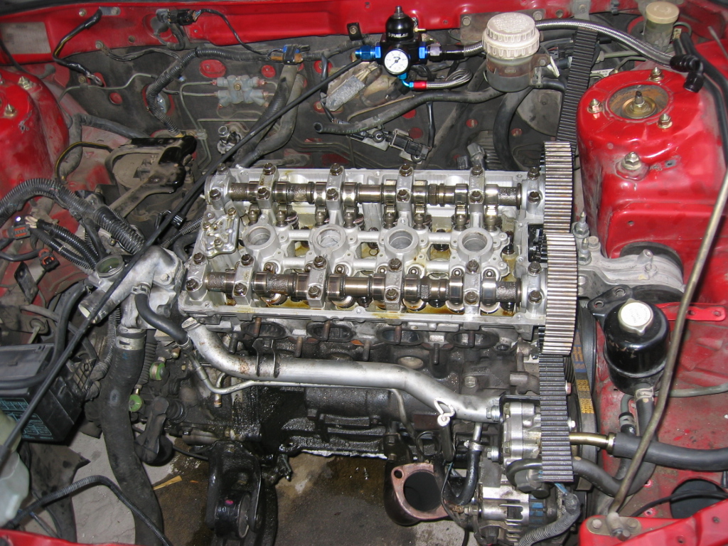

Here are some pictures of the progress of the build.
More pics coming tomorrow of hopefully a finished project.
