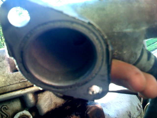

I didn't want to take off the radiator cap when it was hot, I filled the overflow bottle after 20 minutes or so. Never tried to take the cap off since I was afraid it would explode off. By the way, why would this kill the car?
Anyway, took off the upper radiator hose and couldn't find the thermostat, maybe the previous owner took it off? Where is it at on a 2g? Here are some pics, looks like there is a decent amount of gray RTV on both surfaces. So should I put it back together with a gasket and make sure the water is flowing? I'm really a noob to all of this, any help is greatly appreciated.
Oh, I just did another compression test, this time with the motor completely cold, and it was 160, 180, 180, 190.

Do you stall have all of your stock radiator fans in the car? Not sure they fit with that turbo. Remember I said to put heat shields to cover the turbine housing and o2 housing?
Old 10-28-2007   #12
Re: Overheating
Stock fans are still there, and they work. I also never had the heat shields for the o2 or lower exhaust areas. It was running just fine, even a trip down to iowa it never overheated. Now in 10 minutes of regular driving it overheats, something definitely broke.

The thermostat is under the pipe below the one you removed not that one. Sounds like a HG to me as well. Try checking to see if your thermostat works with the hot water trick and see what happens as well but that wouldnt explain the smoke.
