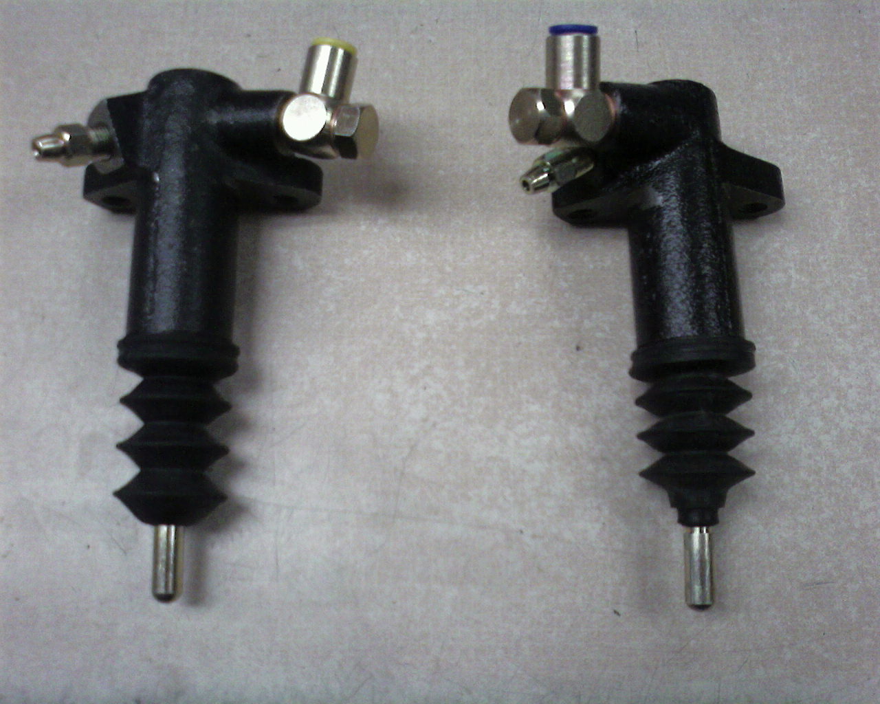

Are AWD and FWD slaves even interchangeable? I think I remember getting a FWD slave for my AWD and it would not work.
Old 02-27-2008   #10
Re: Clutch hydrolic system
I believe the way the FWD slave mounts to the tranny is different. I'm not 100% positive about that, so don't quote me on that.
Old 02-27-2008   #11
I am pretty sure you are right b/c I remember that being my problem. Just buy a new AWD slave cylinder to keep thing quick and easy; I highly doubt the small differences in size will make a difference.

Turns out you guys were correct!
The only way to use the FWD slave cylinder is to run new metal brake line....which I am not willing to do now.
Here is a picture of the FWD(yellow cap) vs. AWD (blue cap)
