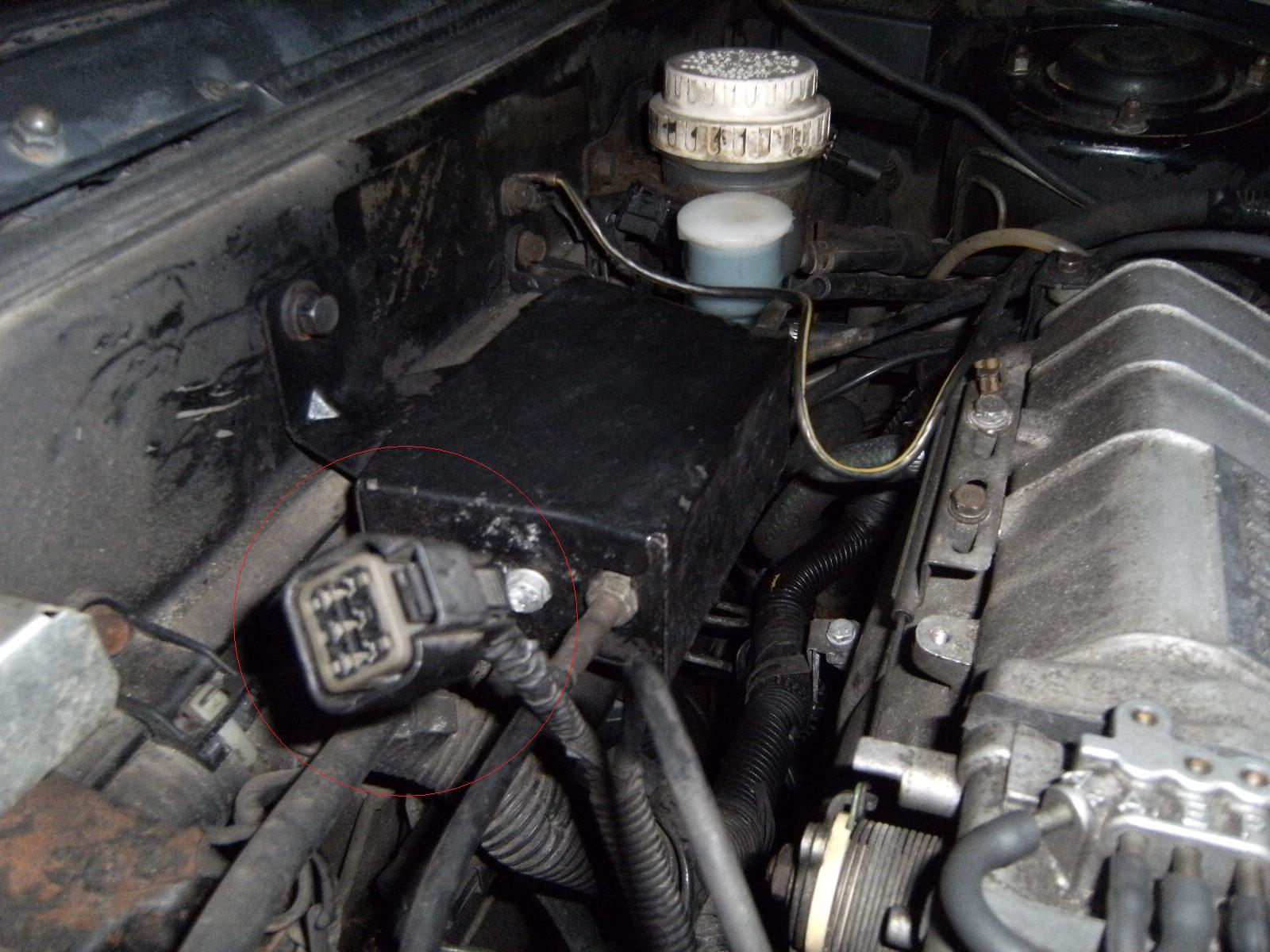

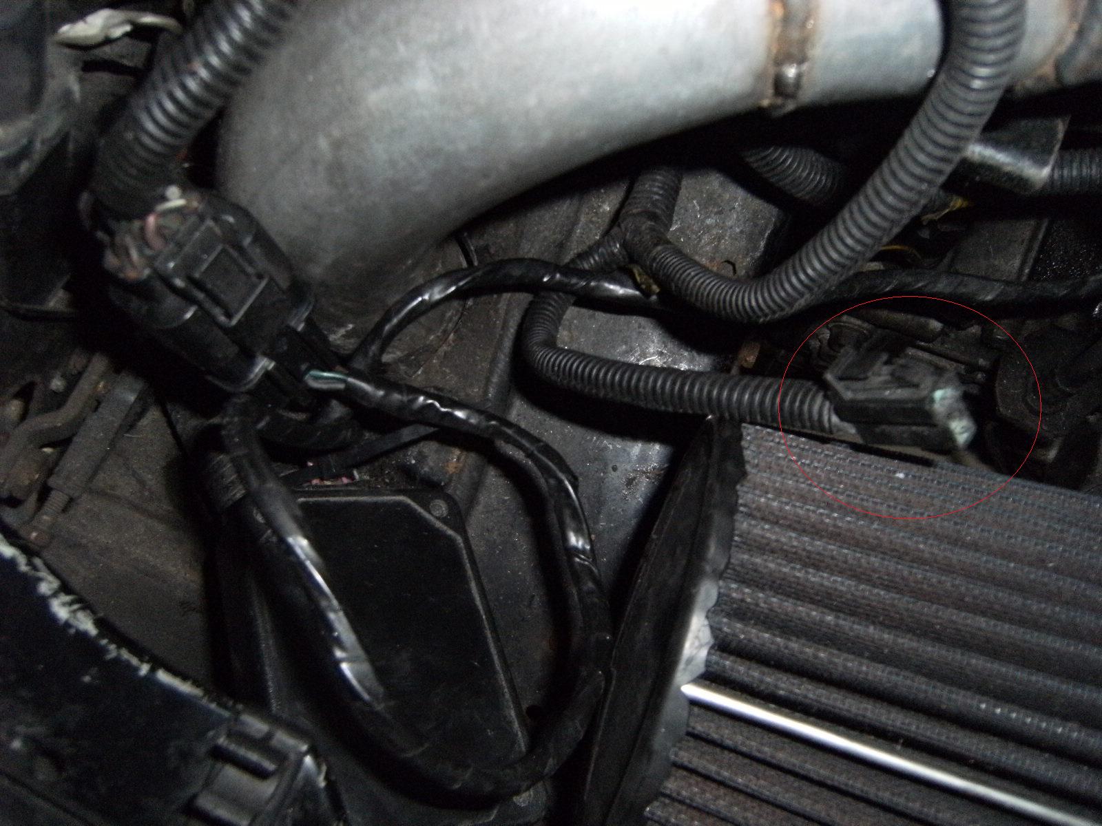

Pics

Post up the color wires. That would help for people who have wiring diagrams.

The smaller one is for the stock BCS. The big plug by the brake booster is for your emissions stuff which looks removed. Do you have the ISC removed cause thats what the other plug looks like?
