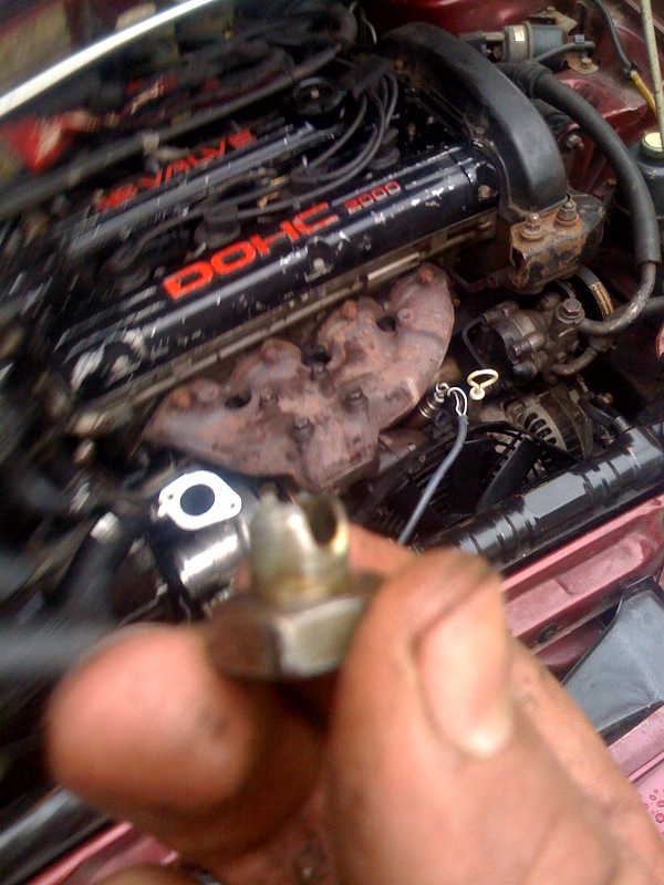

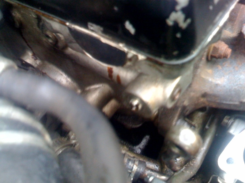

So was throwing my new 16g on the car, had to do a little bending on the top feed line that goes off the head. Got it where i wanted it, and then went to screw in the feed bolt. Went in nice and easy, almost too easy. As I got towards the end, it snapped off. Needless to say im pissed. So anyone got any ideas on how to get this sum bitch out?

Bolt extractor, can be found at almost any good hardware or auto parts store. I think i've even got a set laying around here, but no idea where.
It's like a reverse threaded wide screw, you screw it into what you need out, it grabs on, and reverses the stuck "Bolt" out.

Is that going to work in my case? Its a hollow bolt.

Yeah, actually makes it easier. For the kits if it's a solid bolt you have to drill it out in order to work, so in this case, the hard, and dangerous part is done for you. Now you just gota pick up another banjo bolt to put in there.
I'll link something in SB when i find what i'm talking about.
