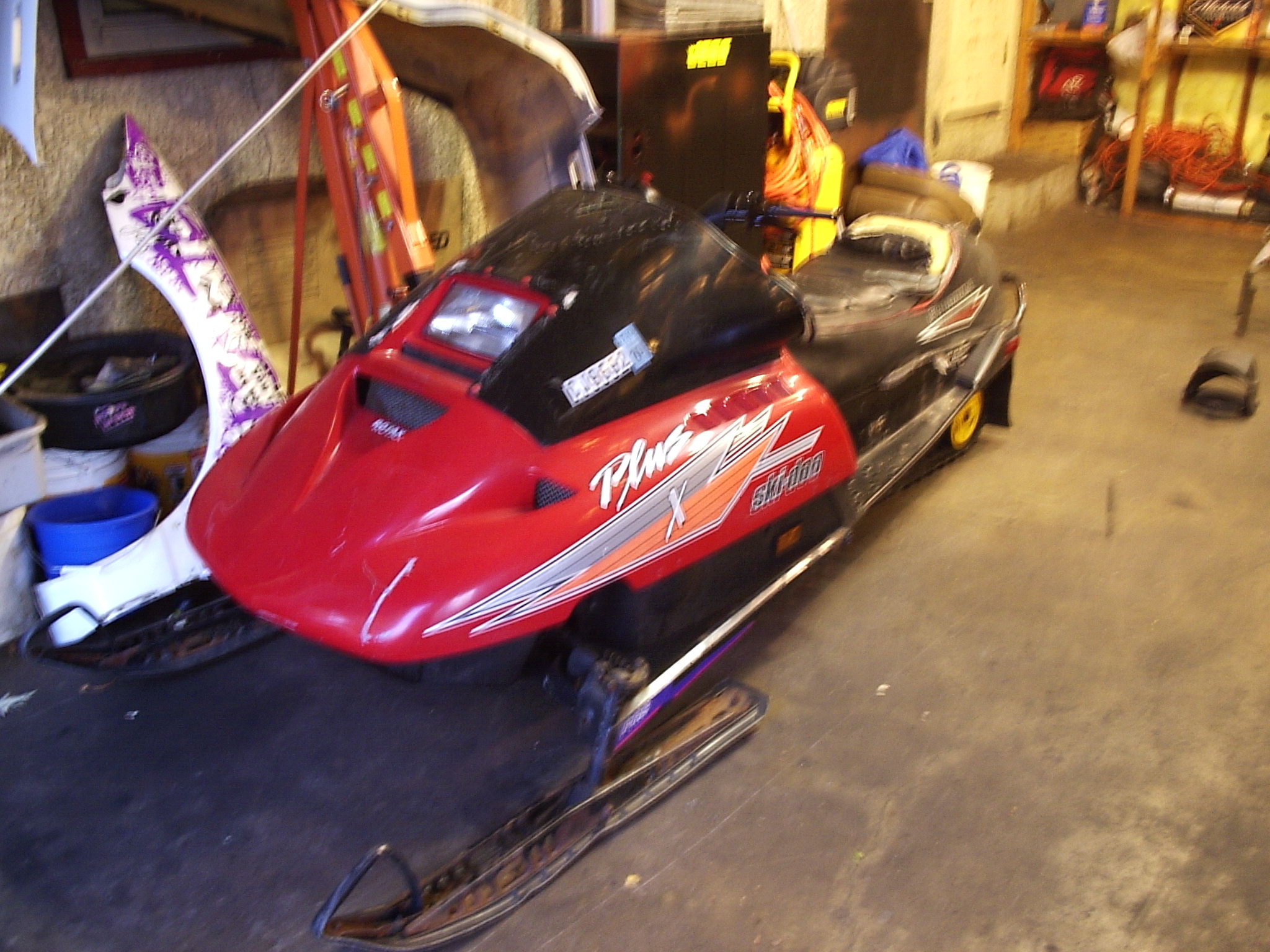

Here is what im working with.

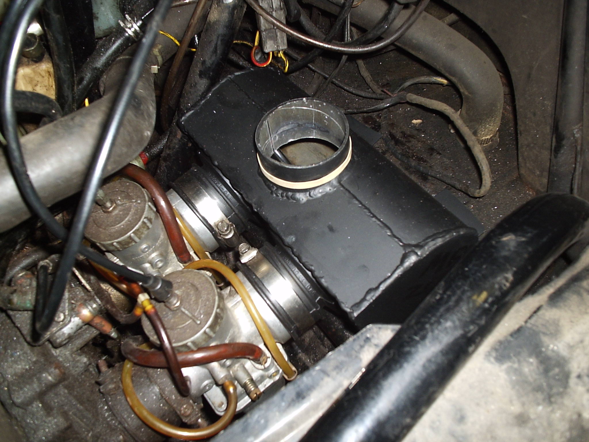

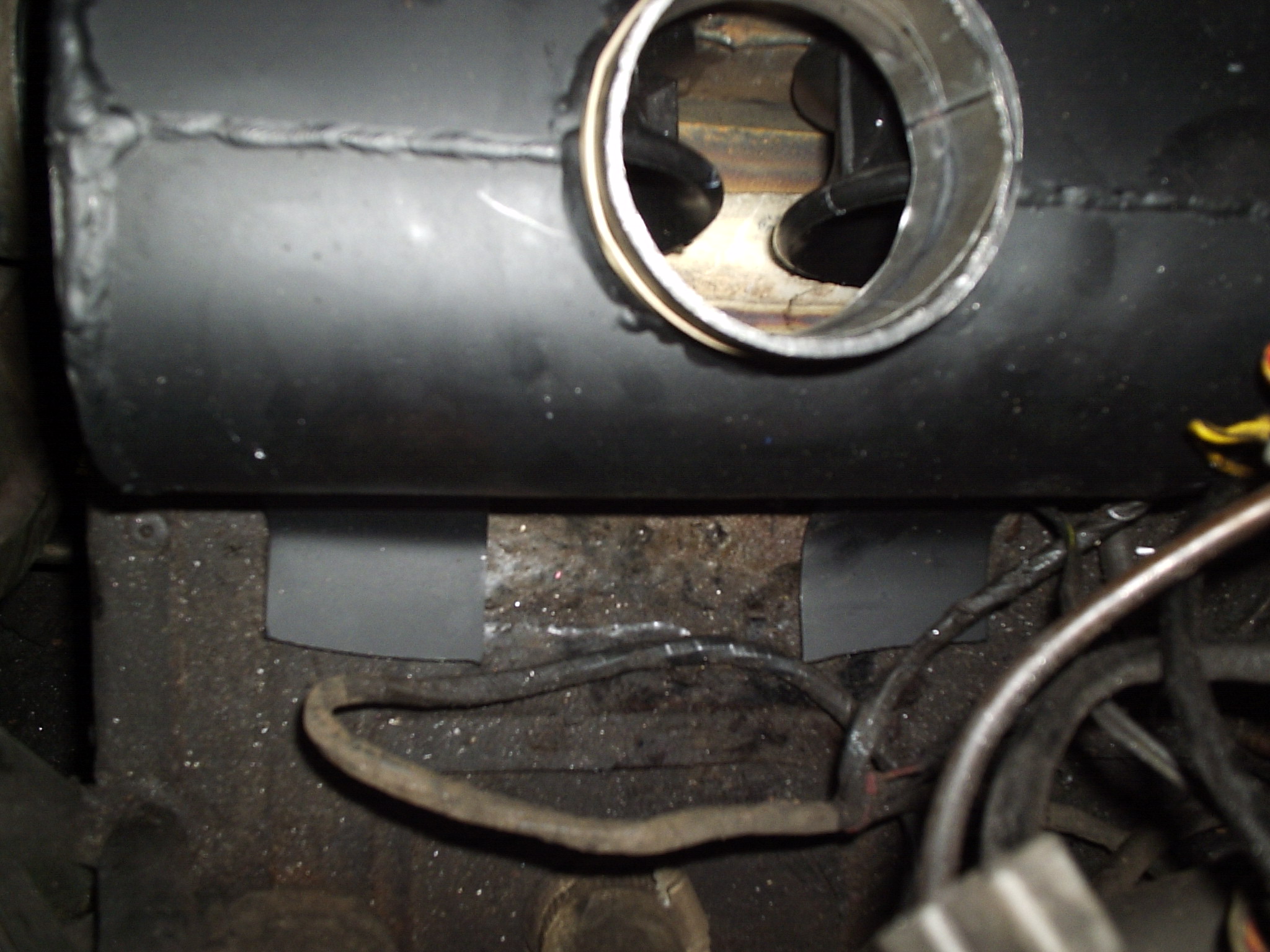

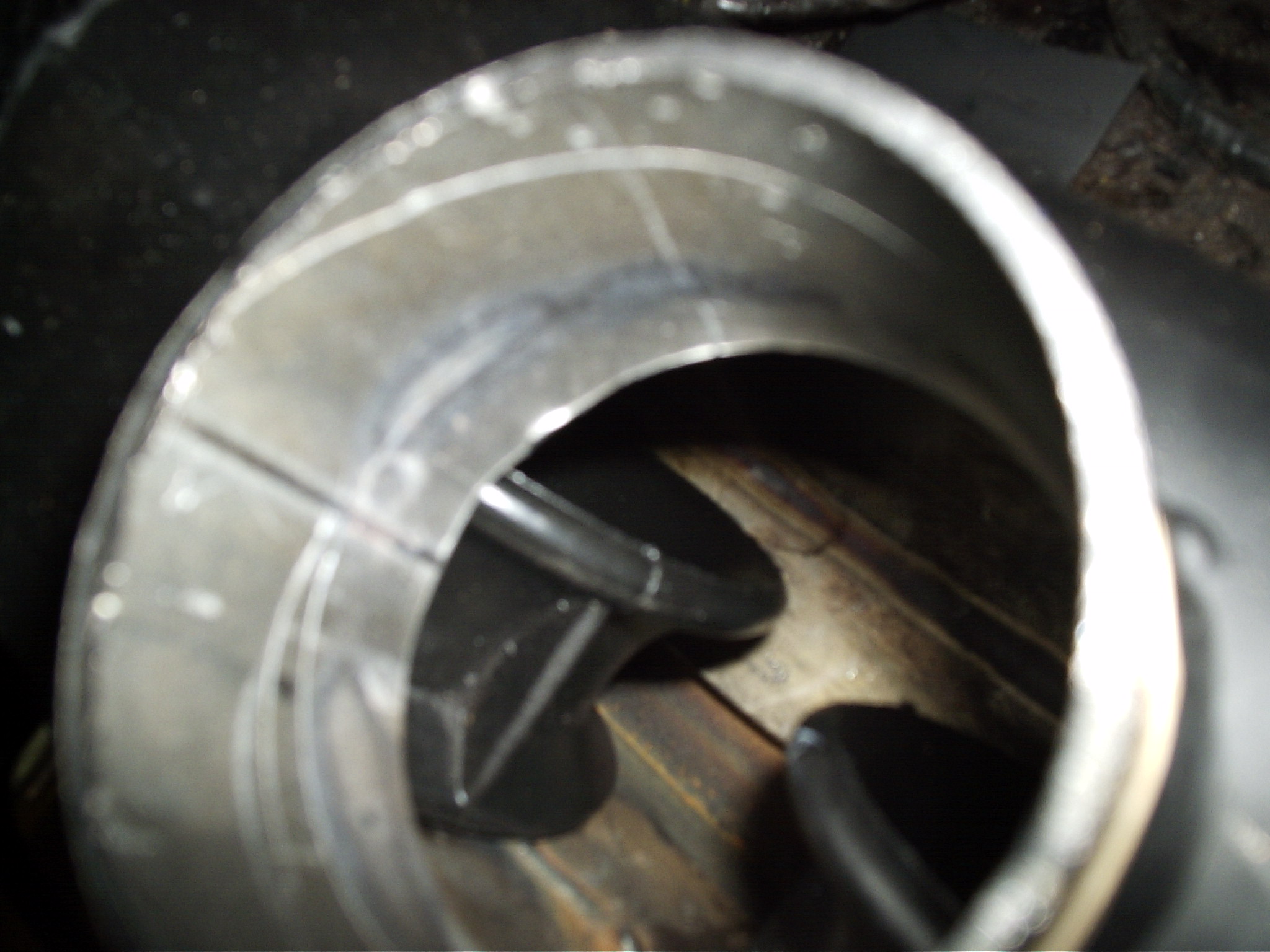

91 Ski Doo Plus X 583, Its mostly all stock except for the C&A Ski's, And the intake manifold i just made for it. The main question i have right now is how do you get oil pressure to the turbo? I was thinking about using a 12v universal pump from Orielys but i dont know if that will provide me with a consistant oil pressure or even have enough pressure for the journal bearings.

There is a shit load to turboing a sled then what you think. I am in the process of doing it myself and will be posting up my kit and process once finished.
You have to convert the carbs to blow thru, run a different fuel setup to supply about 5 psi of fuel pressure over what boost you are going to run, change timing, lower compression and much more. You cant use a small turbo that spools quickly because the exhaust pressure will be to high and will create too high of exhaust temps. Let me know if you need any help. I have been in contact with a few people in Utah and Canada with my setup and should have all the parts shortly. I am going to be running a 14b and 4-6 psi and about 10 with e-85 and should hit over 200hp with a 600cc 2 stroke motor.
