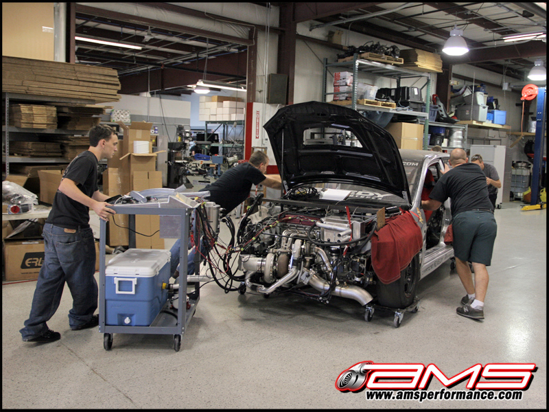

Never seen a setup like this. Very interesting.

That was what they were using for their 1000hp on 100oct contest entry. They ended up ditching the twin-turbo setup at the last minute and going single due to time constraints. Looked sorta promising though.

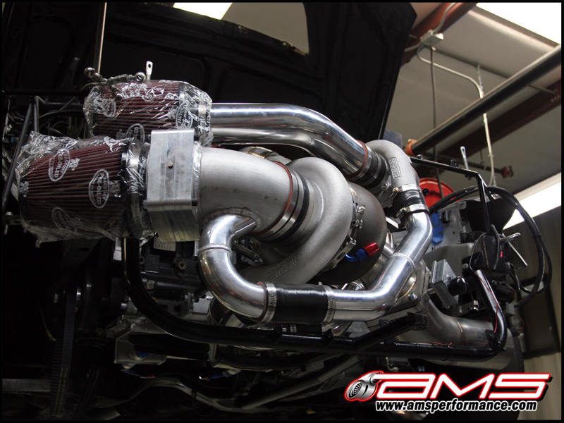

the turbo setup looks bigger than the motor itself. holy balls!

Holy shit that's a big turbo.

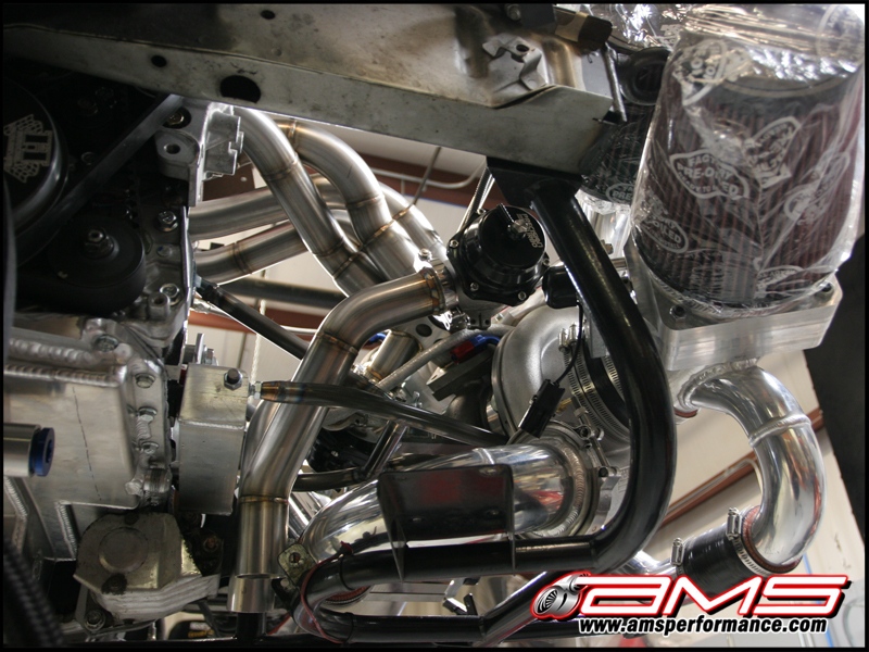

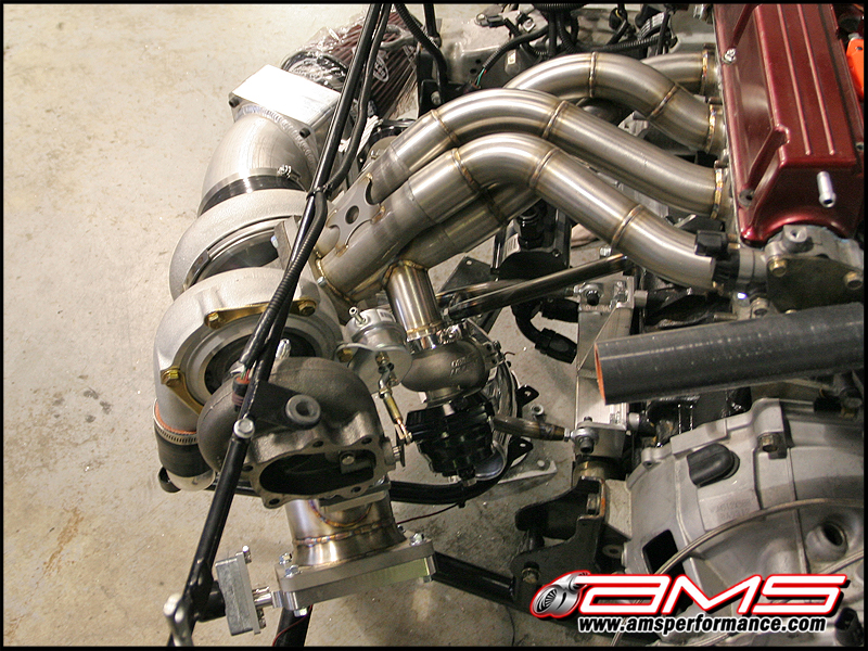

Crazy sequential turbo setup! It looks like they were going to use gates to route the exhaust after the big turbo spooled, as well as one in the intake of the big turbo so they could pressurize it. Pretty crazy idea and great execution, too bad they didn't pursue it further.

So were they trying for more low end? Or would it have run more like a staged turbo setup to get more boost out of the big turbo? Nice fab work as always.

It's sequential, smaller turbo to help spool up the bigger turbo. Which in their case was needed. haha
-1990 Mitsubishi Cyborg 4WD-
Old 11-19-2008   #18
Re: AMS Drag car pics
No, in that setup, the small turbo would not help spool the big one very much at all, it is there mostly just for lower end power. Those big blocks in the exhaust and intake of the big turbo are doors/valves that open up once the big turbo is ready to spool or the small turbo has already spooled. The waste gates vent to atmosphere.
Old 11-19-2008   #19
If that is the case then tell me why the output of the small turbo is fed directly into the larger turbo. The gate in front of the large turbo must close so that the small turbo can pressurize the large turbo, then once the large turbo spools, the gate in its intake opens so it can suck in more air. I am sure it would take a lot of messing around to get the timing of all those gates right.
