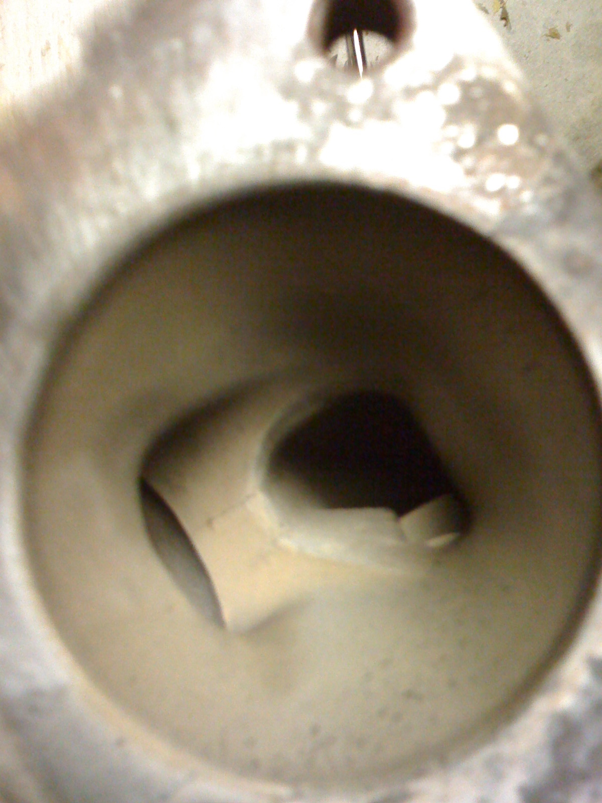

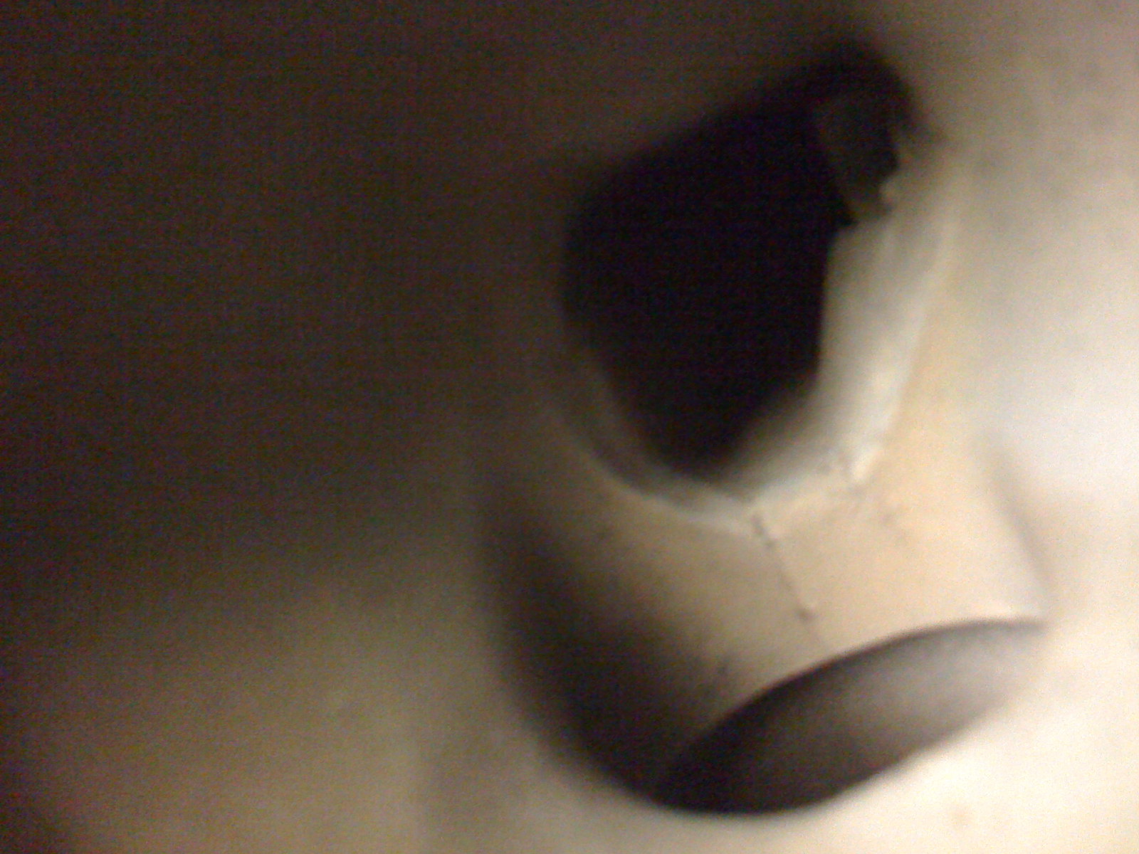

^^ Not sure what you mean, but I took better pics from the inlet showing the wheel, also some from the side showing the crack on the wastegate hole and also of the turbine wheel.

I was talking about this. It might just be the angle.

Ah I see now. I just checked it and the little notch is part of the housing, like a small casting nub. You can see it in the other pics.
