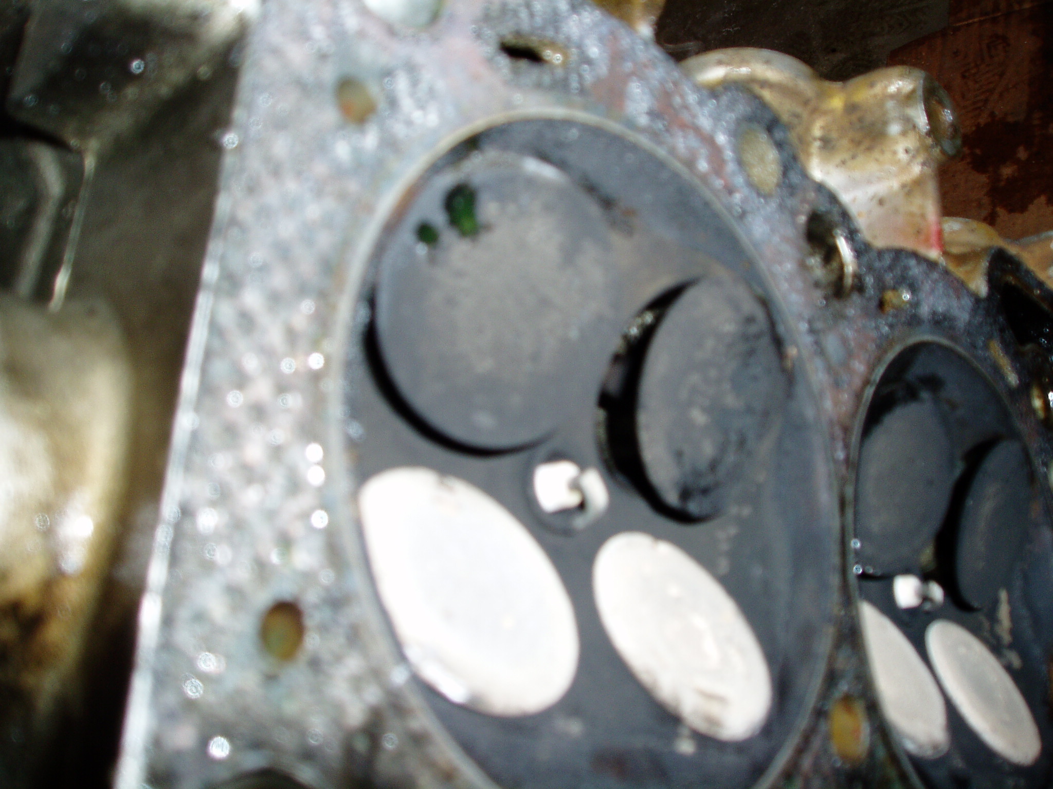

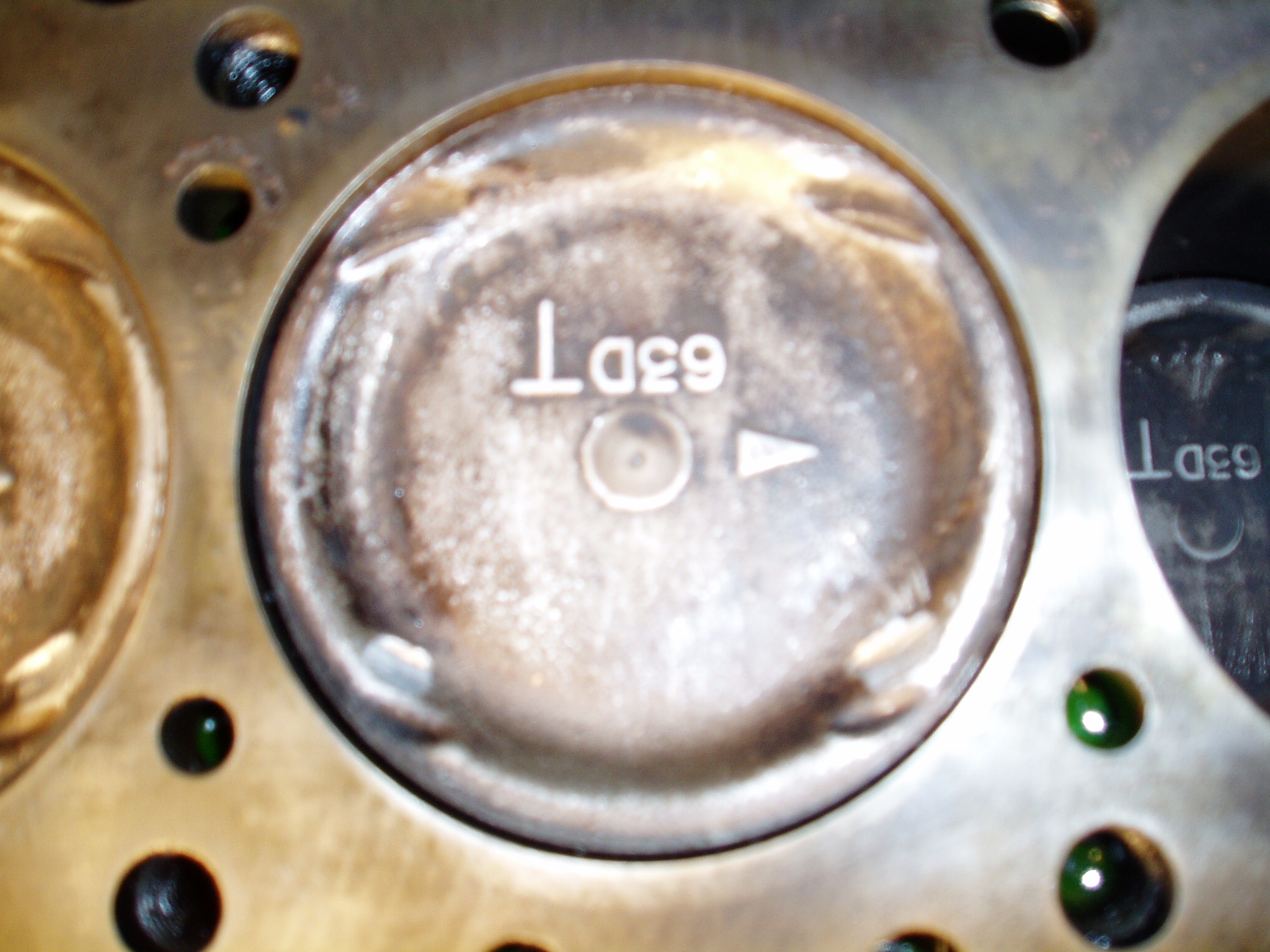

Well here they are!! Doesn't look like engine is damaged. You see all pistons, the broken head, and the new one

File down the pistons where they had contact with the valve. Other than that you'll be good to go.
What the hell is all over your engine bay? Looks like metal shavings or over spray...

Ya that was all the gunk that was left over from a junk head gasket that I had to grind off. Now I am just lining up everything to slip on the timing belt and the cams want to turn about 2 to 3 turns off of their mark. Is there a trick to keep the cams and the crank in the correct location while you get the belt and tensioner on correctly?

Wow, those valves hit the pistons pretty hard. I wouldn't reuse them, but I guess worst case scenario you have to redo the engine. Good luck!
