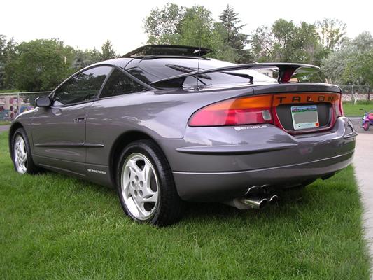

About 2 years ago I finally found the perfect Talon after almost 2 years of searching. I found a 98' Eagle Talon TSI AWD 2 owner, never smoked in, Mobil 1 it's entire life, and records of all maintenance since it was 1 year old. Fully loaded, 68,000 miles, rust free and in excellent condition. But there was a catch. The car was in Loveland Colorado.
After much persuasion I convinced my Wife to let us get the loan and fly out to pick up the car. We cashed in all of our saved change (pennies, nickels, etc) and we had enough to buy 2 one way tickets out to Colorado. We were going on a limb as if the car was not as promised we could not afford to fly or rent our way back.
When we got there we found the car to be excatly as promised and in amazing condition. One of the first things we did was drive up into the mountains at the Rocky Mountain National Park and up a dirt truck only path. Thank goodness it was all wheel drive as it was too narrow to turn back. Then coming down the mountain roads was a blast! Amazing scenery and wildlife out there.
Attached is how the car looked when I first saw it.

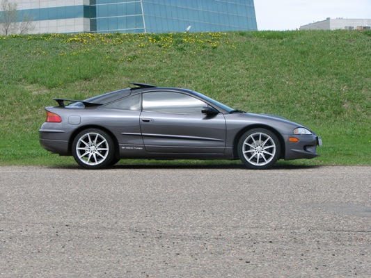

After much saving a friend in Monticello needed to sell his rims and tires and this became one of my first mods. Motegi 18X8 rims wrapped in Falcon Z's. It helped with some of the wheel gap but more was needed and came later.
Then A K&N FIPK went in, Dejon Tool UIC and 1G BOV, and the BCS mod. That made for a more responsive car and it sure hugged the road better.
I couldn't wait to see the stock rims gone. Those were terrible! Attached is the car after the "new" rims and tires went on with lowered suspension. Photo Credit: Shanna (Wife)

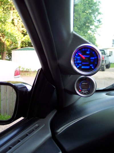

With things starting to change and weird sputtering when in boost I then changed direction a bit. I installed the A pillar 2 gauge pod and hooked up a 30/30 Cobalt Boost/vac gauge and a blinky O2 sensor gauge.
Then went on to change to plugs, wires, alternator. things were better but not perfect. The NGK BPR7ES seemed to work best and needed to be replaced less. I then also switched to Royal Purple oil.
Later I installed a Hallman Pro Boost controller to stop the Boost Spike problems I was having.

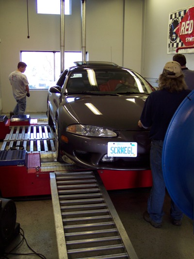

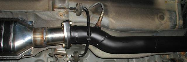

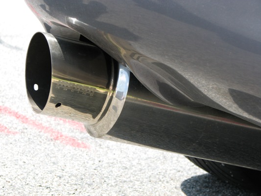

I had another opportunity to have some more work done to the car so the next thing I couldn't tackle myself was the exhaust. I worked with MAP again to plan for the future and decided to go 3".
Kyle fabbed up a great system putting in a 3" Megan Racing Down Pipe, 3" Magnaflow High Flow Cat, and 3" Custom Cat-Back to a 3" inlet - 4" Outlet Megan Racing Muffler.
I am starting to get used to the exhaust and it has a great Deep tone to it but around town it is a bit on the Ricey side due to volume and drone but definitely worth the pay off. It did throw a CEL for about the next 100 miles then after a ECU reset is now fine.

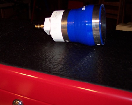

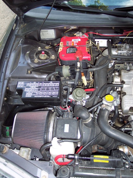

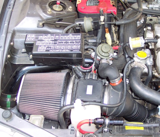

Well I finally got around to getting some more basics done. I needed to do a boost leak test, cut the bov tube in the intake pipe, and add a cheap "catch can" from the valve cover.
I built a rigged boost leak tester with random parts I had thanks to Home Depot, Checker Auto, and Northern Tool. I was able to test to 20psi before the tester popped off and I buttoned up some minor items.
While I had the air filter and intake pipe off I cut the inner BOV Tube to help things breath easier. The BOV sounds a little nicer now too as an added plus.
I also added a Fram G2 fuel filter as a "catch can". There was a fair amount of oil getting into the intake so I cleaned things up and added this. I should probably pull the side mount and clean that out soon too.

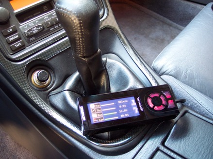

After getting some basics done I wired in an AFC NEO.
Now I know DSM Link is like the bible around here but the NEO is an affordable option for where I am at with the project. MAP got me a great deal on it so it was a too good to pass up.
The install was easy and the directions provided were accurate. I think it will be a good platform to learn from and it has more set points than past models. I do not have any corrections set yet so that will be the fun part and I'd like to get a wideband soon to replace Blinky. One step at a time I guess.
