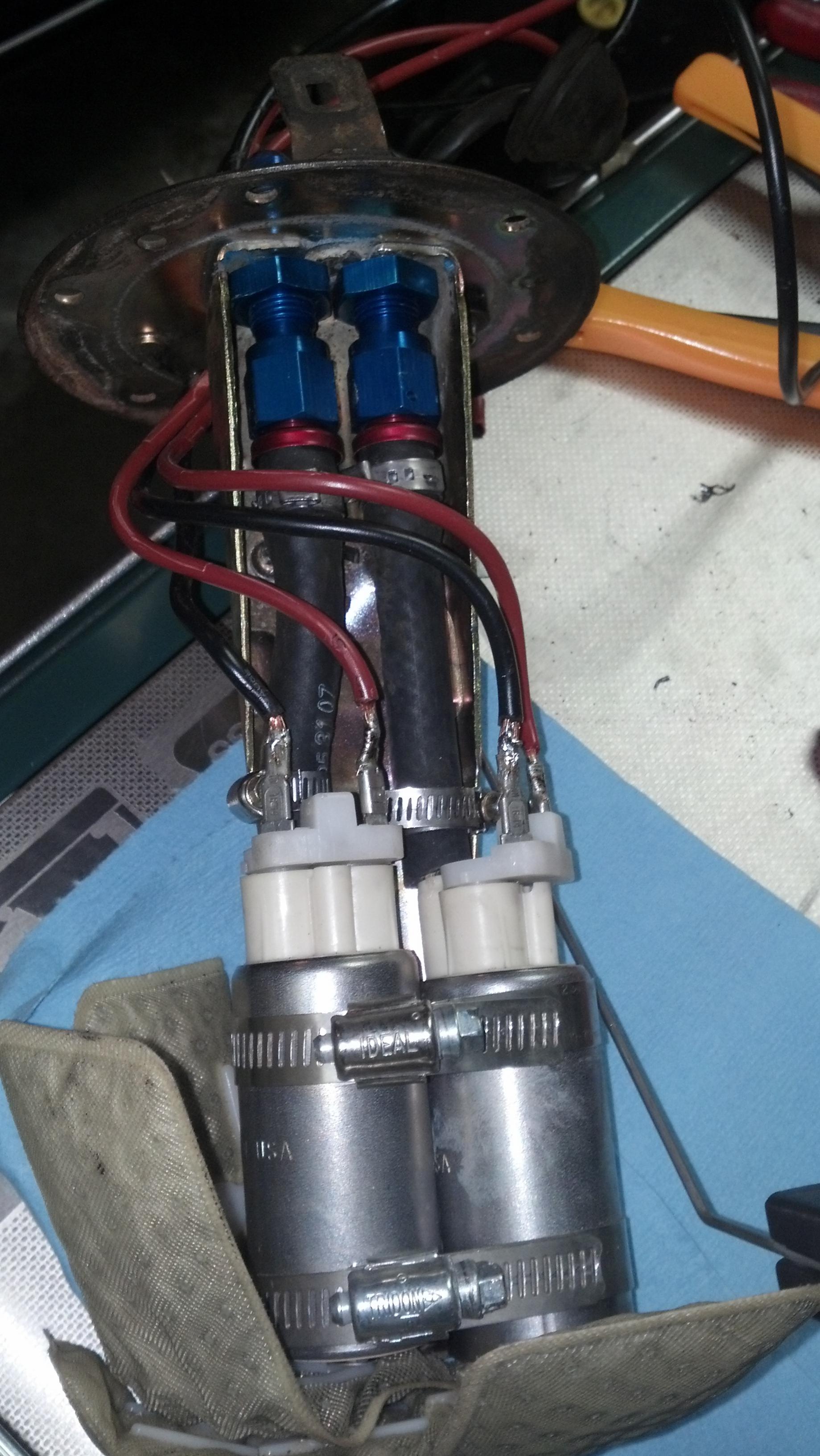

Yea 1g has a ton more room to work with, you could fit them both.

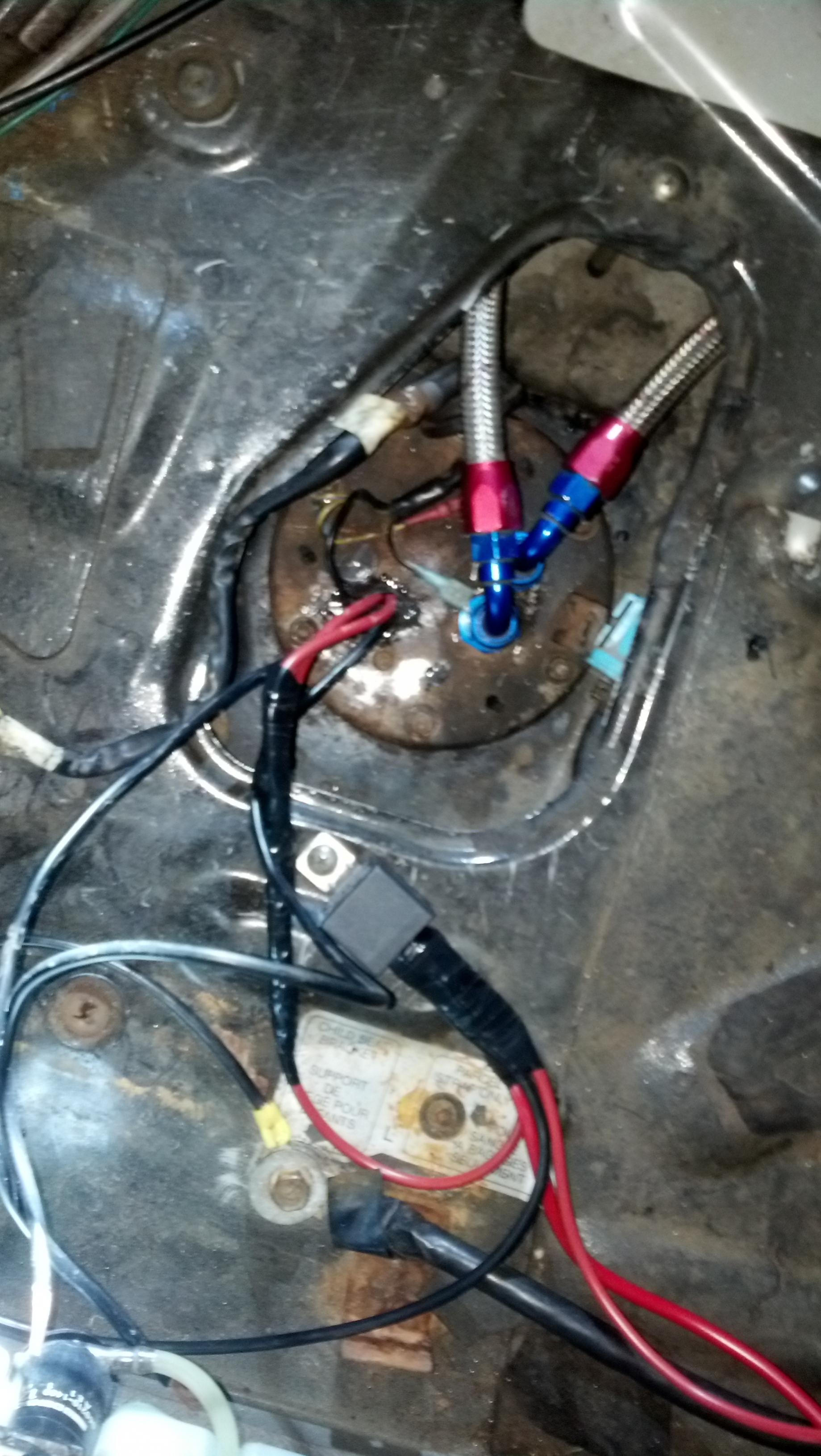

Not sure I'm completely following what he did. Its late lol. Here's a pic of my hanger. So if I don't do the bap dual 450s or maybe even cut the difference between the 450s and 310s and do the walbro 400 since it's quite a bit cheaper than the 450. Idk lol
