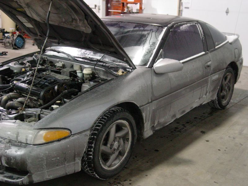

Here it is. The ghetto cruiser, highway only racer(since it won't shift into 2nd or 3rd worth a crap) and salt collector.
Winner of numerous Rock Falls trophies
Winner of the 2001 Buschur Racing DSM Shootout Home Depot Award
It used to only get hand-me-down parts and crap built out of whatever was laying around, but the last couple years it has received a bunch of new parts.
Went 12s on the stock 14B turbo back-in-the-day with no fuel controller. It has remained in the 12s since then.

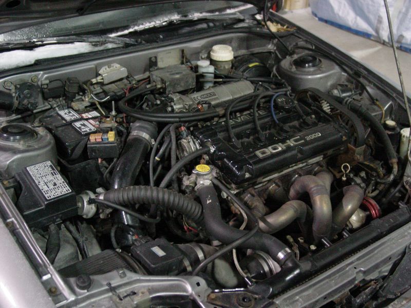

Notice the 2 different kinds of plug wires.
The intake setup goes 4" from the 2G MAS to a 4" -> 3" reducer to a 3" pipe to a 3" -> 4" reducer to the 4" inlet on the turbo.
Fancy NAPA flexy 2' BOV return pipe.

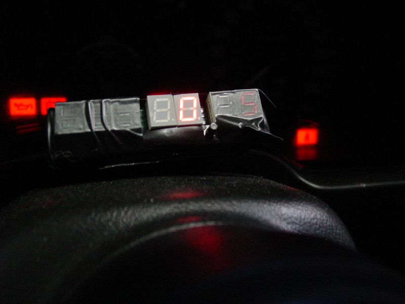

Knock monitor covered in black tape and jammed into the steering column. The brighter middle number displays knock, the right number displays timing advance.
