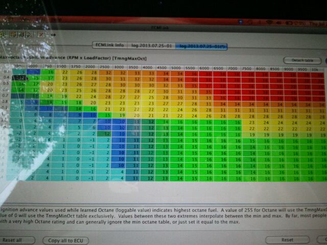

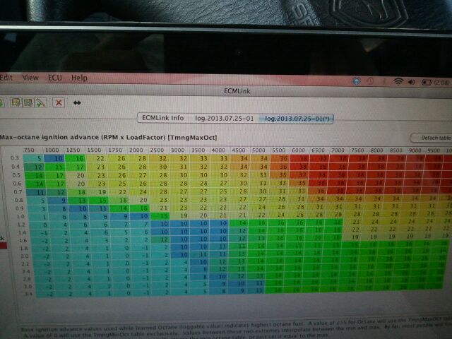

E85 Timing
What does a good (smooth) timing table look like? I have some examples. This is for E85
