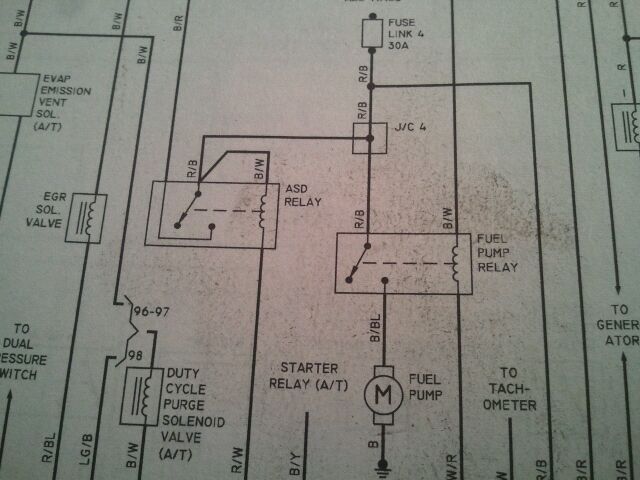

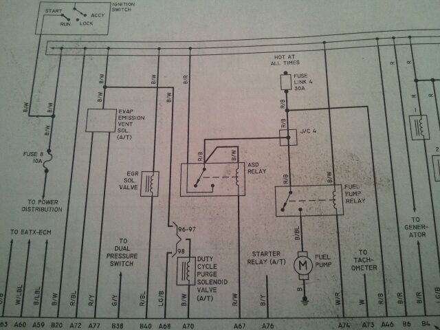

Here's what I know: Key on
ASD Relay:
B/R going to ASD relay has no power
R/B leaving ASD has power
B/W leaving ASD has power
R/W from ASD to PCM has power
Fuel Pump Relay:
R/B has power
B/W has power
W/R has power
B/BL to fuel pump has no power
ID:	14284   Click image for larger version

Alight so I noticed something, not sure if they are connected or not but the main fuse wont pop until I put the ignition switch fuse in. Once both are in it pops the main one.
