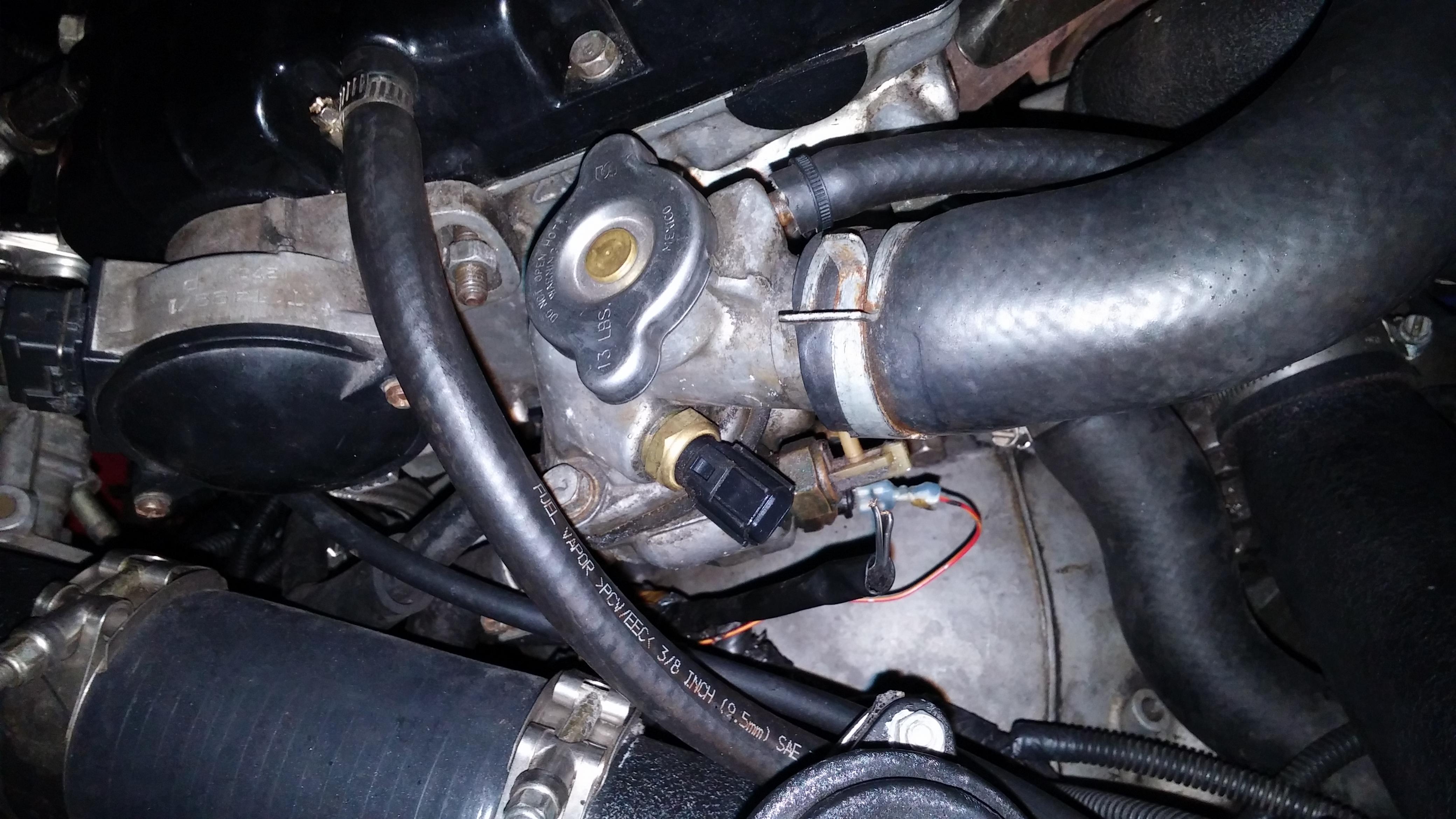

Location: Blaine, Mn
Drives: Racecars
Posts: 679
Re: Will not cold start
Okay then any temp sensor pigtail...
Heres a pic to make sure im explaining this enough.

So th plug that plugs into the black connector right ontop of the water neck has the two wires out of it somehow.
But that is the temp sensor correct ?!?!?
Tyler
2011 Subaru Sti 11.0 @135mph
Old 12-10-2014   #16
that would the one.

Perfect now just need a pigtail and thank you.
