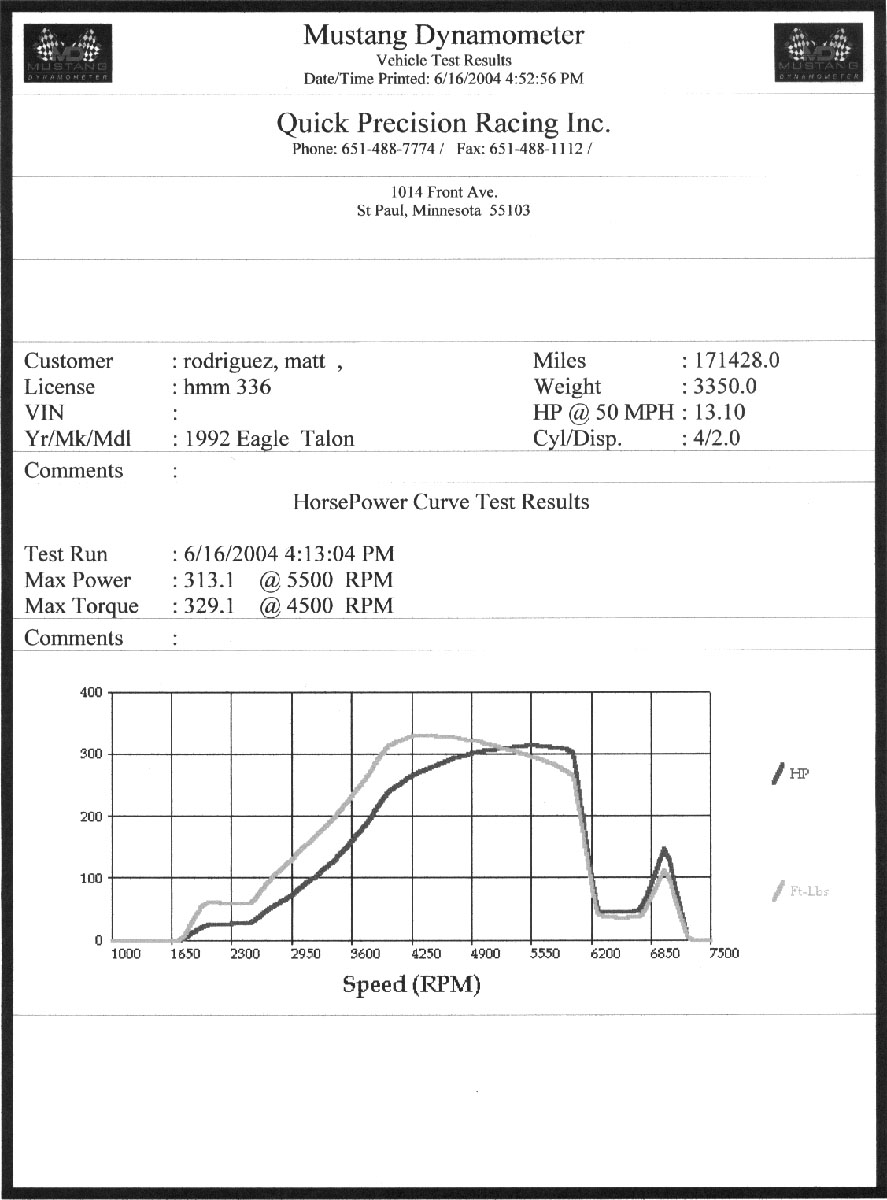

He wanted to dyno on the AWD dyno to see what he was putting down and get it tuned up a bit. 1/8 tank of 92 octane and about 4 gallons of 110. EVO 3 16G, QPR FMIC, and QPR headwork. I will let him fill in the other mods as I am not too sure off hand.
Good numbers Matt! And thanks for letting me post this up. So we should mention the bottem end is bone stock and has 171k on it. LOL

Ron at Propulshun also said the RPM numbers are off +/- a couple hundred. The dyno was calibrated to the car at 3000RPM engine speed in 3rd gear because the inductive pickup for the tach signal was topping out at 13000RPM for some reason. It was neat to see an AWD dyno in action, and a 170,000 mile engine spraying oil all over under the hood.

yeah evo 16g's rock , having enough fuel to make me happy is even better!
congrats matt, and happy b-day.
and numnuts, it was 4 gallons of 100 unleaded mixed in! not 110.

How much boost was this on?

This was that highest boost pull of all of them. It stayed around 27psi until about 6K rpm when it came back down to about 22-24 psi.

ported intake mani, head, 2g exhaust mani, phenlic resin spacer, fmic, piping, cai, balance shaft removal, and some other stuff.
not bad for 171k lower end that doesn't like oil!

Nice, but boost levels were kinda high; but regardless, good enough numbers.

yeah, around 23ish psi it made like 308whp, just upped it to get over 310 . I think the cars next step is maybe a larger turbo , fresher lower end, cams, sheetmetal.

nice numbers for sure, though i do wonder what you wuold have gotten had you run on elites dyno since that would make it easier to compare.

Probably close to 400whp. Once he takes it to the track and we can see some trap times it will be easier to compare.
