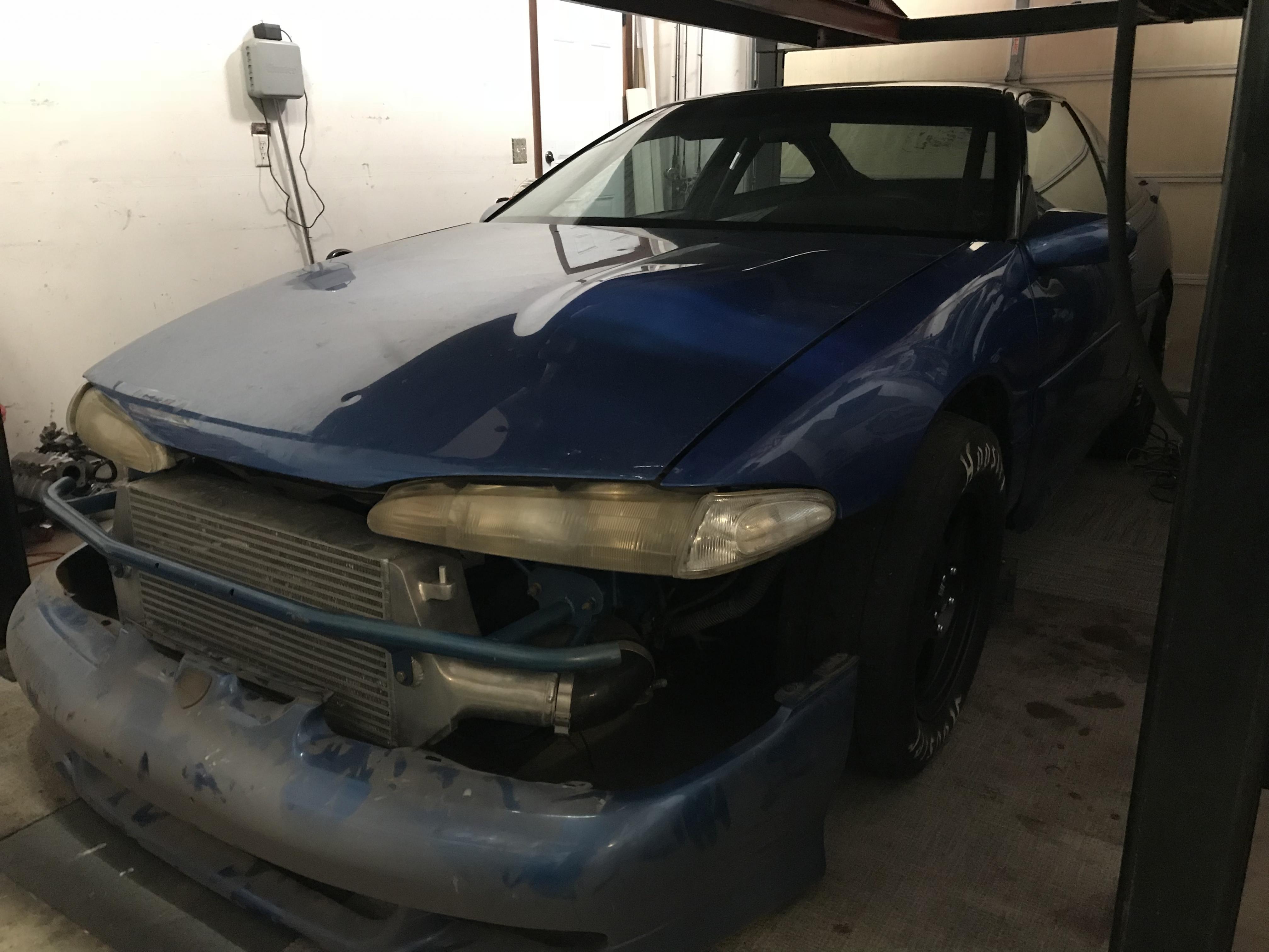

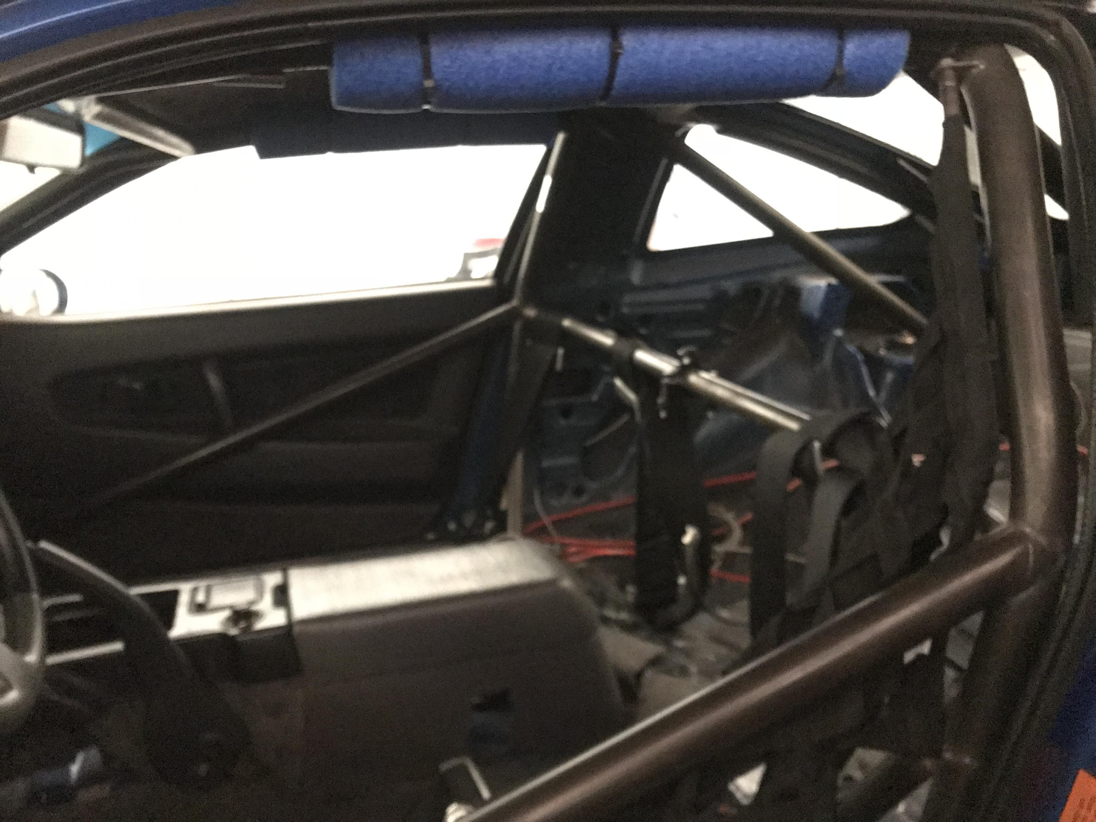

So as most of you have seen I started a build thread for the red 2g that we picked up not long ago. My girlfriend decided to keep and finish that 16g build and drive it so that left me car-less which made me on the look out for a car. Didnt take long before I got the chance to take a look at and buy this 93 1gb talon. Some of you may recognize it but it used to be map’s old 1g from what i hear, it has a full certified cage with a tubed front end ready to go. I could not be more excited to have a awsome base to build off of and get this thing going. I have thrown a little list together of parts i will forsure be getting but for the most part im still at the drawing board. The list will change and get bigger as i dig into the car more
Engine :
Built aluminum rod 6 bolt shortblock
Built 7 bolt head
Gsc s3 cams
Magnus intake manifold
Drivetrain/suspension
Ppg dogbox
Driveshaft shop axles
Boostin performance built tcase
Quart master triple disk
Frontline fab diff cover / bearing caps
Bulfab mustache bar
Bulfab 1 peice front crossmember
D2 drag coilovers
Turbo:
Pte gen2 6062
Jmfab manifold
Fuel:
Jmfab fuel cell
Fic 2150s fuel injectors
Fuel pump ( mechanical) ?!?

Oh cool; you bought it from Cam.

I did indeed !!
