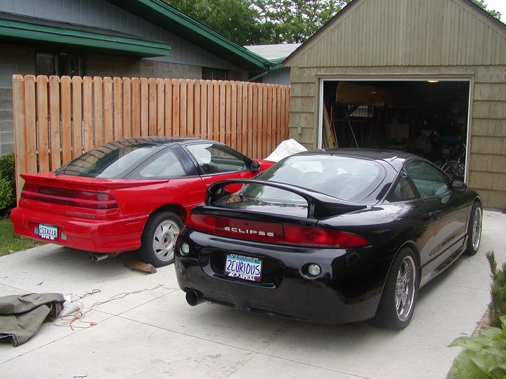

Yeah my 90 is broke, that is my daily driver/ winter beater. MY 2g runs great right now, but I can't legally drive it so im screwed anyways.
2 DSM Households rock! ..... as long as you dont have anywhere your supposed to be at any certain time.
