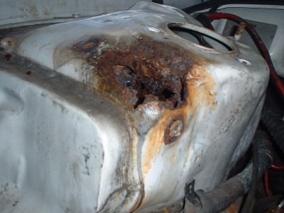

Wanna see MY strut tower? Car is from CT. LOL, I got the part from a dealer on order, gettin it in 2 days, and I'm told $100 to $200 to repair, i dunno.

SuperSleeper
SuperSleeper's Avatar
Location: Apple Valley, MN
Drives: 2012 Audi S4
Posts: 860
Re: FWD/AWD differences
That is disgusting! lol
Old 02-09-2005   #16
Wow thats unbeleivable. 2G's suck. My car has been driven through every winter except this year and it never had that kind of rust. There is not a spec of rust under the hood.
The best part is this. Look at your 2gs. Around the camber nuts...thats NOT a weld. Its body filler painted over. The 'pipe' your upper camber runs thru is NOT attatched to the strut tower, just the bottom is. The top has body filler around it so it doesnt move around much. I will have all 4 of mine welded to the car for more rigidity.
