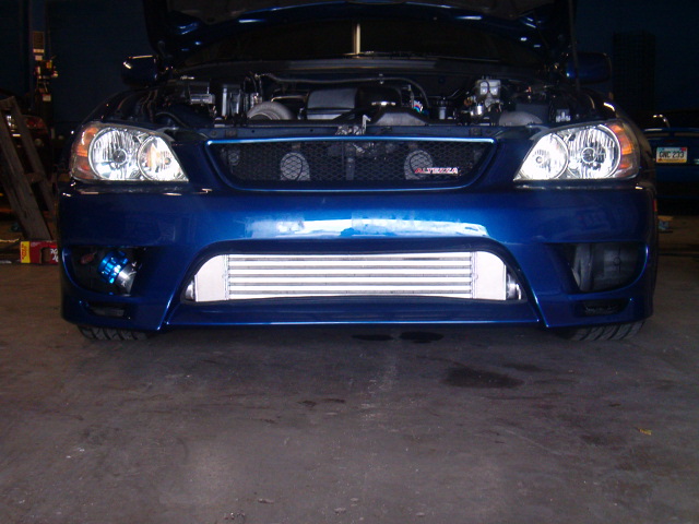

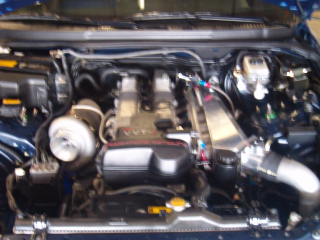

Well finally got all the fabrication complete. Aluminum IC piping, sheetmetal intake manifold, 3" SS downpipe, all built in house.
Pics are kinda fuzzy but you get the idea.

F-ing ballin! whats the specs on ze turbee? t67?

It's a GT40.

Suhhhweet! Been to the dyno yet with it? What are you doing for fuel delivery/management?

No dyno yet, but looking for ~500whp on about 15psi. For fuel im using walbro pump, FIC injectors, SX regulator and Haltech E6X for managment.

are you going to start selling that intake mani to poopra owners as well?

Idk when i'll be 100% finished, no hurry now being it seems its gonna snow anyday. The intake has a different TB placement then the supra being i had to work around the PS resevoir.
