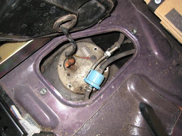

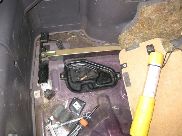

- Pump is located in the rear hatch on the drivers side. Begin by removing the electrical plug, and the 2 screws holding the black cover down.

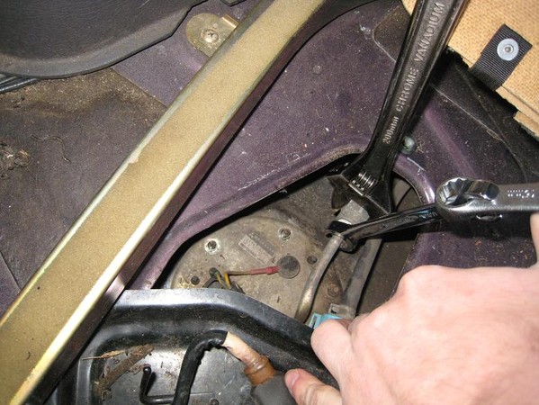

- Next, using a 14mm flare wrench (important because using a standard open end wrench may cause you to strip the fitting), disconnect the fuel feed line.
- With the fuel line disconnected, using an 8mm socket, remove the 6 nuts holding the fuel sending unit down.

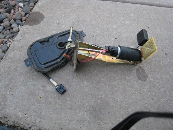

- Remove the fuel sending unit

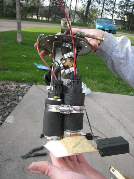

- I had a second fuel sending unit as my original one had a broken power terminal. Cut approximately where the red lines are. This simply allowed the pumps to sit a little nicer against the sending unit. And cutting the output tube will allow you to attach a normal fuel line to it.
- Attach a Y (I just used a barbed T from Ace), and attach high pressure fuel line with clamps. Clamp the fuel pumps to the fuel sending unit using a worm clamp. You can use 2 if you don't feel that 1 is enough. Land both the ground wires at the grounding point on the fuel sending unit. Land both the positive wires to the power stud on the bottom of the top plate.

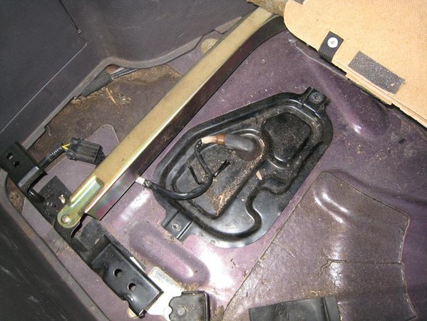

- Reinstall the fuel pump assembly. It is all simply the reverse of the removal.
