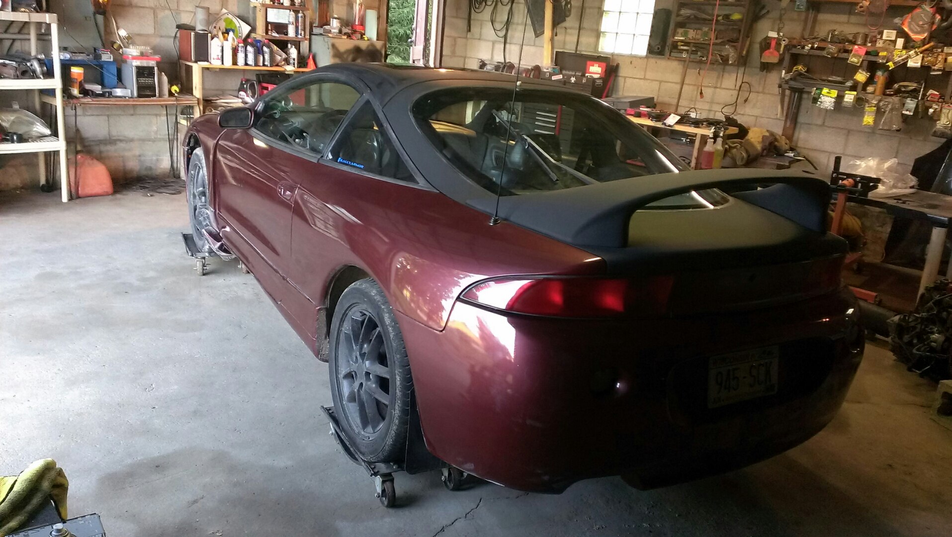

I figured I would finally make a project thread. I've met a lot of you guys while working on this car. it has been a uphill climb all the way. I found the car in Milwaukee. the guy had it for sale for around 2500. he had it "painted" took the engine out to do the timing job, then never was able to get it running so he decided to sell it. [/LEFT]
turns out his "mint no rust" description was far from the truth.
I ended up picking it up for 1200$
it came with:
3 turbos.
wideband
3 inch exhaust
what made me want the car was it was mostly untouched and from the pictures looked a lot cleaner then what it was in person.
so I sold my old rust free 99 gst. kept the 2.3 motor (eagle rods/cp pistons)
would love to hear your guys comments and tips and tricks

began the tare down and process to paint my gsx. all I had to do to get that motor running by the way was reconnect the starter relay
went with 2 stage. all in all was 188$ shipped to the door.
that's the finished product.
then the very next day, the unthinkable happened!
M1L3S is offline   Reply With Quote
