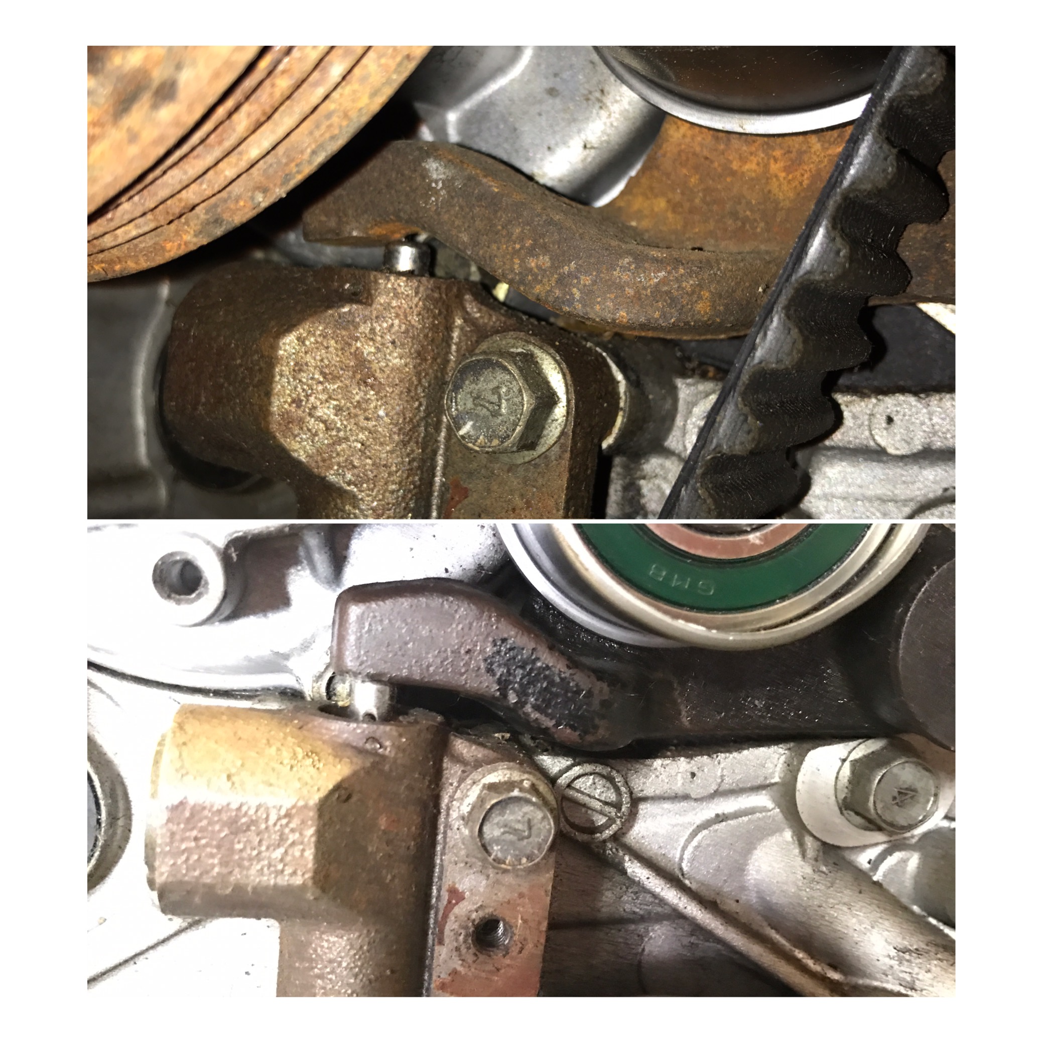

Got the bay cleaned up. Here's a before and after.. should be going back together shortly.

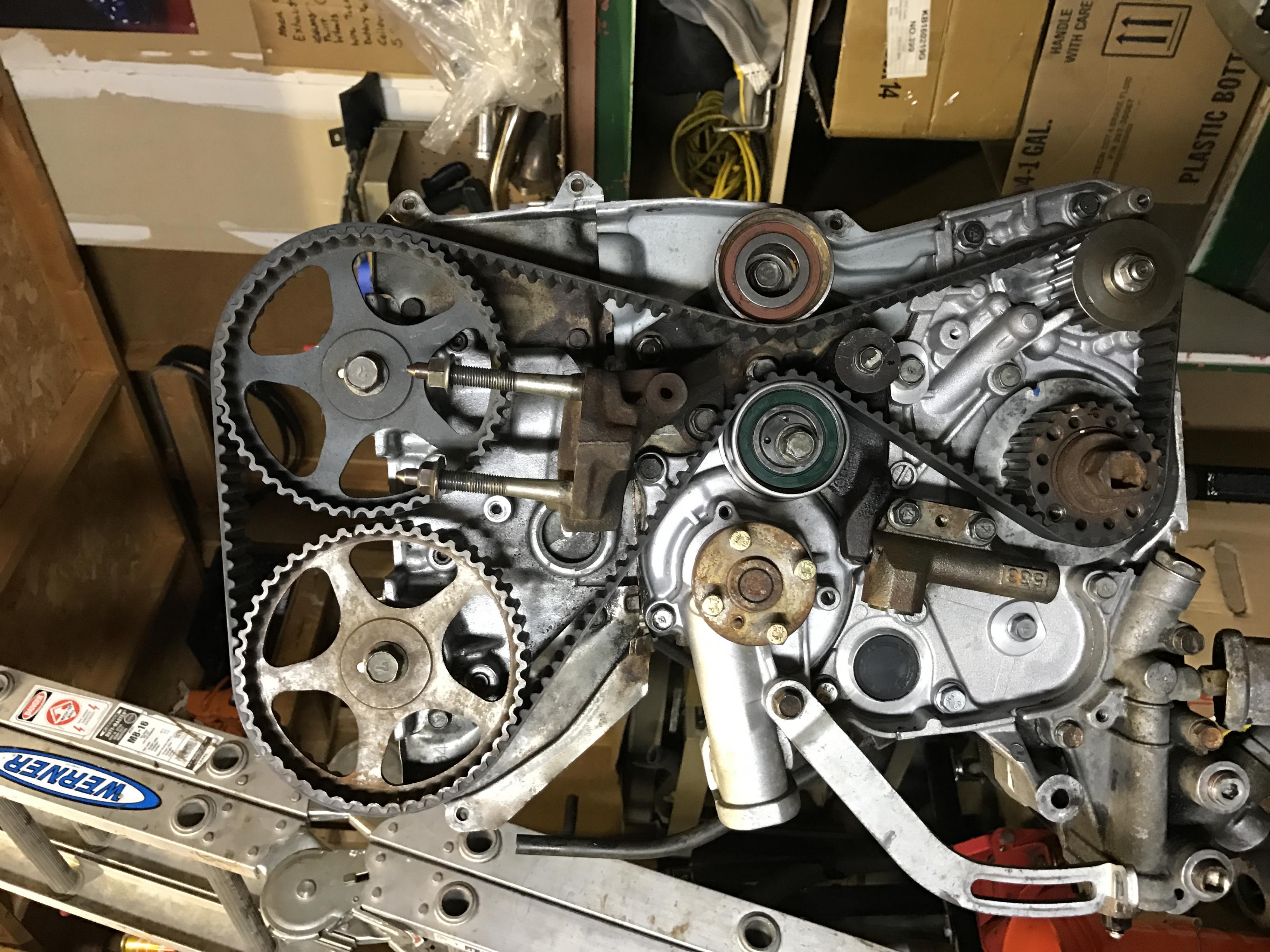

Tore the engine apart after finding that the previous owner left the oil pump gear bolt loose along with numerous others and finding he used the wrong tensioner arm when he did the 6 bolt swap, I felt it was necessary. About to go through the head and relap the valves and swap the cam gears back to the stock ones.

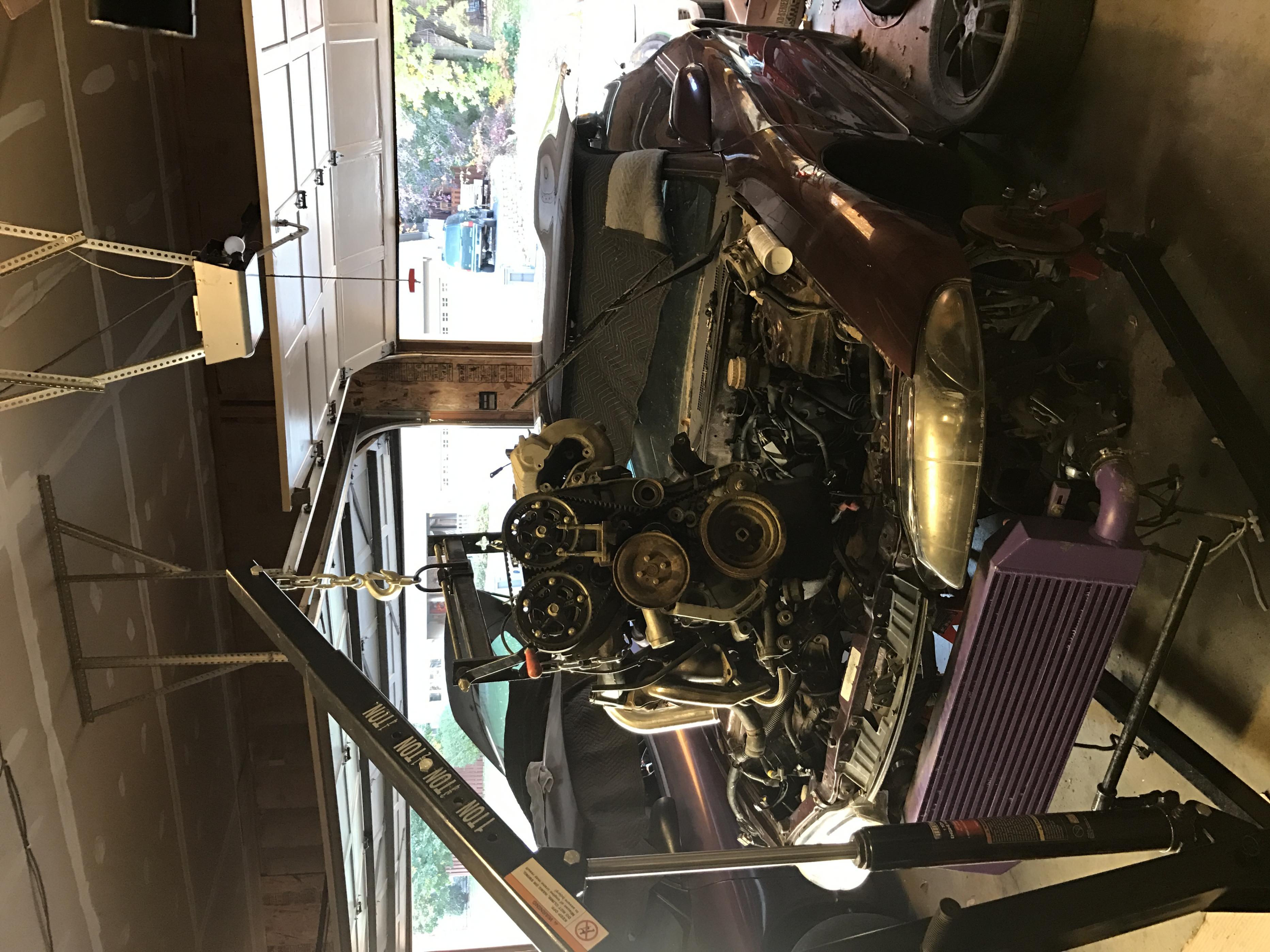

Got the engine back together.. should be going back in this week.

Re: 97 GSX -The Rebuild
Put a straight edge on your cam gears and line up the marks with the center of the bolts, your marks look off a bit. The belt tension looks a bit tight as well, but that might loosen up once you rotate it several times.

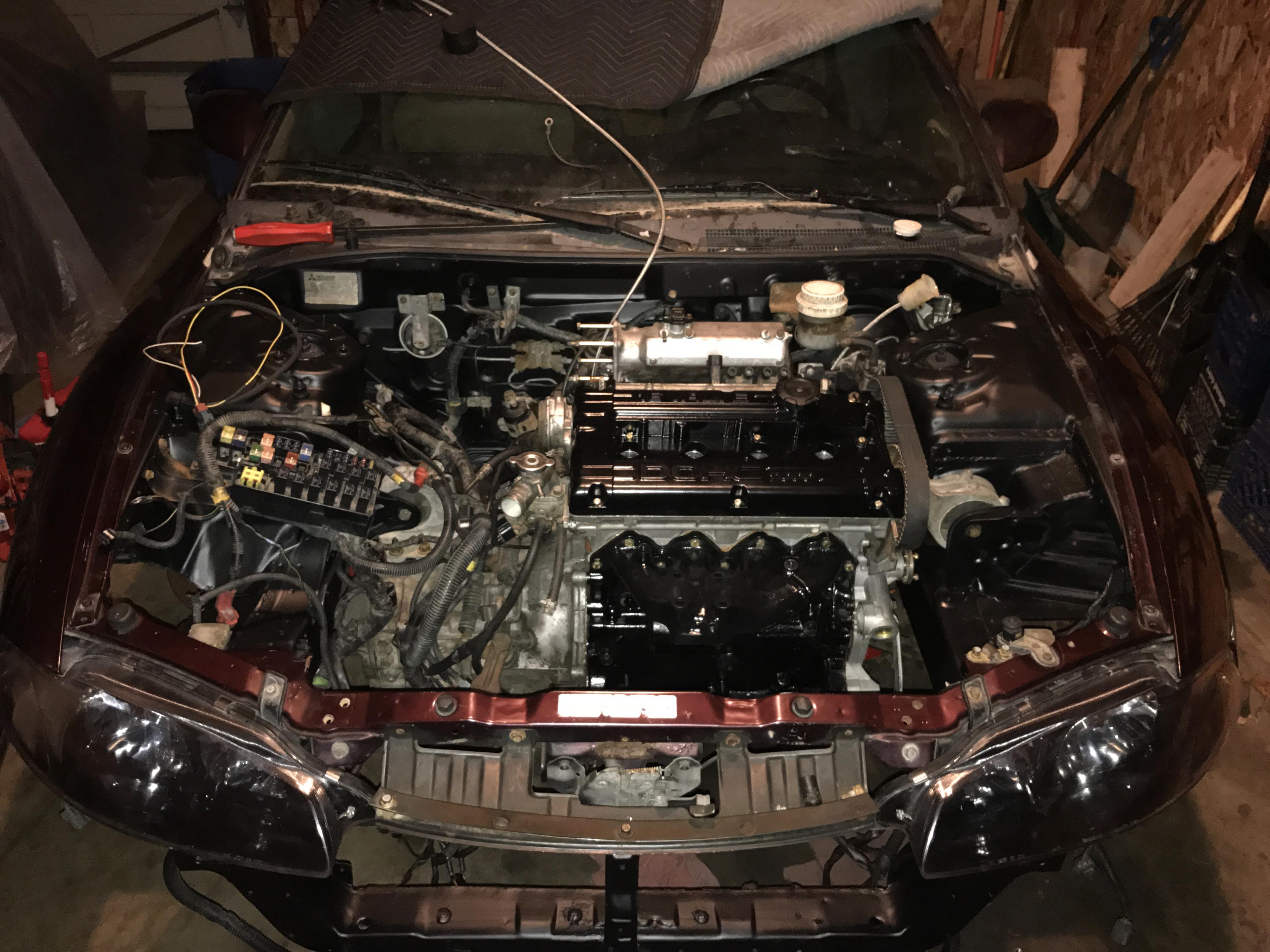

Painting the engine bay flat black.. buddy of mine that is going to buy it decided on the color.

Here are some better pics. I think I will be ok, only thing I could see would cause misalignment would be that I'm using two of the same gears. I did read and ask a few people if it would work and all said yes. Let me know what you guys think tho!
Your bottom marks are fine but your top isn't. Check it with a ruler, I guarantee you're one tooth off.
Same gear doesn't matter, they're marked on both sides to be universal, at least on 1g's, 2g's had the cam position sensor I believe.
