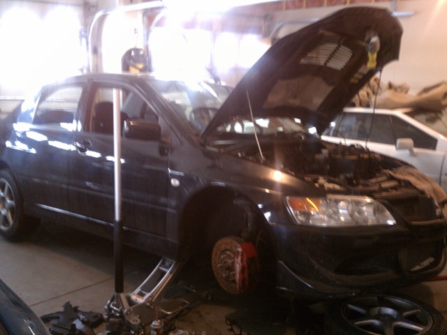

Sure, here's it's current state, and as suggested by Carl, a full shot with my collection, all cleaned up ready for the show circuit.
ID:	11247   Click image for larger version
