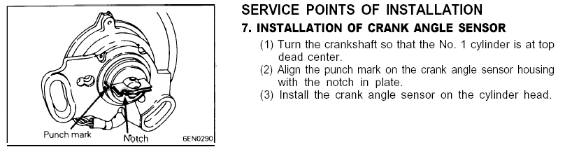

Originally Posted by Hollywood View Post
I thought 6 bolt motors didn't have crank angle sensors? Just cam angle?
That's the cam angle sensor. Just ignore the crank word in that picture. But that's how you install the CAS.
