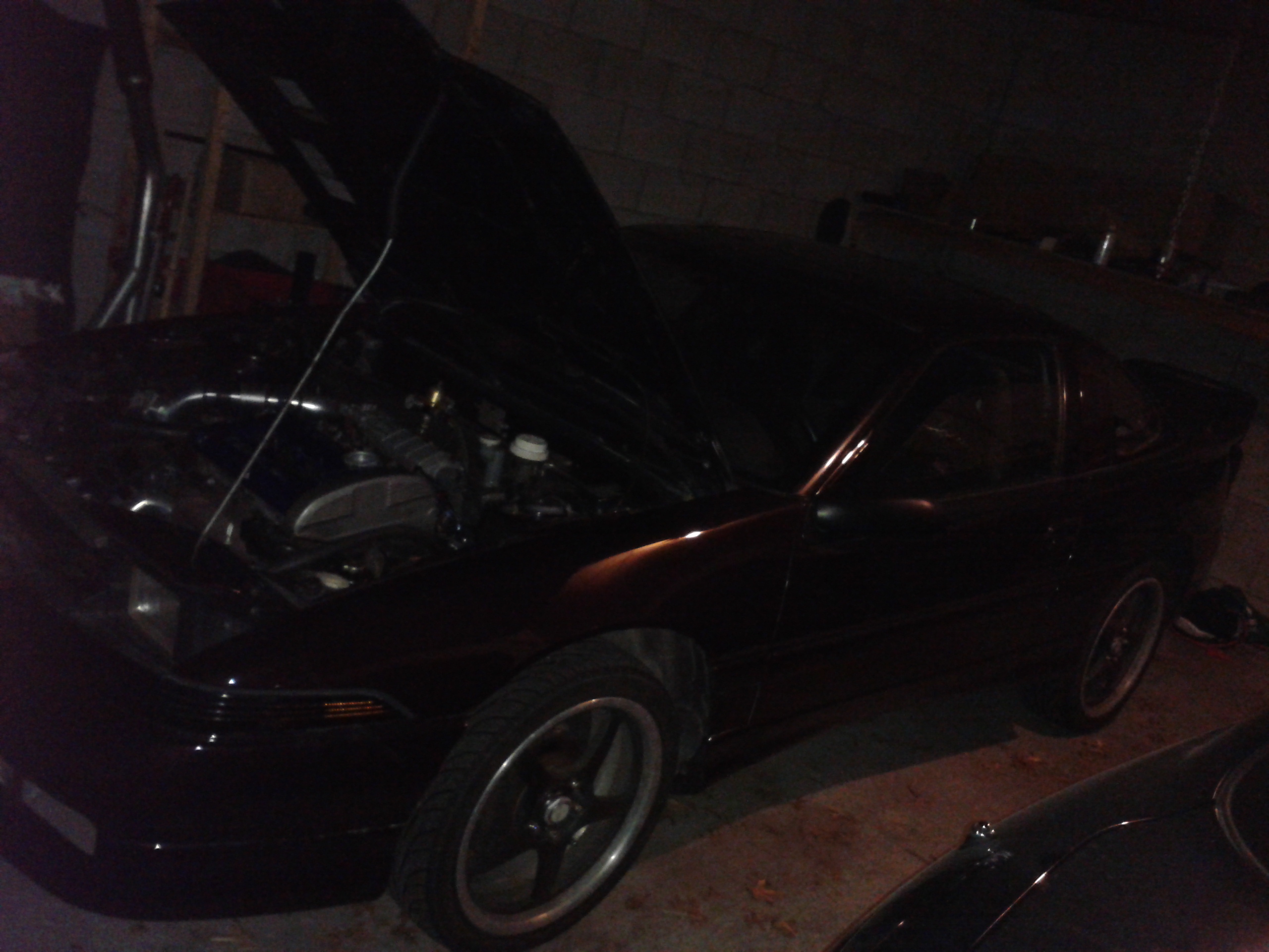

Here are some more i took just tonight. obviously after buying the car back
also i did the wire tuck around the fuel rail the day before selling the car.
Gotta say, even with all the problems these damn cars have. i sure did miss it.
Will also be grabbing some more tomorrow when the light is better. there isnt shit for lighting in my garage.
