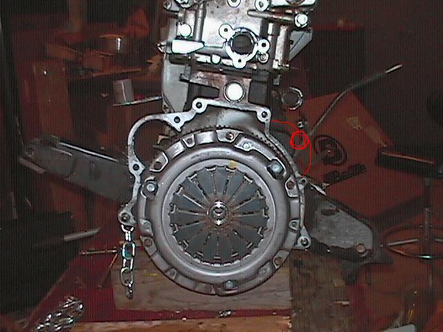

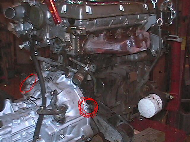

Cutting it worked, but I suck at cutting since all I have is hedge trimmers. Turns out I just needed to break little sections off and since its so cold out pliers actually worked nice to snip off sections. I also had to cut out the bottom left corner since it has a custom front-facing oil filter housing that got in the way a little. But now the timing belt cover is on, water pump is hooked up with alternator belt on too. However, I noticed the pulley on the crank rubs a tiny bit on the timing belt cover, is that ok? Not the belts, but the back of the pulley itself.
Also, I noticed the shape of the two blocks is a little different where it meets the tranny. I have a bolt leftover, and it looks like there is an extra bolt spot on a 2g that's not there on this one. The right circle in red is what I'm talking about. On the 6 bolt it seems like there are only 3 bolts to hook up, and on my 2g there were 4. In the clutch picture I drew a red line where my 2g starter plate is bigger than the 6 bolt one, and also a circle where that extra bolt would go. I also noticed a couple holes on the left (next to where the starter goes, where the left circle is in the first pic) that don't seem to go to anything... I should have taken more pictures when taking it apart.

That bolt hole in the front is an extra, don't forget to put the bolt on from the back side of the tranny, the smaller one. There should be 4 bolts holding the tranny on. The small bolt goes through the middle of the back dowel pin.
Trash the intake mani brace, just extra weight.
