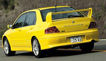

I'm looking at options for painting my tails to make them JDM Evo VII style, and stumbled across this stuff:
I was straying away from paint because everyone I talked to said that they ended up looking pinkish. Well with that paint above, someone got these results:
Not half bad, very nice red color! But my main concern is, how will a paint like this hold up to daily use on a car?

I think you should paint the red stripes over the turn signals. I think it makes that taillight look more complete, even though it would prob be alot more work.

had to just attach the pictures at work..
