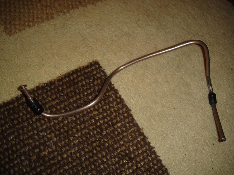

This is the fuel tank evap line that went into the charcoal canister which is now under my workbench never to be installed again. I cut this line back so it ends underneath the car. May do something more with that later but it's fine for now.
So here you can see that evap line that I removed. Also that is where the stock ABS and charcoal canister used to be, so I have a nice big empty corner there now

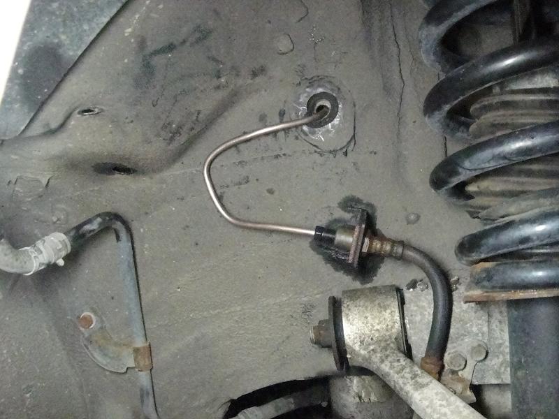

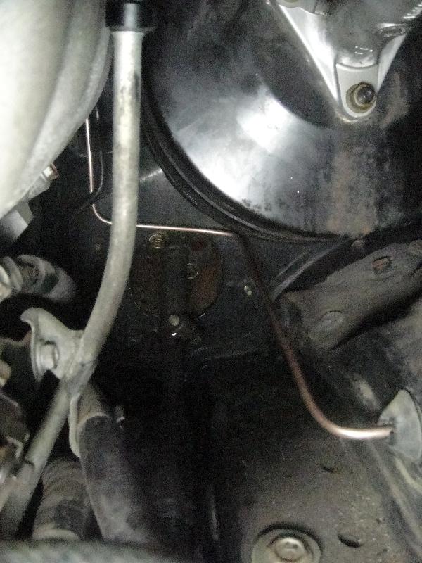

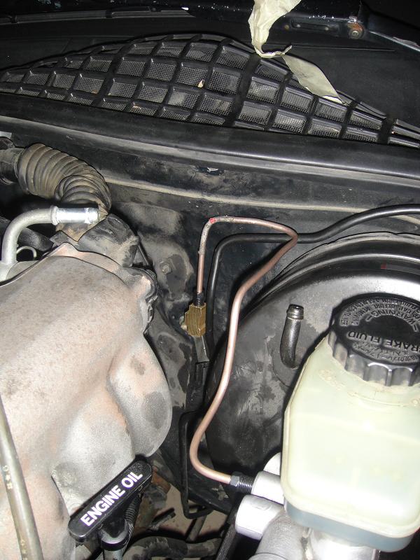

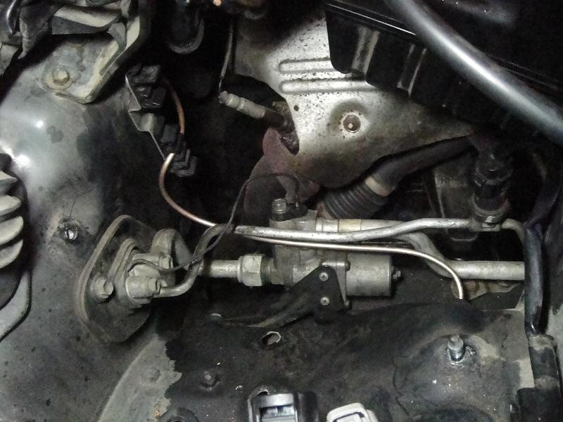

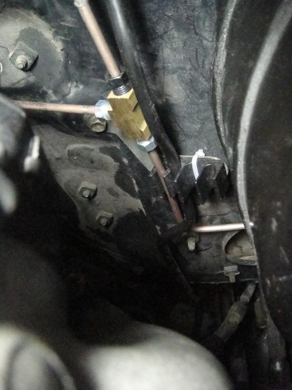

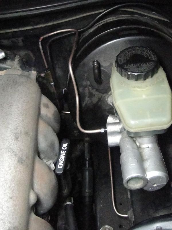

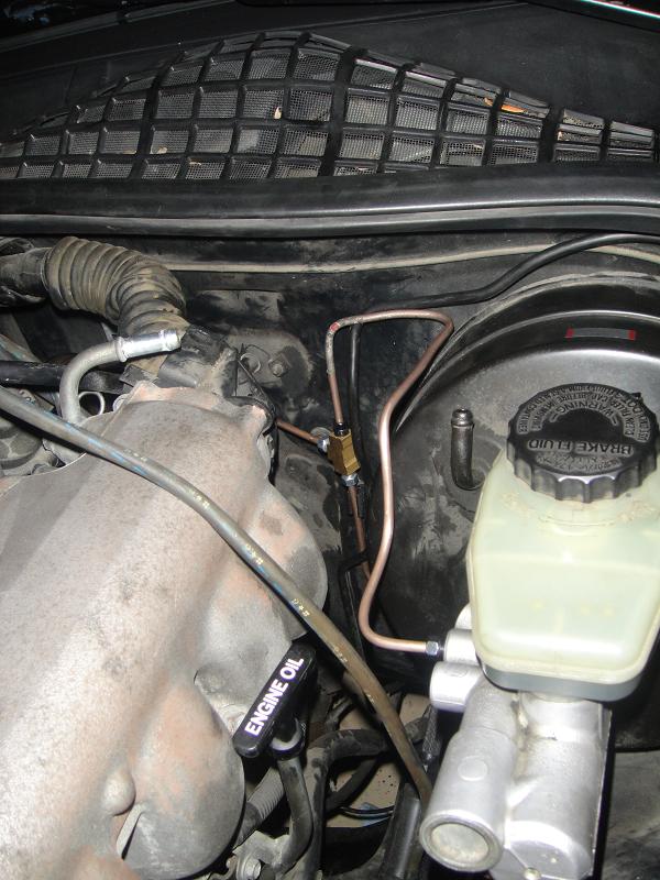

Front brake lines are all mocked up. All I need to do is some flaring which I think is going to suck, haha. Here's some pics, showing how the line is routed.
The line from the bottom of the Tee, coming down then bent right under the brake booster, then bent straight again to continue going towards the front of the car
Same bend as shown above, but from further back so you can see the last bend that takes it through the gromet and into the fender well
Drv Side Fender Well, mating to the stock flex line that goes to the caliper

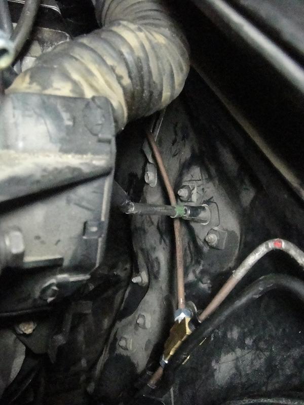

Back to the Tee, showing the line that runs along the firewall towards the passenger side

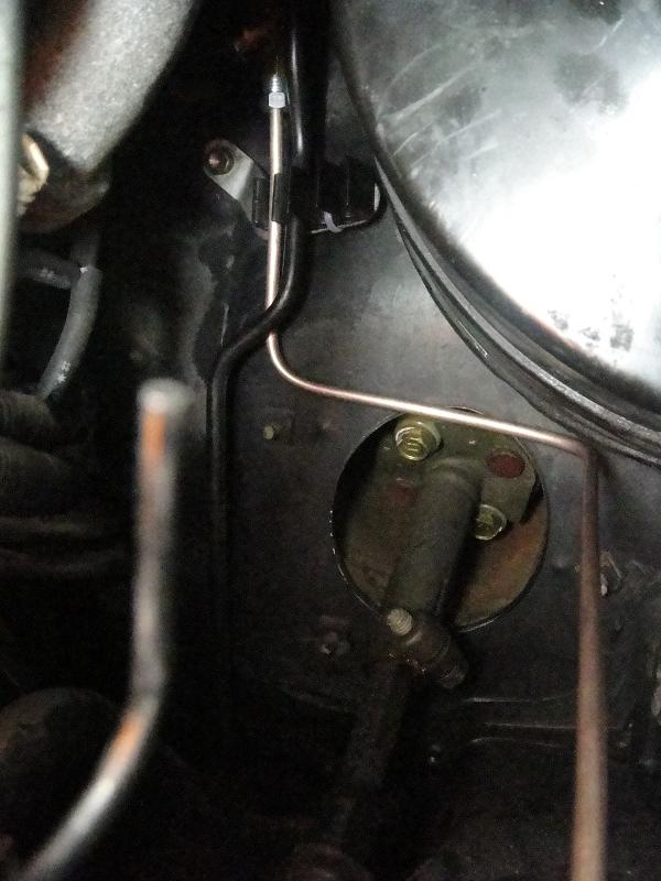

Line along the firewall, now on the passenger side.
Showing the bends that take it into the fender well
Pass side fender well.

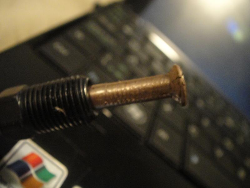

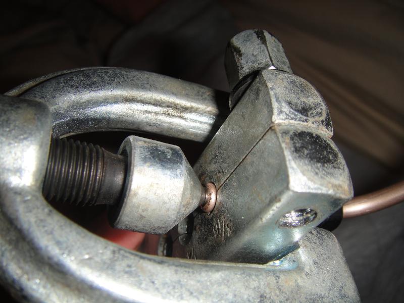

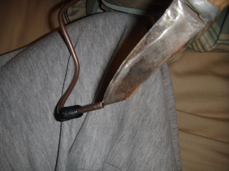

Didn't have much time today, but was able to go to my cousins today and borrow his flaring tool. I removed that first upper line and decided to just give this flaring tool a shot while laying in bed. One end was already flared, so I only had to flare one end. So here's my pics of the process of applying a double flare to the line. Was pretty simple, and took only a couple minutes. Turned out just fine it looks like. I suppose the real test will be once it's installed and hopefully doesn't leak.
Break out your professional deburring tool:
Use the die to measure the correct amount of line is protruding out of the clamp
First flare created with the die
Use cone to make the double flare
Double flare done

Thanks for all the kind words! And yeah my first time delving into brake lines as well. Really not that tough. Especially with this copper alloy line i'm using, they're very easy to bend. And the flaring was a sinch. But again, the true test will be when they are all hooked up, and see if they leak or not.

I thought for a second your flaring tool was the giant buck knife. That would have been skill to do a double flare with that.
Old 12-15-2010   #237
Re: Project Lex
Nah, just the deburring tool

I like all the rust on it, I wonder what else you use that for? hmmm...
