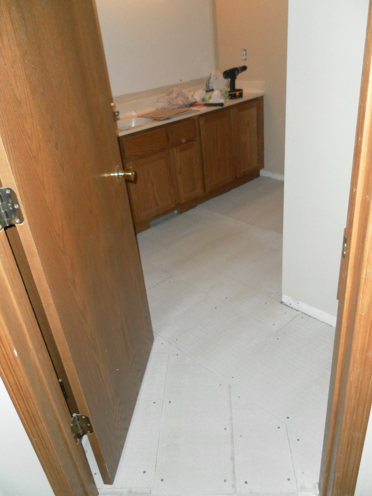

Old 03-21-2011   #308
Re: House Projects
Hardibacker is down using thinset and hardi screws.
I have some joint compound that I'll put on the seams later this week.
Money spent so far for anyone who cares:
- 3 sheets of Hardibacker = $30
- Thinset = free (from friend)
- Hardi screws = free (left overs from prior project)
- 12x12 Tile (qty=60) = $60
- Grout & sealer = free (left overs from prior project)
- Curved shower curtain rod = $10
- Shower curtain = $10
- Paint = $30 (used brushes I already had, so no cost there)
- Shower Head = $20
- Towel/TP holders = $50
- Light Fixture = $50
- Toilet = $3 (old toilet, but needed new Johnny Wax Ring)
- Carpet/Tile L-Bracket Transition = $10
TOTAL = $273

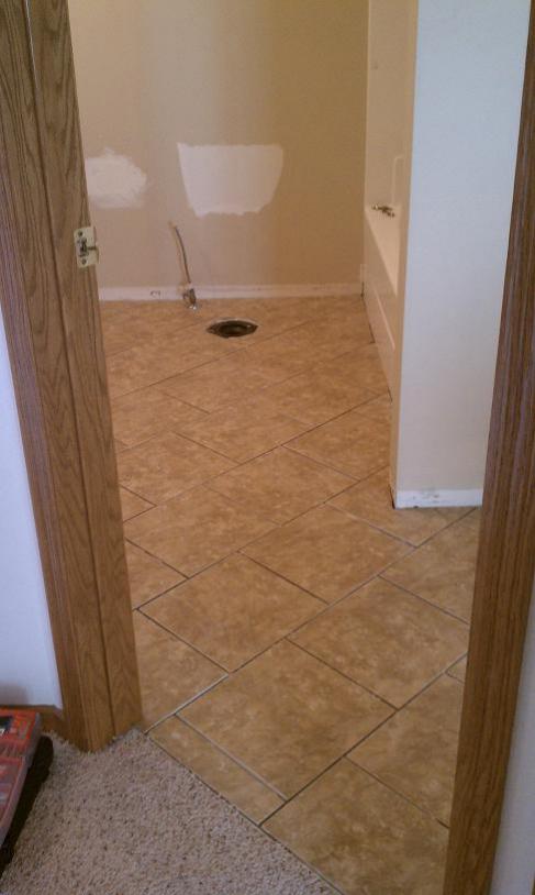

Old 09-08-2011   #313
Re: House Projects
My bathroom project has been on the back-burner most of the summer. I went to town the last couple days though. All the tile is laid. Depending on how I feel tomorrow, I will either start grouting, or start painting.

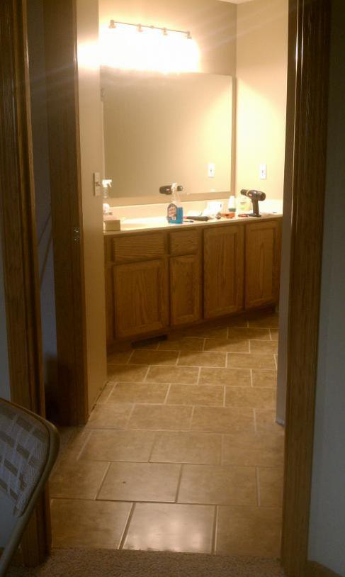

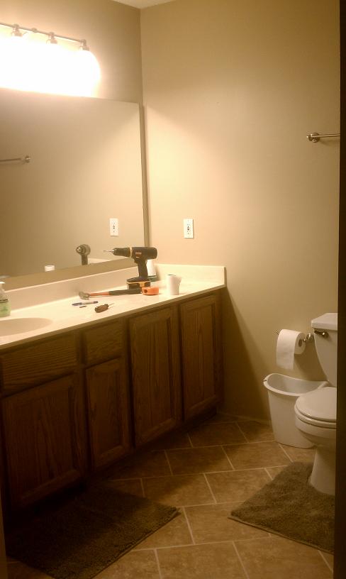

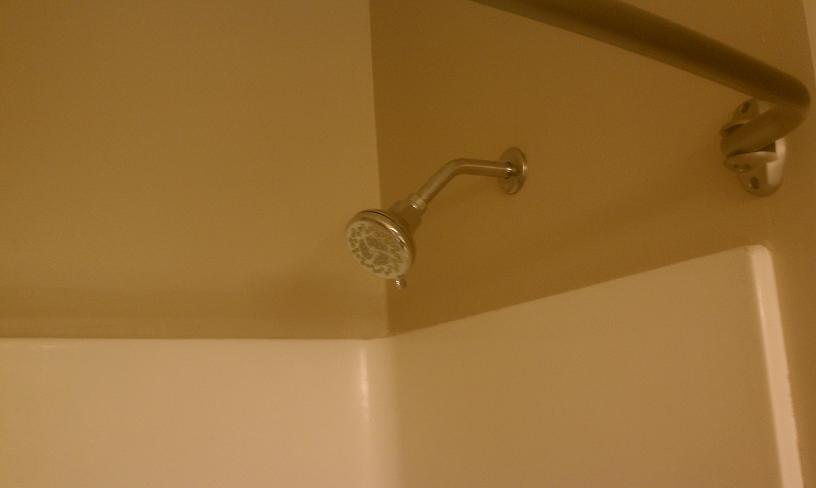

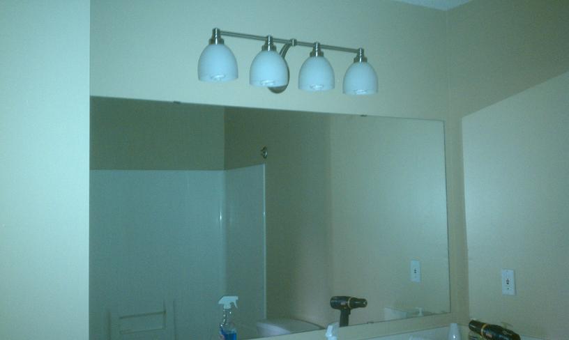

Old 09-13-2011   #318
Re: House Projects
Update on the bathroom.
Tile is done and grouted. Toilet installed. New curved shower curtain rod and curtain installed, makes it feel so much bigger inside!!. New Towel Rack, TP holder, and Hand Towel Ring installed. New light fixture (found it on Uber Sale at Menards) installed. Old mirror put back up. New shower head installed. Also just grabbed the old floor mats and towels from before and put them back in. It'd be nice to get new ones, but trying to stay on a tight budget here. Walls painted Hirshfields Stone House 1039 Super Spec.
That's it for now. What's left is:
- Seal Grout
- Reinstall doors (need to trim since tile sits higher than old floor)
- Reinstall Trim
- CLEAN
