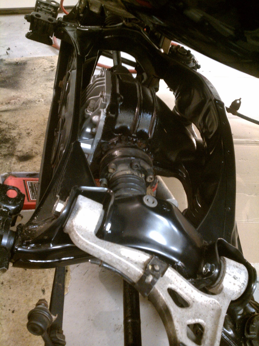

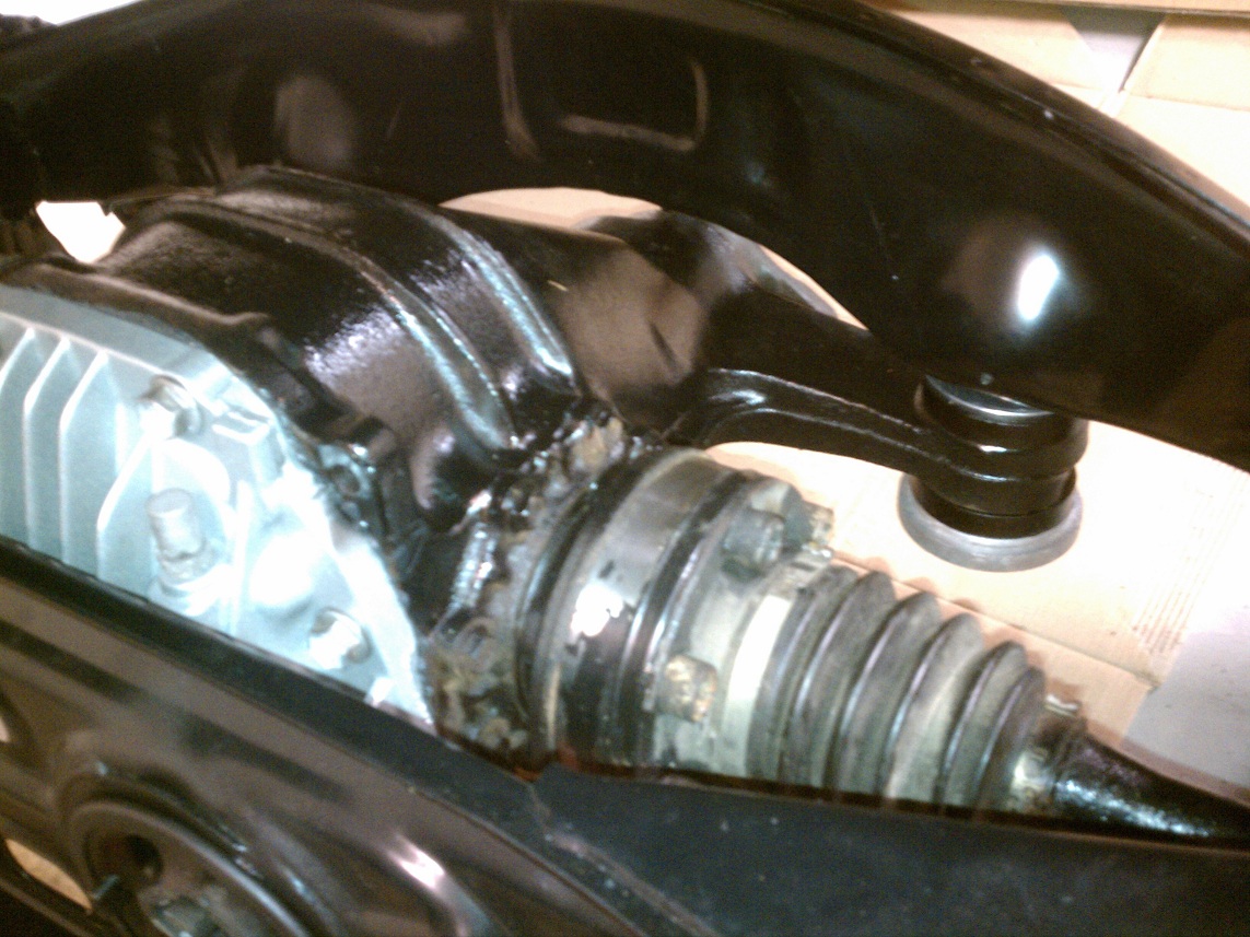

And some pics before it went in all put together. So nice and clean!
This one you can kinda see the cleaned up diff cover bolts, and the cleaned up diff to subframe mounting bolts. Details...
And last one shows the homemade poly diff ear bushings in place. Basically goes subframe, large washer, poly bushing 1, diff ear, poly bushing 2 (stock metal insert is reused in the middle), then the stock concave washer cleaned up with a coat of silver. Thanks again K-dog

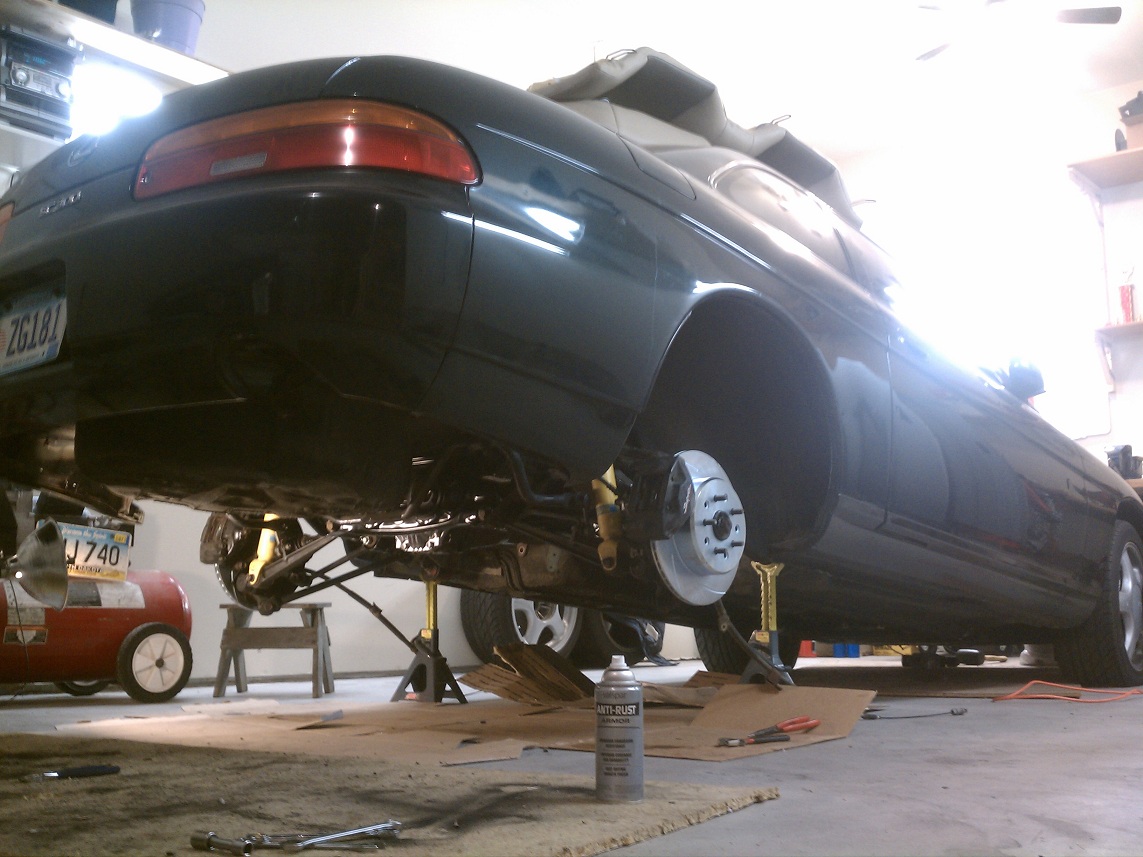

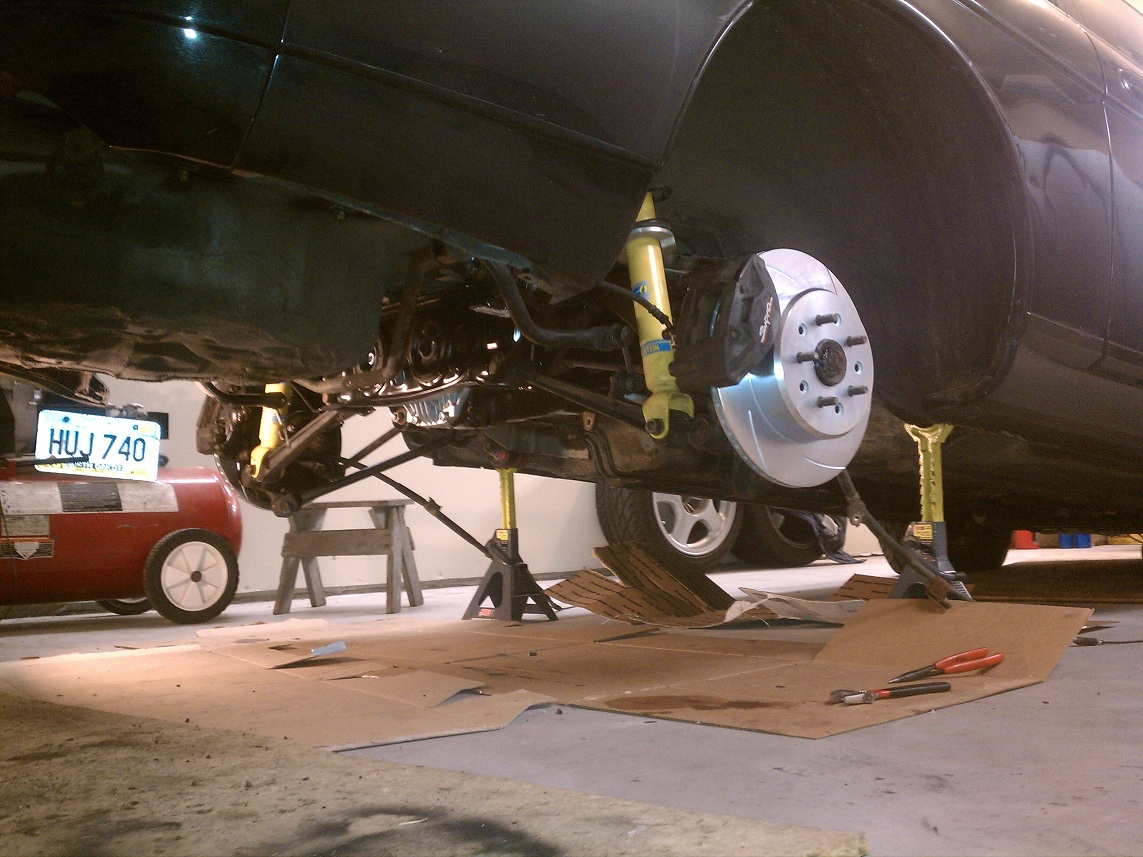

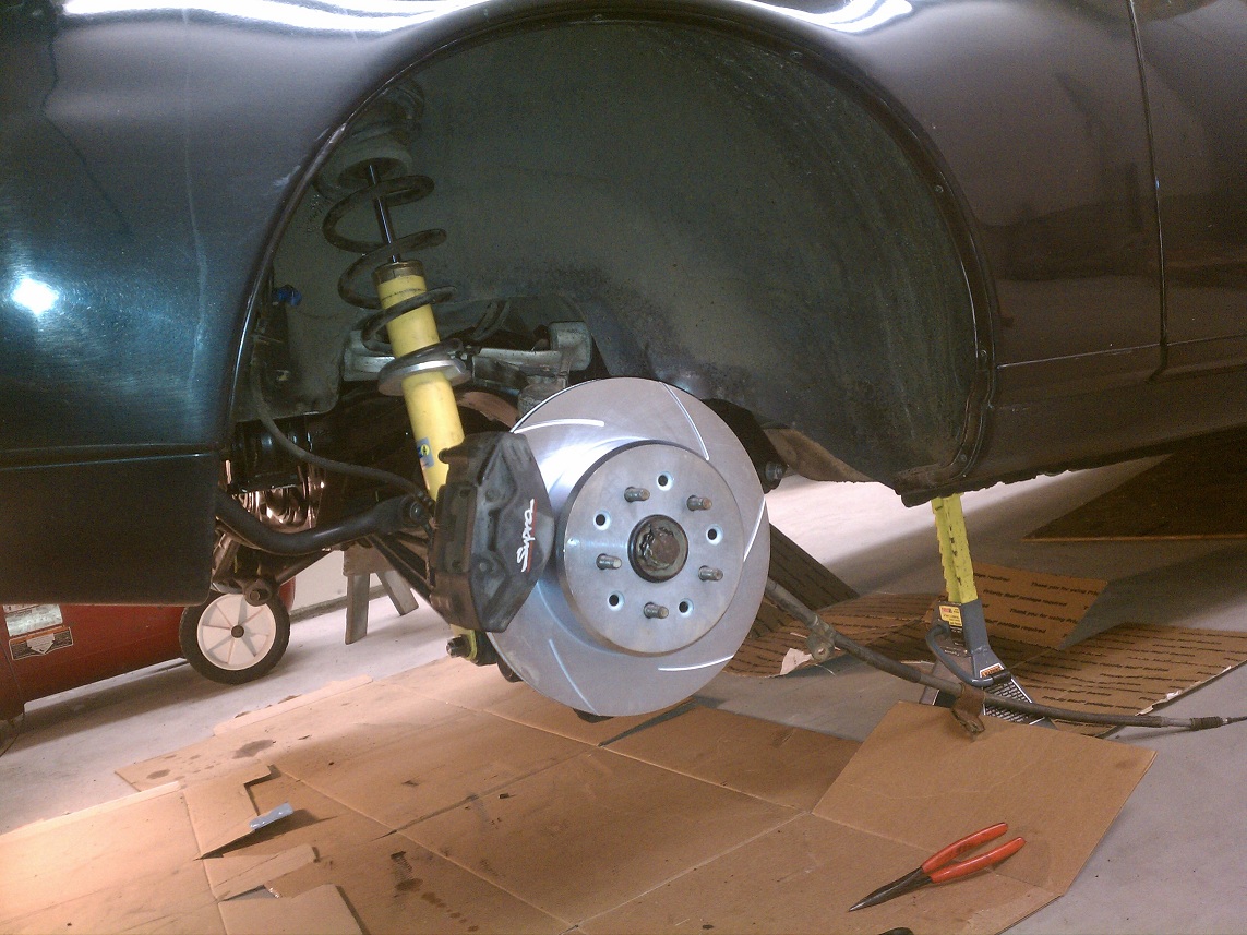

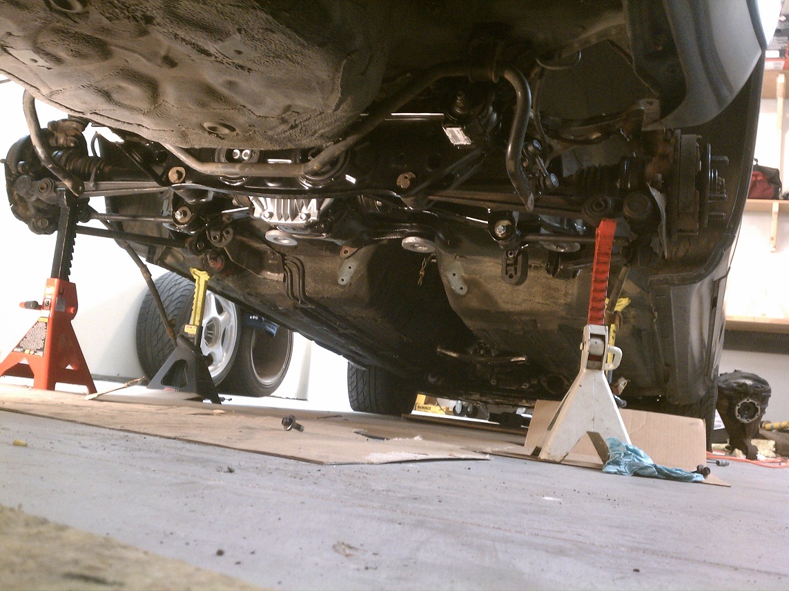

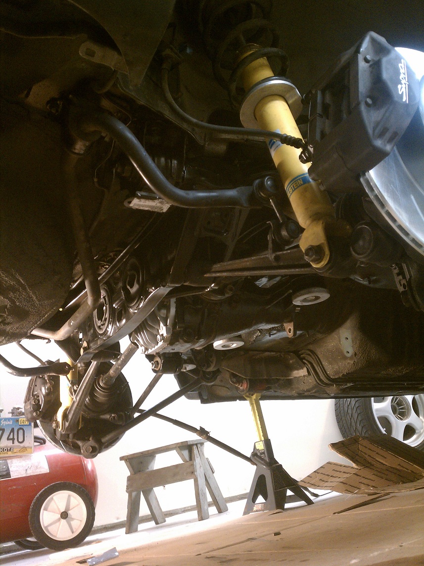

Suspension is on. New rotors are on. Calipers on and bolts are TIGHT (for those who were on the fall cruise haha). Tightened up everything!
My cam cores came in, so I'll be sending them off to get reground tomorrow. The 2 missing bolts for my lower control arm showed up so will install them tomorrow as well. Then basically just need install the driveshaft, bleed the brakes, install exhaust, attach rear wheels, and fire her up and take it for a test drive around the block

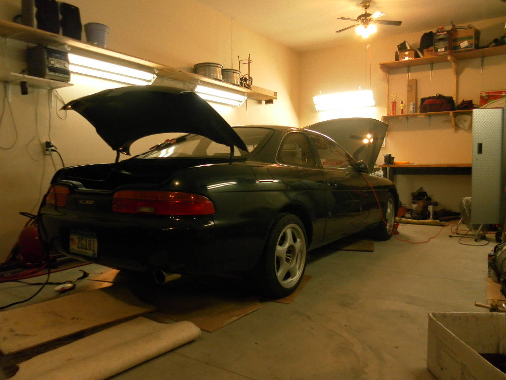

All done!
Will try to start it up tomorrow.
