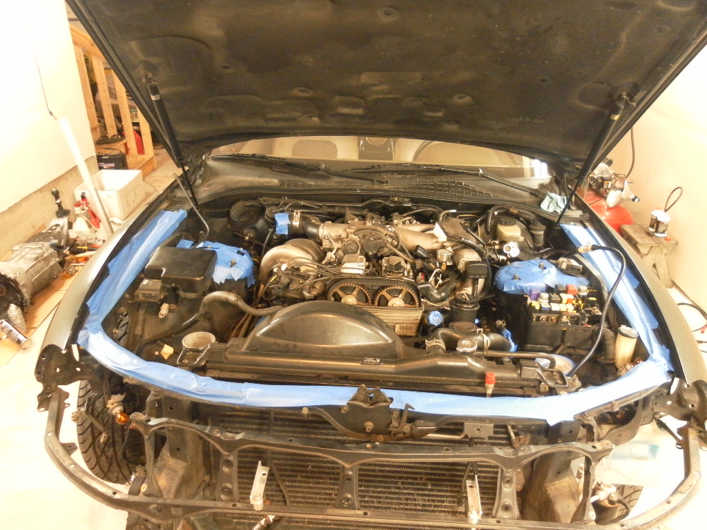

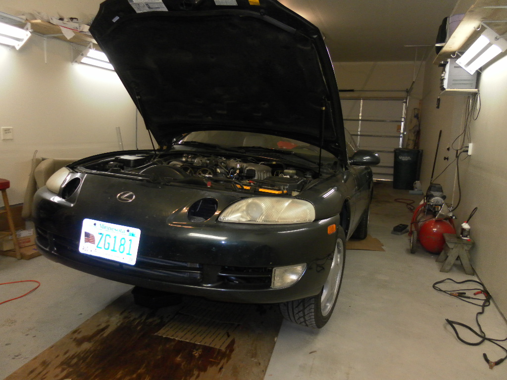

Game on, time to start draining fluids, and get that pig outta the engine bay!
Also, picked up a set of BC valve springs from MAPerformance. Thanks again Chris!

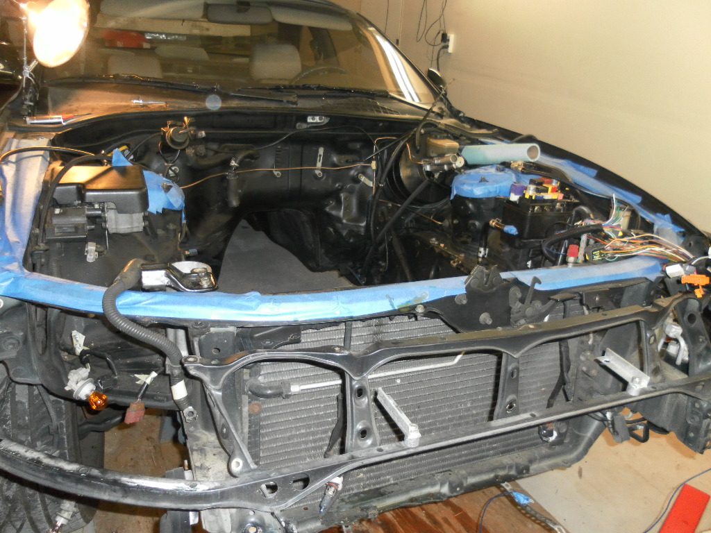

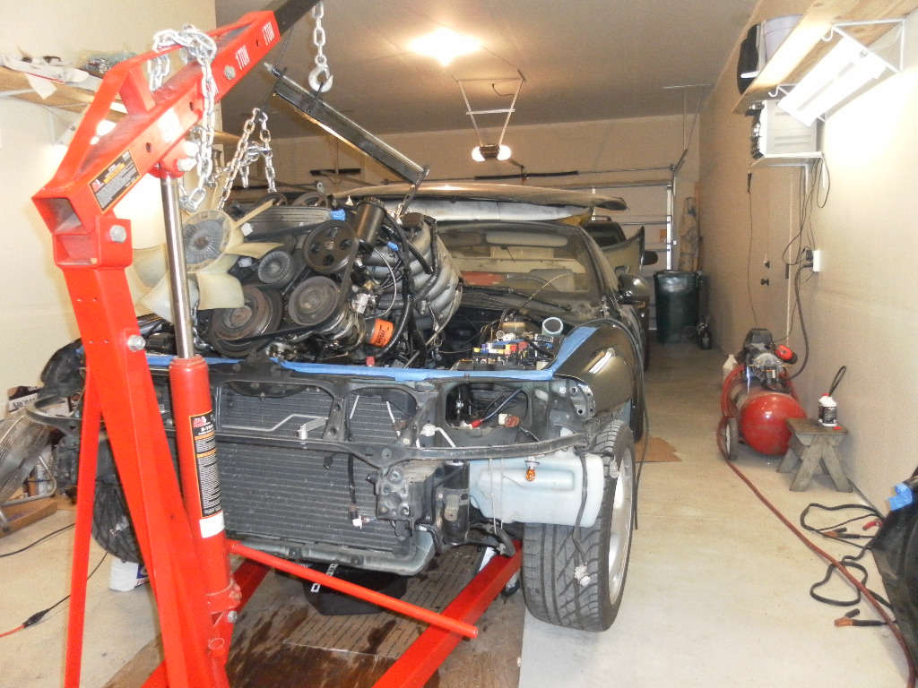

Well got about a 2hr start on it today. Got the oil, coolant, and PS fluid drained. Got the work area taped off since I know it's going to become a tool rack and I'd like to keep the paint as nice as possible. Got the front bumper removed, FMIC and piping removed, bunch of stuff unplugged and labeled. Slowly but surely is the way I work now-a-days Leaving it like this for the night, will hopefully get another couple hour crack at it tomorrow!

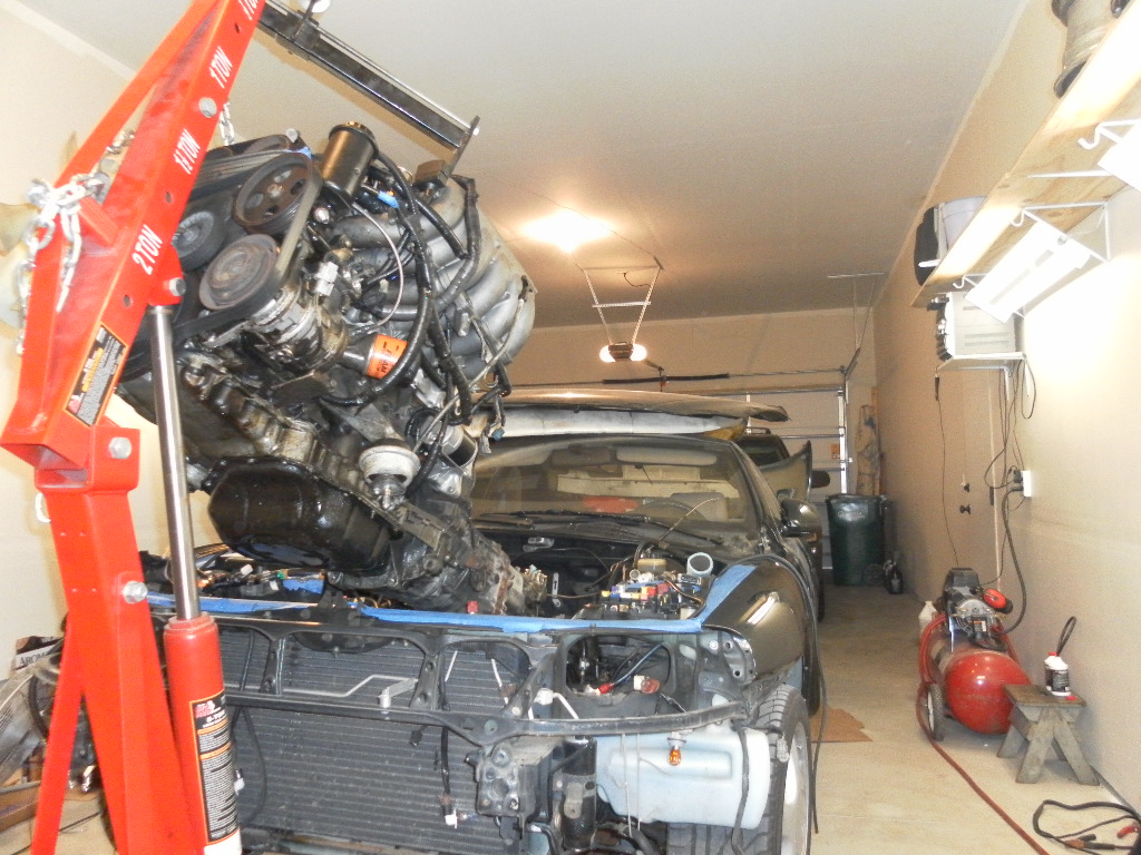

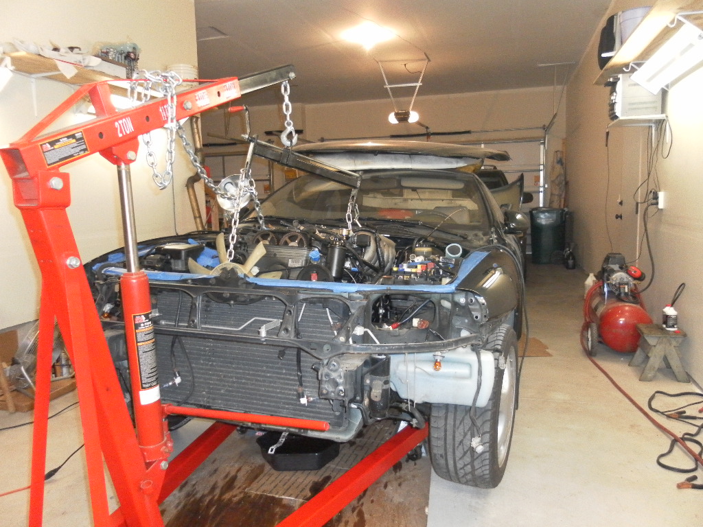

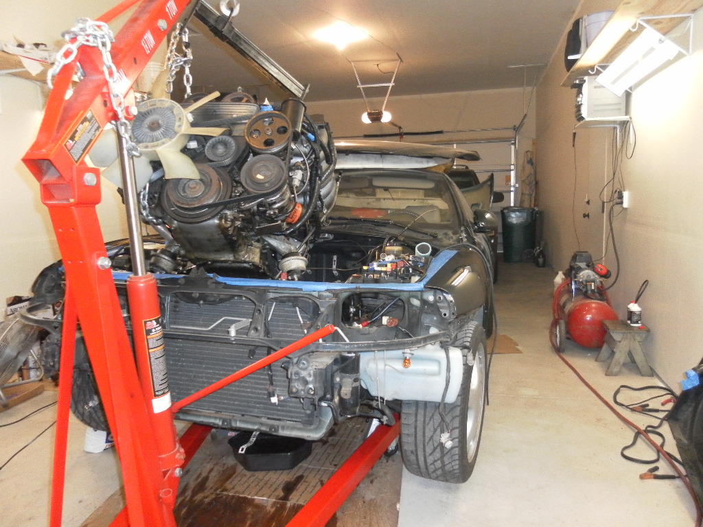

Old 01-01-2013   #759
Re: Project Lex

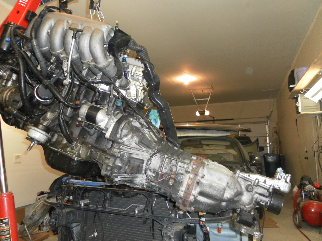

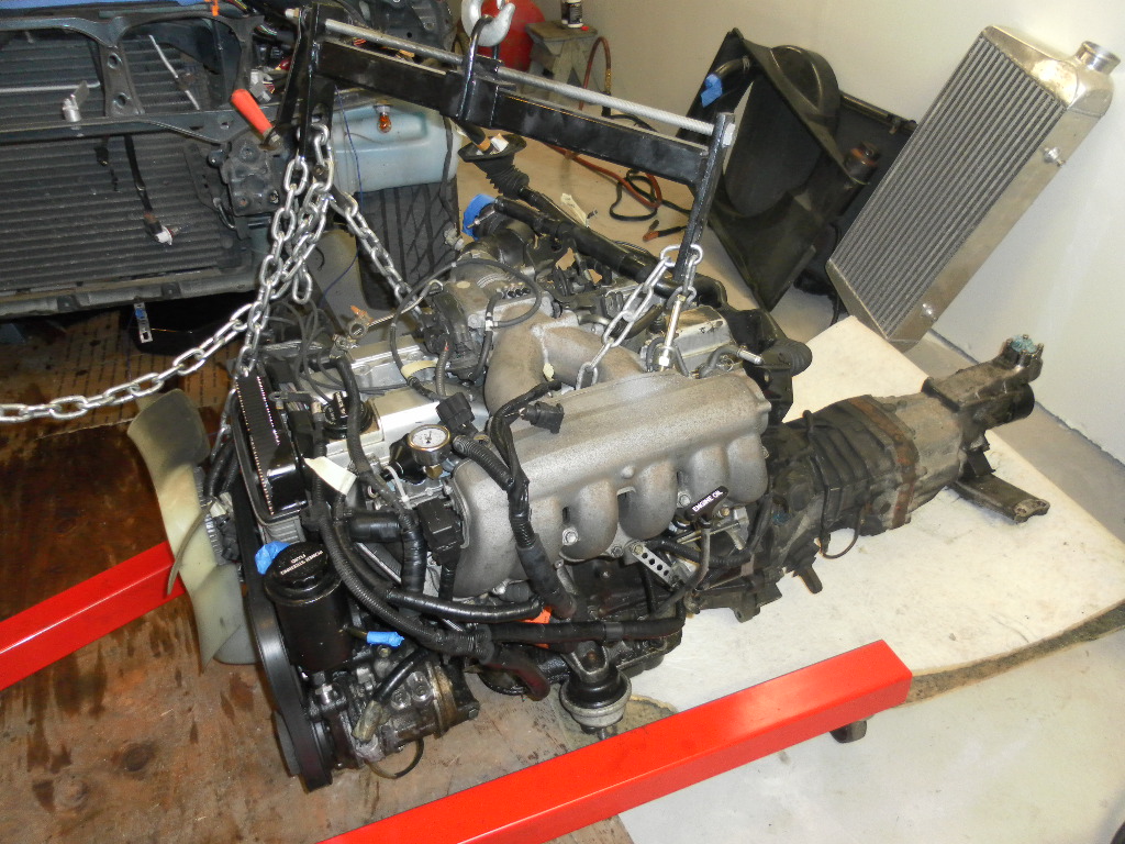

Made a little progress today.
ID:	13223   Click image for larger version
ID:	13224   Click image for larger version
ID:	13226   Click image for larger version
ID:	13227   Click image for larger version
Old 01-01-2013   #760
Re: Project Lex
Nice! Engine out of the car makes it so easy to work on, love this part. Fram oil filter, really?! LOL.
I see a 4x8 sheet of plywood under there, did that work ok with the hoist or did the wheels get caught on it?
